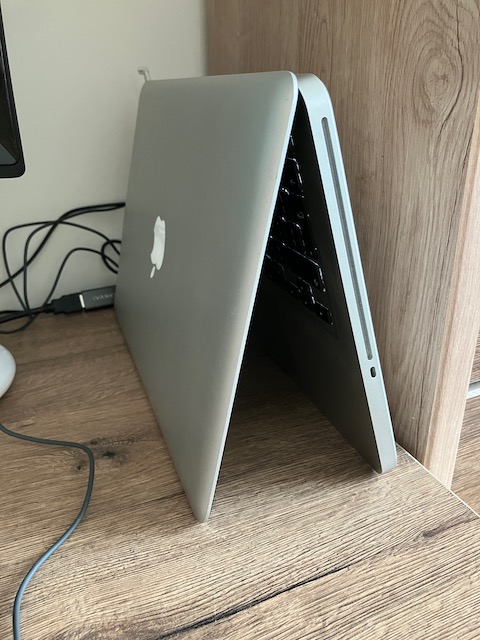

The MacBook display is totally fine. Everything is working perfectly, only this one issue with MiniDP. I have uploaded a Video where you can see that I connect the cable.
The port recognises something, otherwise the picture on the macbook would not briefly go black. But yes, in the meantime I also assume that it is defective. 🙁
