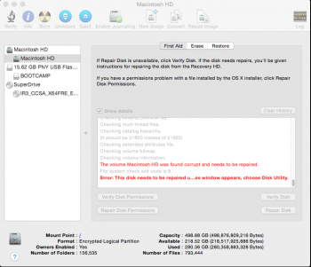

Hello everyone,
Recently, I've been trying to run bootcamp on my 2011 Macbook Pro. While doing this, I never could get a successful partition for windows due to an error. After following steps to verify and repair my Macintosh HD, I keep receiving an error that "The volume Macintosh HD was found to corrupt and needs to be repaired." I've tried booting in Single User mode and Repair mode to no avail to fix this issue. I'm completely illiterate on this side of computers. I'm not sure what the volume is and how to fix it. Am I missing a step or looking at the wrong thing? Any help would be greatly appreciated. I have attached a photo of the error in disk utility.
Turn FileVault off.
Then, try your disk repair again, just to make sure that the disk and file directory are OK.
You should be able to make the Boot Camp partition then.
After you get your Windows system installed, then you could boot back to OS X, and turn File Vault back on - if you prefer the security of having your drive encrypted.

Do a command-r boot to recovery, then launch Disk Utility. Then select the lower Macintosh HD volume there and go to the file menu and select unlock and enter your password. Then try a repair disk run.

Sweet. I just stared to decrypt my files and turn off FileVault. Once that's done I'll try and repair and get the partition done. Will keep everyone updated.
To All Who Find This:
I've fully installed and run windows 8.1! Thank you to everyone who commented and helped. I figured out that FileVault was causing some trouble, and that you are unable to verify and repair a disk when you boot from it. To circumvent this, boot to your recovery partition and then run DU from there. Once again, thank you to everyone who provided tips and words of advice!
