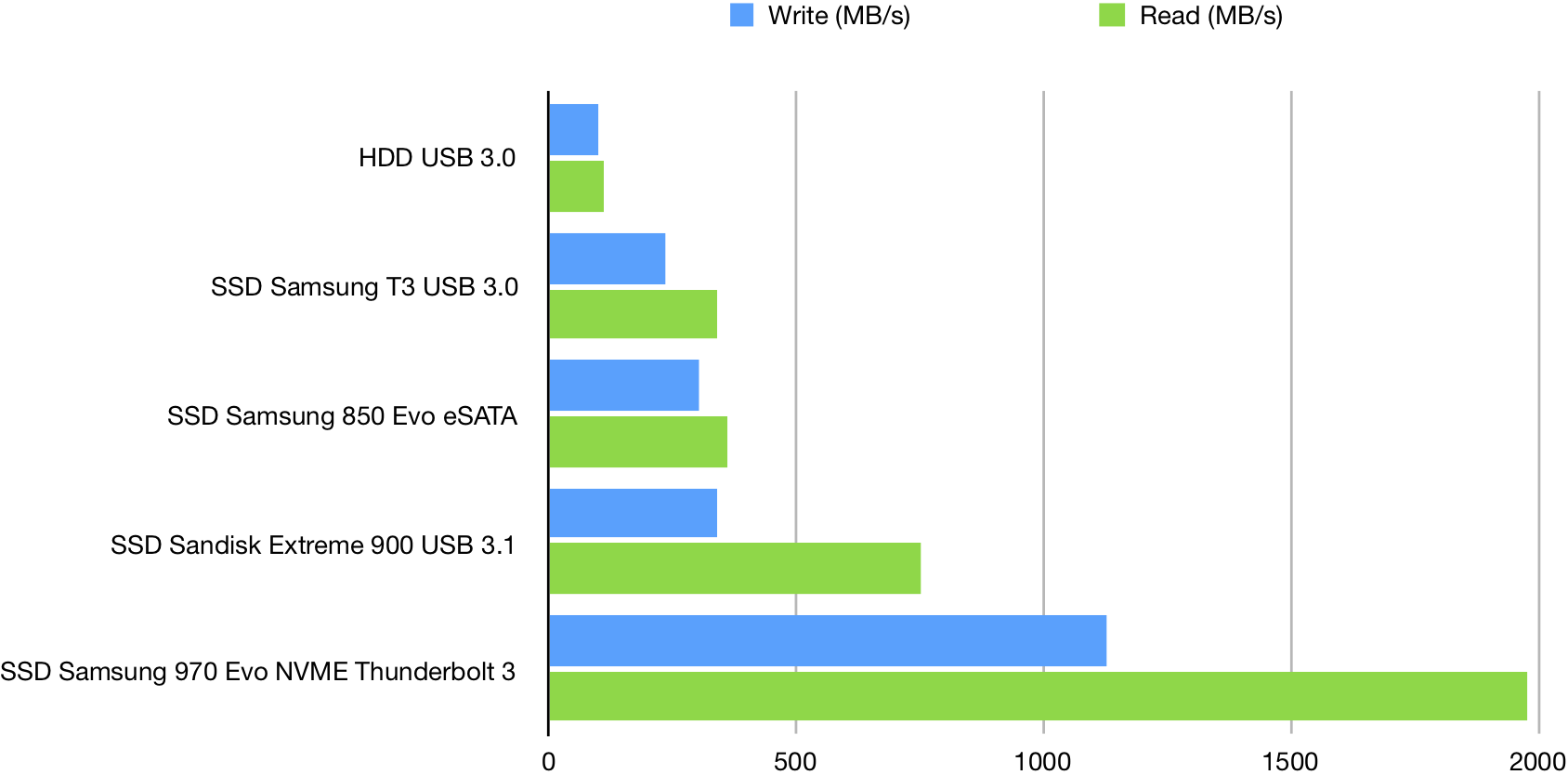

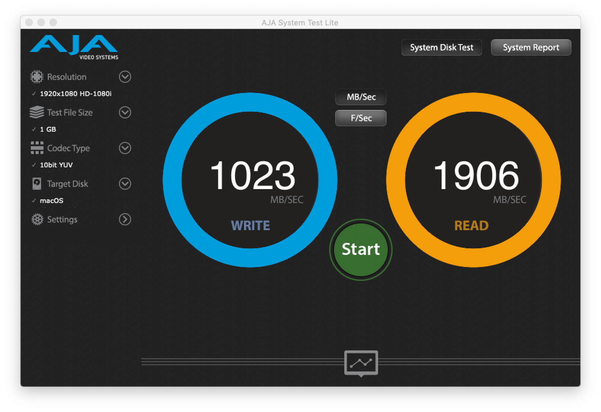

I am using a Samsung EVO 970 2TB NVME in a Sonnet Echo Express Thunderbolt 3 PCIe Enclosure. Using APFS with encryption I am getting the following speeds with my MacBook Pro 2016 NTB i5:
I recommend ordering the 128 GB Mac Mini and investing in this external do it yourself solution. You can compare this speed to my other SSD and hard disk connected to the same computer:
