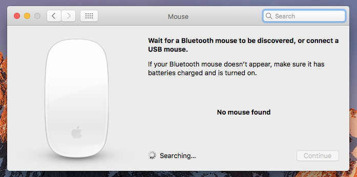

I wanted to change the speed of the mouse, but it stays stuck on searching....
I turned off BT. I unplugged and re-plugged my USB mouse..
Is it because I'm using a microsoft mouse???
