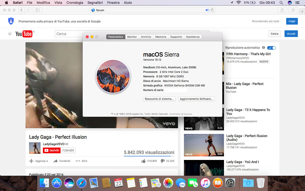

Here we are:

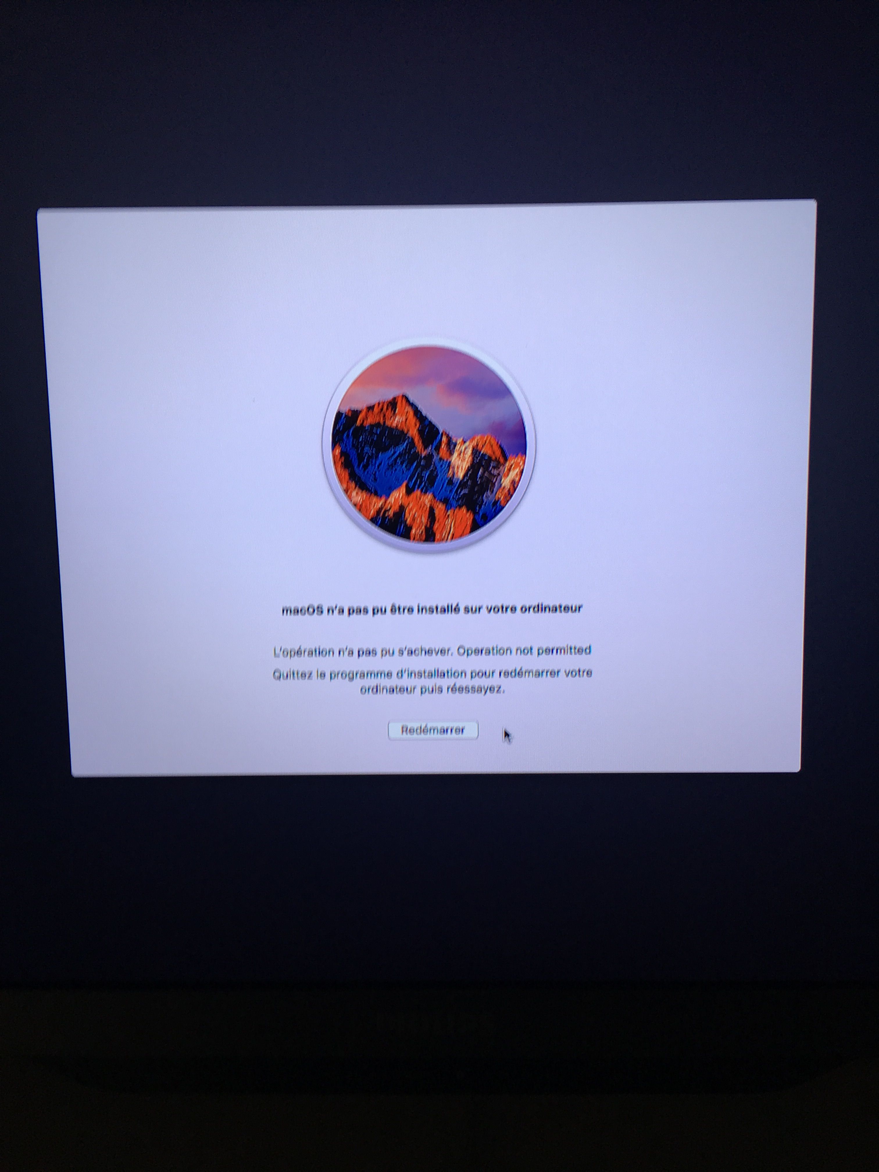

Hi dosdude1, i have a error when i start the installation "operation not permitted "
pmbh2FMgj
What the problem for you ? Thanks for your help
Edit : translation :
the operation could not be completed . Operation not permitted. exit the installer to restart your computer and try again
Edit 2 : on MacBook late 2008 with ssd and 5go ram
That's what happened to me now. MBP 5.3...
