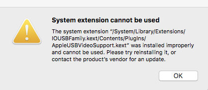

I have the same problem with iSight just showing a black image on a MacBookPro5,3. I observed something interesting though.

At the first time, I don't selected that option, but when in the log screen I realize that keyboard an trackpad were not working, boot it again, go to Post Install and this time selected "force ..". After this, keyboard and trackpad were working perfectly
- did you replace any kexts yourself?
Yes, tried the El Cap AppleUSBVideoSupport.kext from @dosdude1

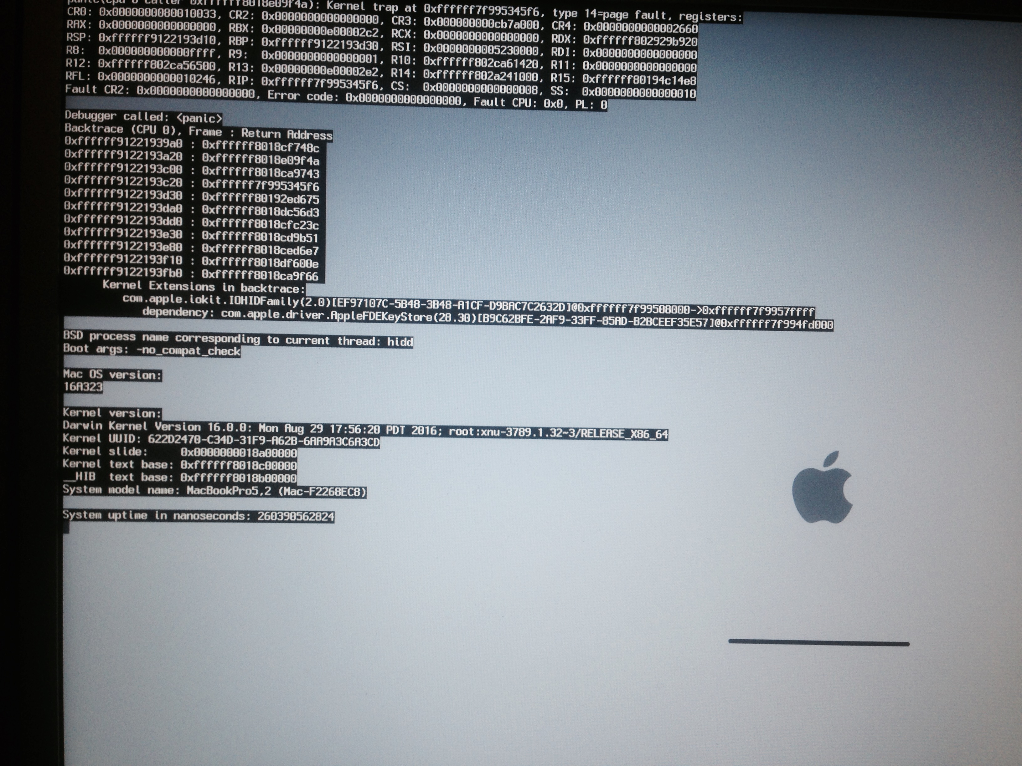

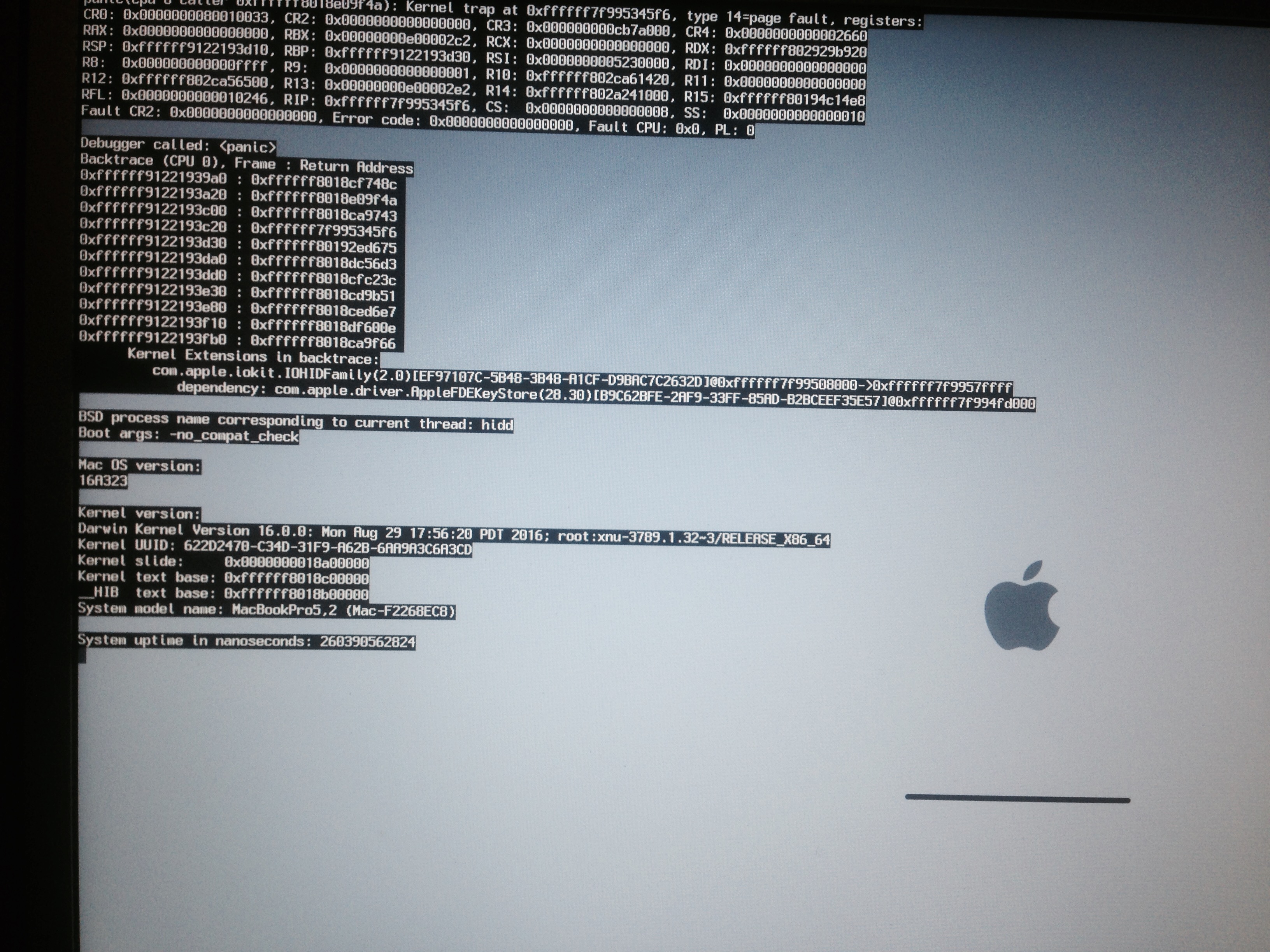

Hi there
I used dosdude1 app to download Sierra and move it to USB stick. I went through the Sierra installation without problems, and applied the patch after that with the option to rebuild caches selected. Maybe that was the mistake a made because my system is not booting up. The progress bar moves very slowly and then I get kernel panic.
Could you please help me? I didn't expect that at all.
Thank you!

@dosdude1 any thoughts on this:
Did you check your boot flags to make sure that unsigned kernel extensions are loaded (Located in /Library/Preferences/SystemConfiguration)? A working example is attached.

Hi there
Thank you!
I'd just try re-installing, and not selecting that option in the post-install tool.
My file just has "-no_compat_check". How can I add the "kext-dev-mode=1 mbasd=1"? This would make iSight works properly?
[doublepost=1474582368][/doublepost]

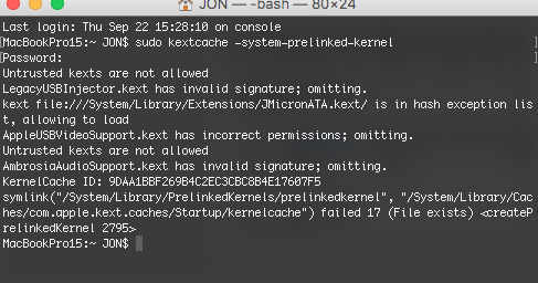

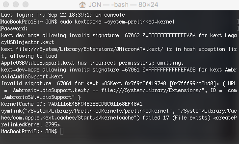

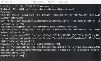

You have SIP enabled. Boot into the Recovery partition or your macOS Sierra Installer USB drive, open Terminal, and run "csrutil disable".
The result after doing "csrutil disable":
You didn't give the kernel extension proper permissions either, you have to assign proper flags (chmod 755) and change the owner to root (chown 0:0)
