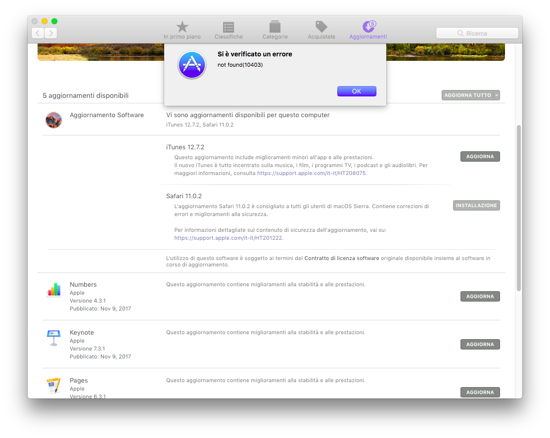

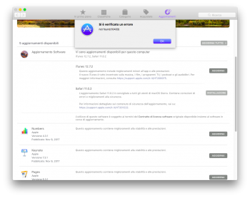

I get this "not found" error while trying to update safari. any suggestion?
Ah, yeah, some of the patches get overwritten during system updates. To re-apply the backlight control patch, you can simply download and run the script found here. There is a Patch Updater/Manager included with High Sierra Patcher, which provides a more automated and easier to use approach to overwritten patches, by allowing you to re-install them.
I had exactly the same issue after installing security update. This script solved it 100%. Thanks, dosdude1
Reactions: dysamoria
Correct. Yes D instead of d, but I just drag the distribution file into the Terminal window.
Good, excellent and great.
You seem to be doing everything correctly, so I am at a bit of a loss as to why that dialogue is coming up.
I am going to download the update again and then go through the procedure again just to make sure.
Will get back to you.
[doublepost=1517336572][/doublepost]O
Ok so I have just downloaded the security update and then gone through the instructions to modify the distribution file. And everything went according to plan, so I can't see why you are getting that dialogue. The only thing that I can only think of is if at some stage you were running a Beta version of macOS Sierra at some point.
It turned out that SIP somehow got re-enabled. That is what was stopping me from getting the update. Everything is up-to-date now. Thanks again!
