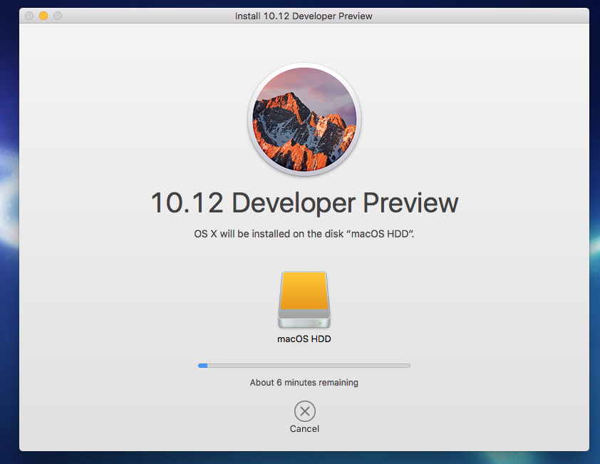

Time to experiment, I guess. It's 2:18 AM EST here and I will start checking out my dummy HD before I take a snooze.
I thought the 9400M was the reason my Late 2009 mini got dropped, but the Late 2009 Macbook has the exact same card...
Maybe it'll be easy to unofficially run sierra on those...
Late 2009 uses DDR3, my Early 2009 uses DDR2 VRAM. That could be it.
But I'm currently working on modifying the installer to run on any Mac that can run 10.11. I can't get it though. But the method to run 10.9 Mavericks on the 2008 white MacBooks should work for all other 10.12 dropped Macs. Only thing with that method, you need access to a mac that natively supports 10.12.

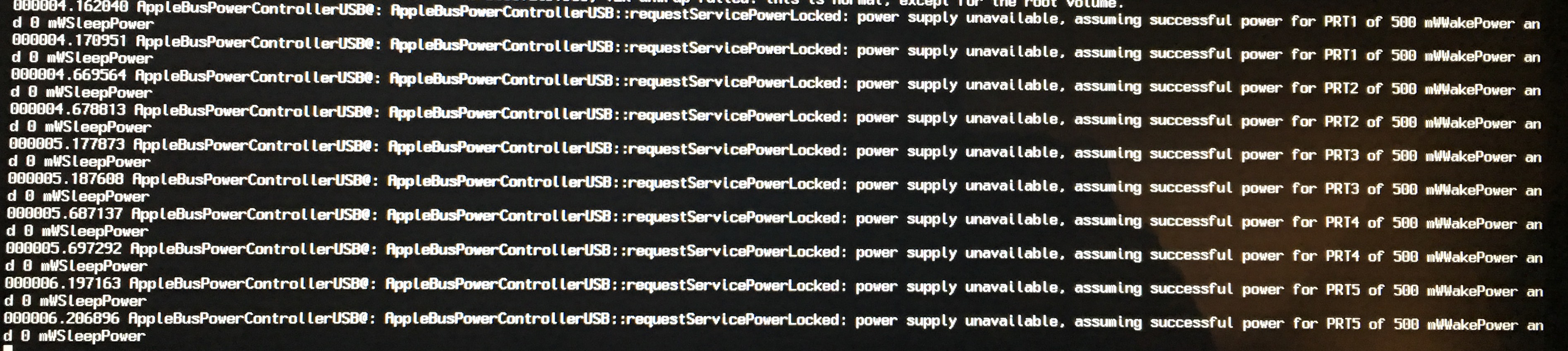

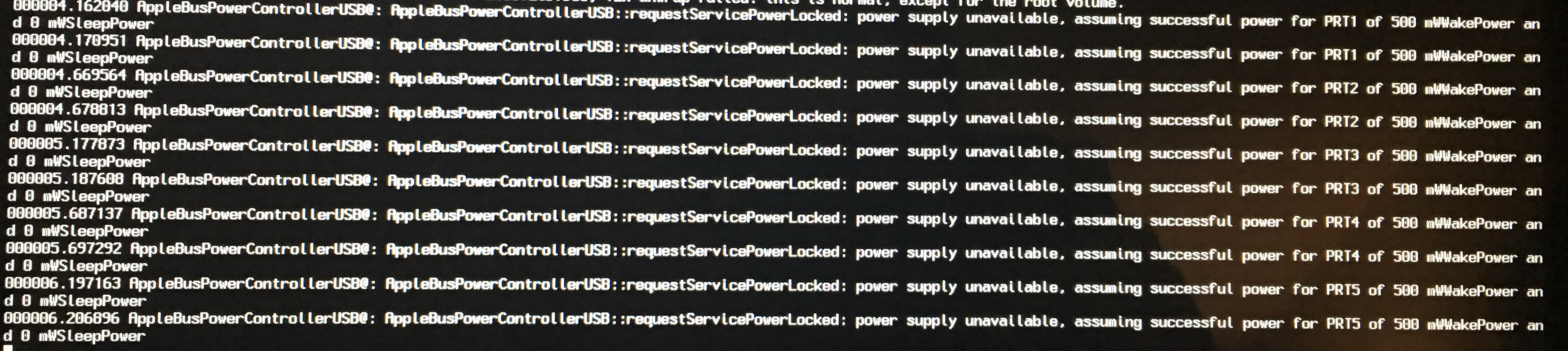

[doublepost=1465877885][/doublepost]Ok hopefully this helps a little bit. I restarted into Verbose mode and the last thing(s) the machine spit out was this:
My Macmini3,1 did exactly the same on USB. It gets further with Firewire but won't load the GUI, even in safe mode.
