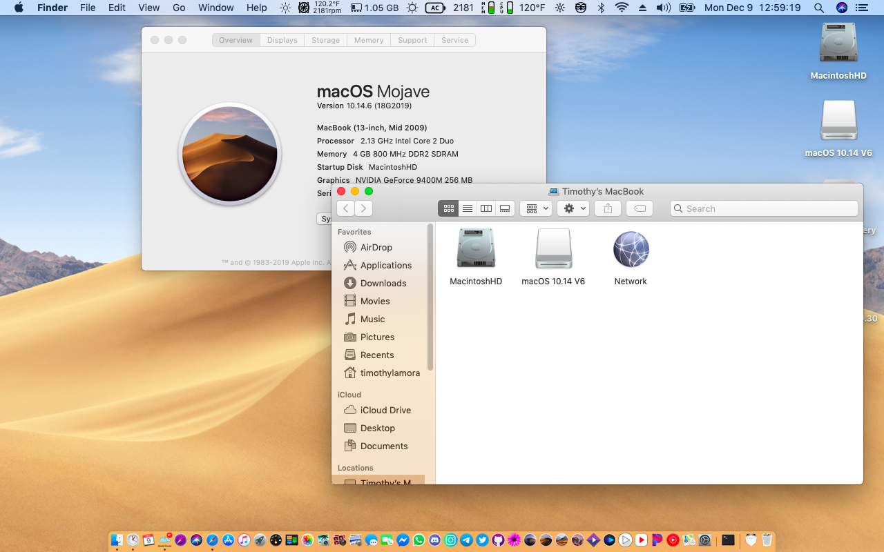

[automerge]1575926624[/automerge]
Installed the new update successfully :)

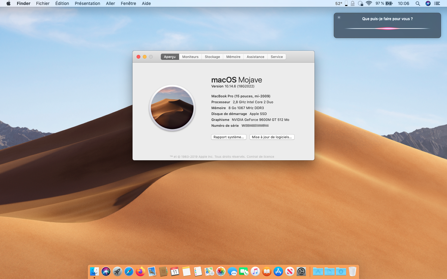

Successfully update MBP5,3 to SecUpd2019-002Mojave (18G2022) reapply Postinstall with Force Cache rebuild.
I needed to reapply Night patch
EDIT:
After the update (18G2022), iSight works, but Siri's waveform is not present.
I fixed by replacing Siri.app (by v146.15.3 of 18G103) in /S/L/CoreServices and SiriUI.Framework in /S/L/PrivateFrameworks (by v146.12.3 of 18G103 patched by dosdue1's Patch Updater.app)
Siri works again with waveform

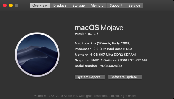

I installed the macOS Security and Safari updates on my 17" Early 2008 MacBook Pro, rebooted into my macOS Mojave Patcher USB updated with the latest macOS Mojave Patcher v 1.3.7, restarted and everything worked great EXCEPT the backlight which kept going almost completely DARK. Tried reinstalling a couple of times but the only FIX was re-installing bkltpatch10.14.2 and restarting.
@dosdude1 wasn't bkltpatch10.14.2 supposed to be included with the current macOS Mojave Patcher?
