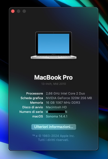

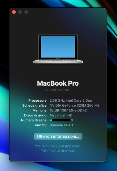

Hello everyone! Finally, armed with courage, I successfully upgraded my 13" MacBook Pro 7,1 (Mid 2010) to Sonoma.
I started out from macOS High Sierra and to install Sonoma I used a USB Key created via OCLP 1.5.0 Nightly .
I REPORT AN ERROR NOT TO MAKE
I created the USB Key with my iMac (14,2 27-inch, late 2013, with Sonoma 14.4.1 & OCLP 1.5.0n) but forgot to select that the Mac to be simulated was the MBP 7.1.
Therefore, at the end of the installation, I recreated the EFIBoot and redid the Post Install Patch from the MBP itself, indicating well that I wanted to create the EFIBoot for the MacBook Pro 7.1
FIRST problem I encountered after the installation was with the WiFi not connecting which, after several attempts, I solved this way:
- I turned off the Mac, turned it back on, and held down the three ALT P R keys, until I heard the Chime sound (Gong!) FOUR TIMES, in order to clear the NVRAM.
- after which, holding down only ALT, I selected the EFIBoot icon to reload OCLP.
- after logging in and rebooting, I disassociated the Network with the automatic connection that was in the list of my WiFi connections
- I connected an Ethernet cable to the Router
- I connected by re-choosing the Network from the list and entering the Password
CAUTION since it is apparently the issue resolving to have, initially, an Ethernet connection although I don't understand why.
PROBLEM
The fans are almost always running.
Can anyone tell me if this is normal?
Mainly it happens if I use Internet connections with updates, downloads, browser use while the fan slows down or seems to turn off while using applications, even heavy ones.
I have equipment like yours, but with C2D 2.4GHz, and I can guarantee you, the best system with a patcher, which works as it should, is macOS Catalina, Google Chrome will have to remove the updates part because the latest version compatible is 116 (non-metal), other than that, dosdude1's patcher makes the AppleTV work as it should, and Apple applications (non-metal) all work.
You can even run Big Sur, Monterey, Ventura and Sonoma on this hardware, it's excellent, but you'll have to live without the aforementioned applications, there are a lot of broken things that no longer work on this hardware. If it's just navigation and Office, it's a device for another 10 years, easily.
About the fans always running and overheating, it is due to the lack of support for the metal API, for example Youtube H.265/60 fps, to resolve this, install the extension Enhancer for Youtube (Google Chrome) and set the settings to use the old H.264 and 30fps.

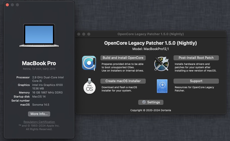

This is my Early 2015 i5 13-inch updated to Sonoma 14.5 (23F5049f) using OCLP 1.5.0n

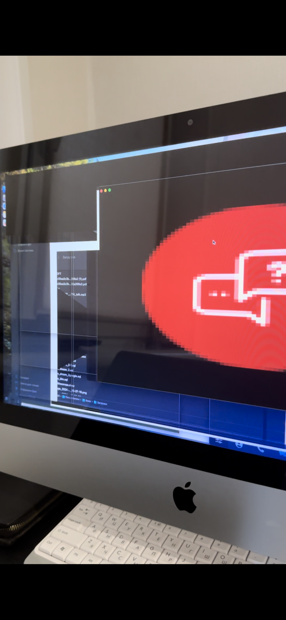

Hello. I have iMac 2012 21’ A1418
I have tried all unsupported operating systems. Monterey is working steadily. There are problems with Ventura and Sonoma - screen flashes and a complete display failure randomly occur. And I'm attaching a screenshot.
What could be the reason, RAM, ssd?

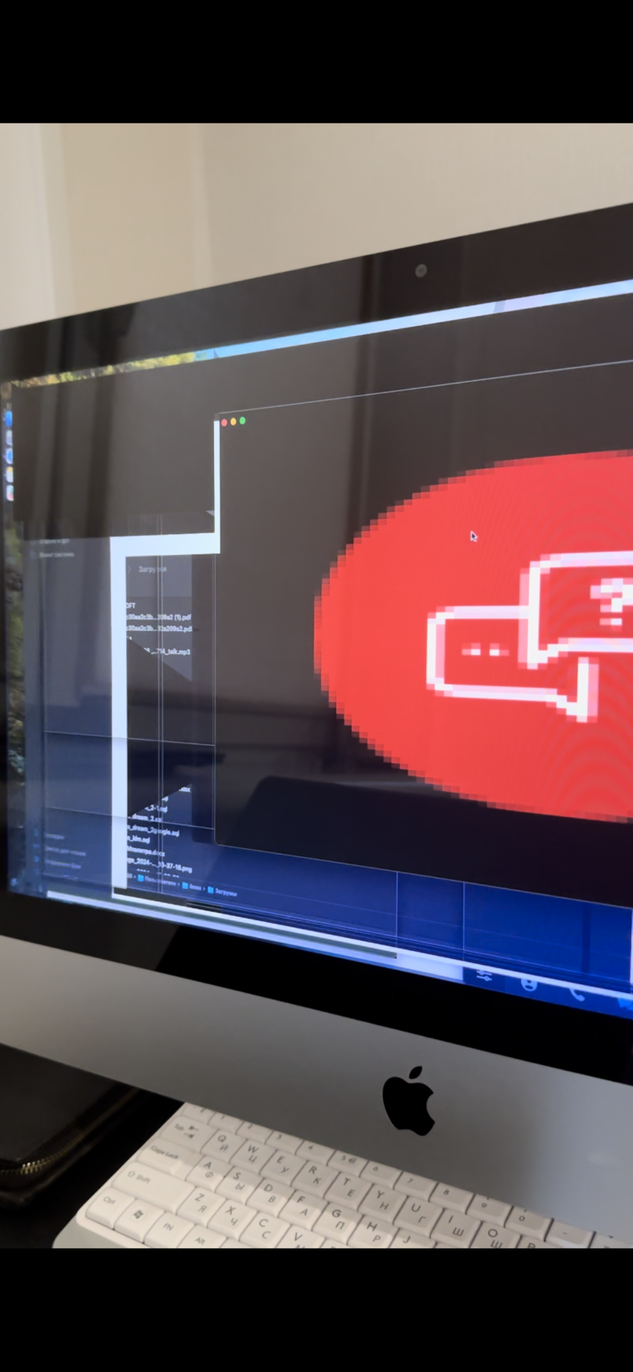

Same issue when booted from USB or in safe mode? Which OCLP did you use to patch?
Reactions: trancerr
By the way, yes, first I took into account the sonoma on an external USB ssd. Everything works fine with it. Now the mac has an ssd via a 7+17 adapter on m2. I worked with him for a long time on Big Sur and Monterey without failures.
OCLP is latest version
Same thing for me, but since I installed OCLP 1.5.0 it hasn't happened anymore
OK strange was worth a try... (May also check the firmware of your device etc., i don't think that it's an oclp related issue)
I confirm that the firmware is up to date… it seems there may be an issue with the current OCLP root patches in this case, as the M6 IS RECOGNIZED until the root patch is applied… I want to be clear that I am extremely grateful to the OCLP developers for ALL of their work… just doing my part to alert them to the issue…
Then may try to file your issue on the OCLP discord channel (esp. when you also tried the 1.5.0n build?).
