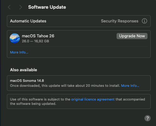

New updates in macOS Sonoma 14.7.7. Was holding the line for the 14.8 update. :cool:

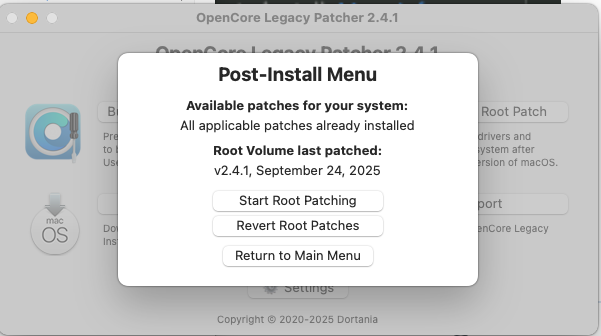

I just wanted to post here, since no one else seems to have, that the 14.7.7 KDK is available, re-apply root patches to install it. I did earlier today, and everything is running smooth.
So far this is the last KDK released for Sonoma, I will install the Sonoma 14.7.7 version to match this KDK

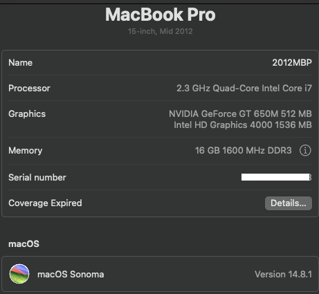

Sonoma on this 2012 MBP 16gb is SOOOO good and STABLE compared to Sequoia. Unfortunate as Sequoia obviously will get updates longer.. It seems it's a tiny bit slower on the 2015 MBA navigating Settings as it only has 8gb RAM, but I'm liking it.

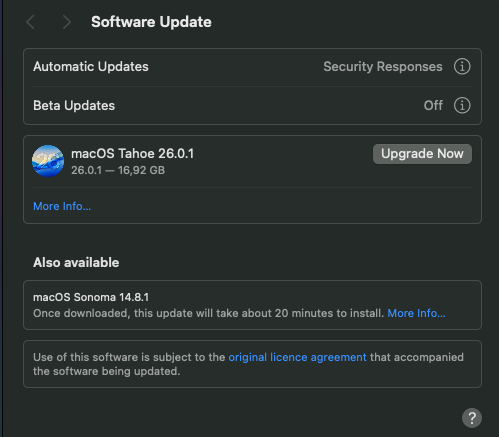

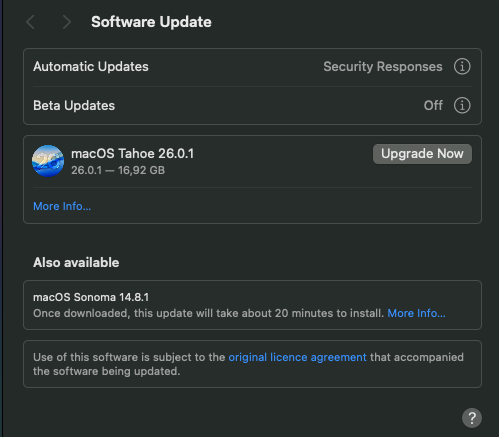

New update macOS Sonoma 14.8.1
Yeah I'm trying to do it now OTA from 14.8....hope this goes ok.. it was being really unresponsive in Settings Software Updates... thought for a bit maybe it was doing the Tahoe update as that button was greyed out like I had clicked it but I know I didn't..Preparing...35 min left. We'll see..
Reactions: m4v3r1ck
The GUI for updates in Settings Software Update is indeed a true PITA due to its unresponsiveness. Glad your update was successful.
Yeah me too.. I just had re-imaged this one too cuz the last update got borked.. Didn't really want to go thru all that again.. I haven't setup Time Machine backup yet for it. Need to get another drive for that.

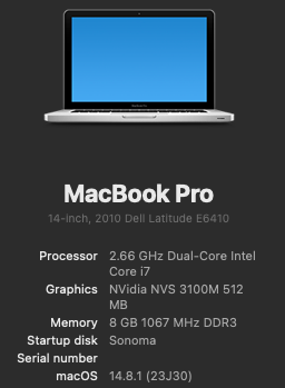

Successfully updated my MBP 9,2 to 14.8.1. Sonoma runs really well on here. Only issue I have is that I can’t access my iCloud storage. I clicked the link in Finder to go to the iCloud page in Settings and the Settings app starts up, but it just takes me to a blank page with my name at the top.
EDIT: Signing out of my Apple ID in the Settings app and then signing back in again solved the issue.
