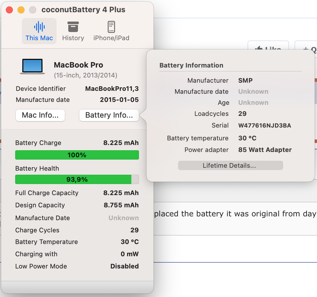

I had a similar issue but not with everything you described until I replaced the battery it was original from day one. , have you changed the battery ? Also it worked fine plugged in .

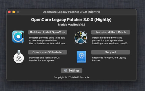

What do the feature settings in OCLP look like?
Download Coconut battery and check for any hints of issues with the battery itself.
Major numbers are targeted for newer OS versions once the move to semantic versioning happened, so yes 3.0 will primarily be for Tahoe whenever it's ready. If there are fixes needed for older macOS versions, they will come as dot updates. After 3.0 has released, all minor fixes for all OS versions will fall under 3.x.x but until then they will be 2.x.x.Hey guys,
Since I haven't seen any real mention of this on the thread, thought I would ask. Is OCLP version 3..0 coming out even if Tahoe isn't ready, or are they waiting until it's ready to release 3.0. Just wondering if it's going to contain any improvements / fixes to known working versions of macOS as well.

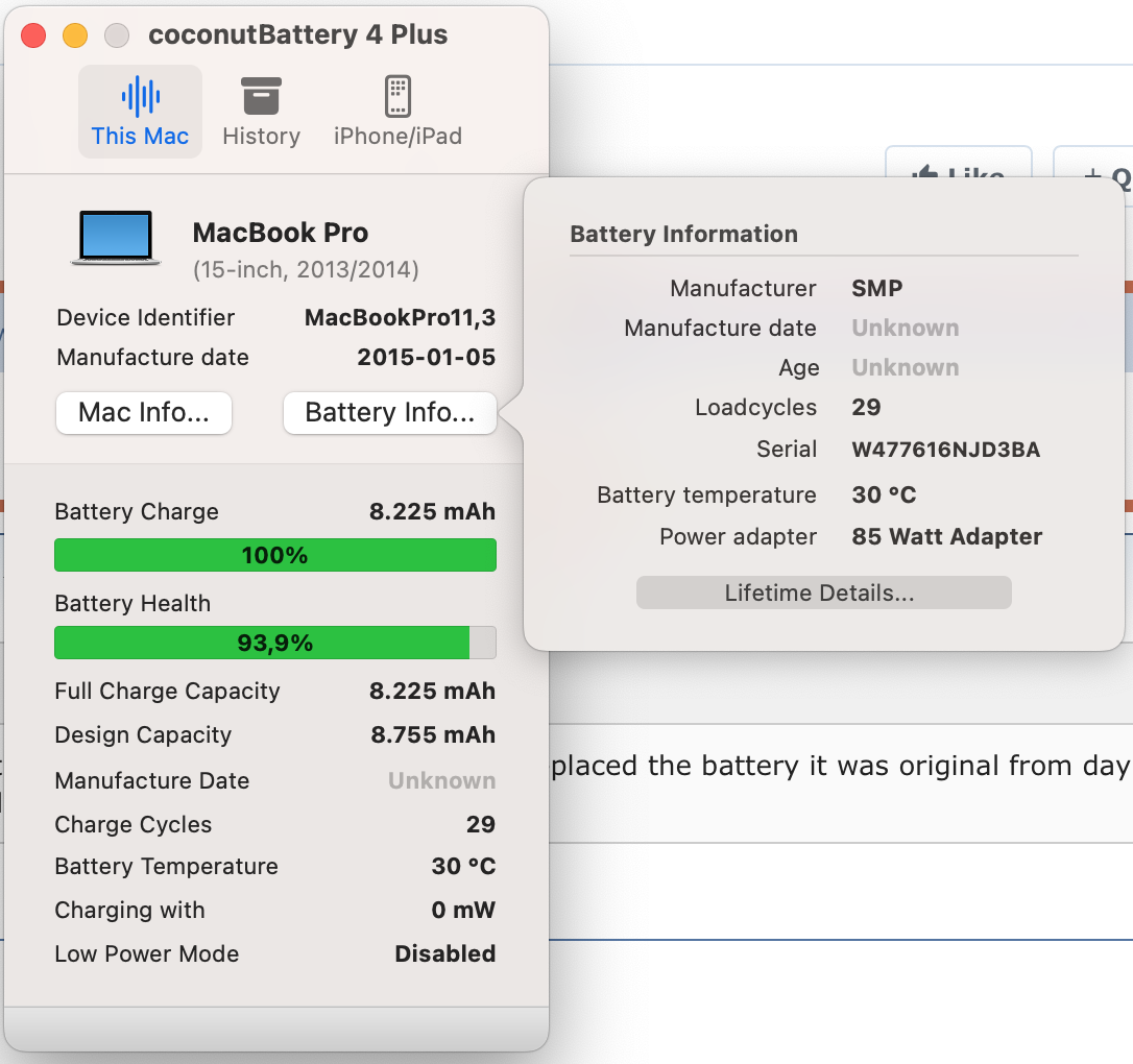

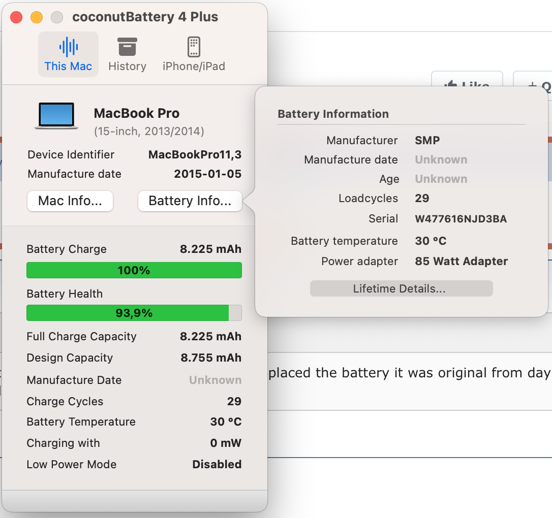

Battery is few months old (I think it's not genuine btw). I had the same issue with the original old battery. It's weird that battery health shows 93% with 29 battery cycles. Yuck.

Thank you, that is what I thought. I was mainly curious because it sounds like this time around it's unclear if Tahoe will actually work or not. With that said, I was curious if updates were just going to continue regardless. So it sounds like, if Tahoe doesn't come out the patcher will stay at the 2x line.Major numbers are targeted for newer OS versions once the move to semantic versioning happened, so yes 3.0 will primarily be for Tahoe whenever it's ready. If there are fixes needed for older macOS versions, they will come as dot updates. After 3.0 has released, all minor fixes for all OS versions will fall under 3.x.x but until then they will be 2.x.x.
OCLP 1.0 was the first for Sonoma, 2.0 was the first for Sequoia.
