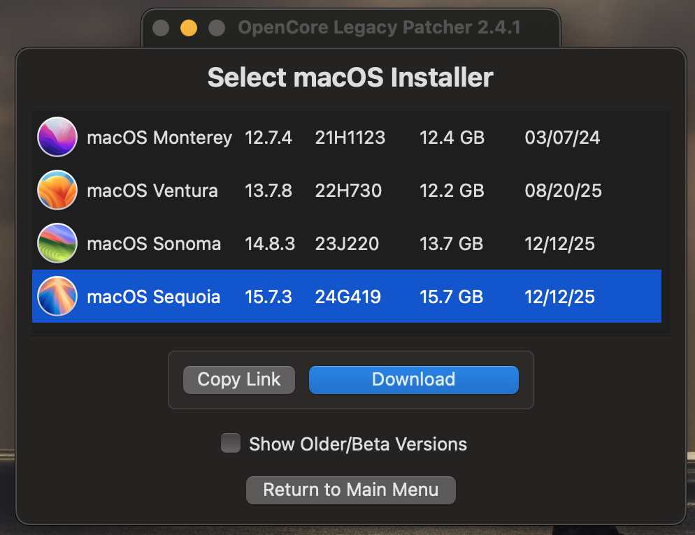

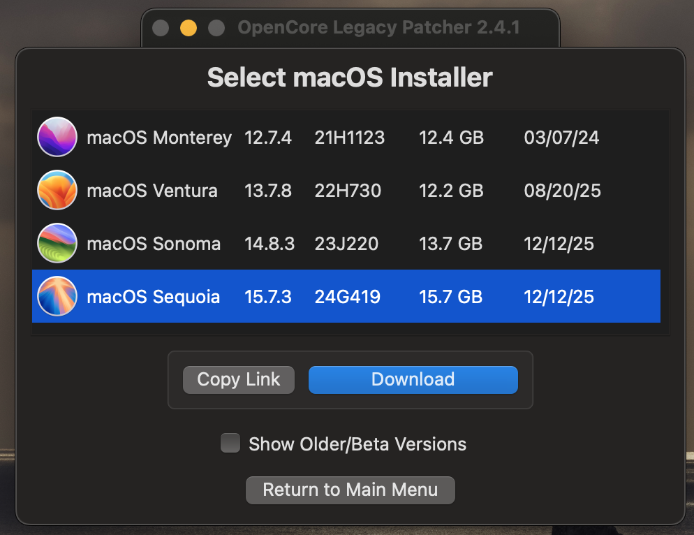

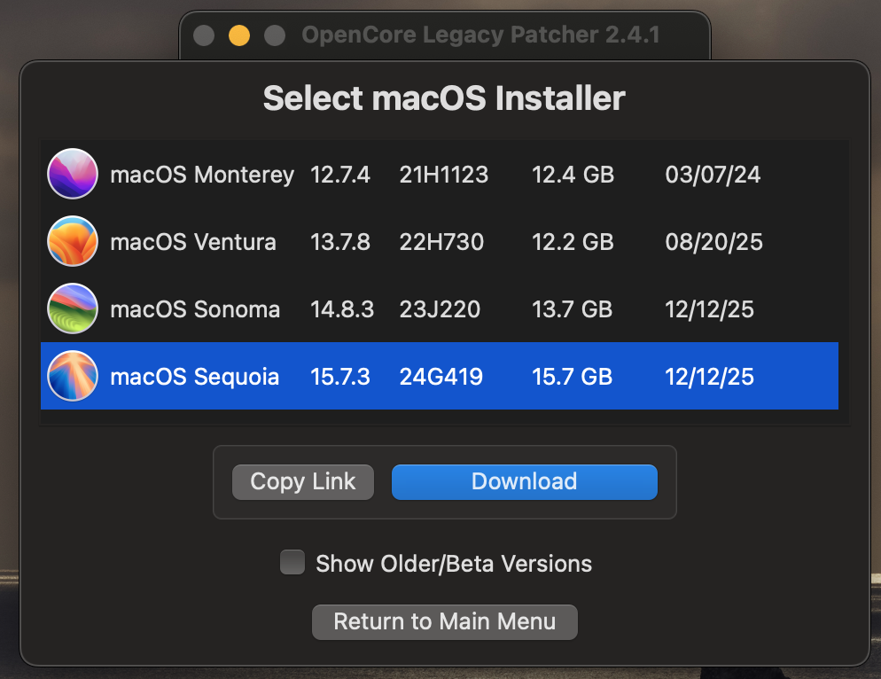

I noticed OCLP no longer offers Sequoia as an installer.
Are you using v2.4.1? I am on Sonoma 14.8.3 w/ OCLP 2.4.1 and I see Sequoia.
I am using v2.4.1. However, I upgraded to 15.7.3 OTA. It didn’t show as an installer on my machine.

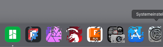

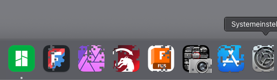

two computers running sequoia with OCLP:
1. MacBookPro 2015, 15.7.3 with OCLP 2.4.1 - flawless
2. iMac 13,1 from 2012, upgraded to 16GB RAM and a i7 3770-S CPU. All is running well except the graphic artifacts. I don't think it's the GPU but the version of Sequoia, 15.7.4 DP with OCLP 2.5.0 Nightly. But it was all the same with 15.7.3 and OCLP 2.4.1
Please see attached picture.
Do you know a fix?

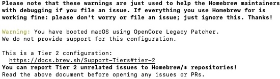

I just discovered that the OCLP 2.5.0 nightly seems to have fixed this well-known Swift runtime error:
… with now a potential fix here (but obviously not necessary, if it now works in 2.5.0):
… and finally with only this generic warning now present in brew doctor:
Very good…
Do you know a fix?
Have you reset NVRAM? 🙌
Do you see graphic artifacts when booting supported version of macOS? Perhaps the GPU itself is beginning to fail.
