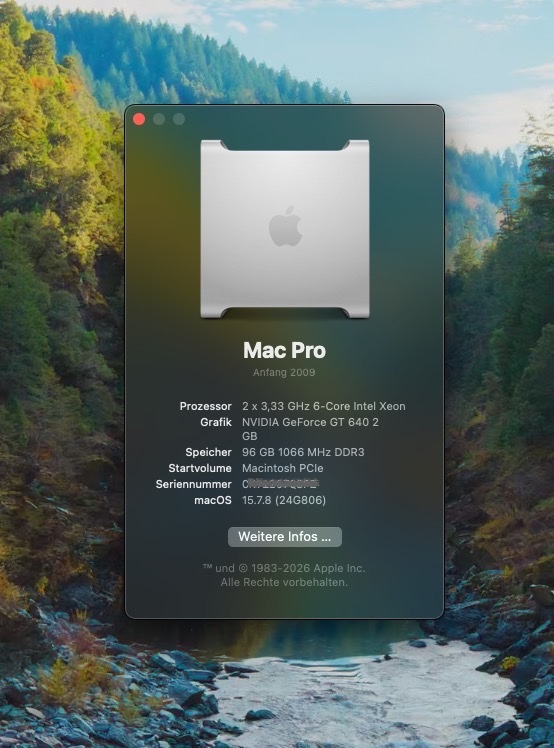

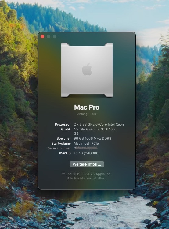

cMP 4,1 (-> 5,1) working well with 15.7.8 b1 and patches for Nvidia Kepler and BT/Wifi (I still have to use 2.3.1 instead of 2.4.0 due to issues with external USB cameras not showing any video with the newer patch set).
Still happy to work with this "power machine" as a daily driver for work. (No, deeveedee, pls. don´t 🙂

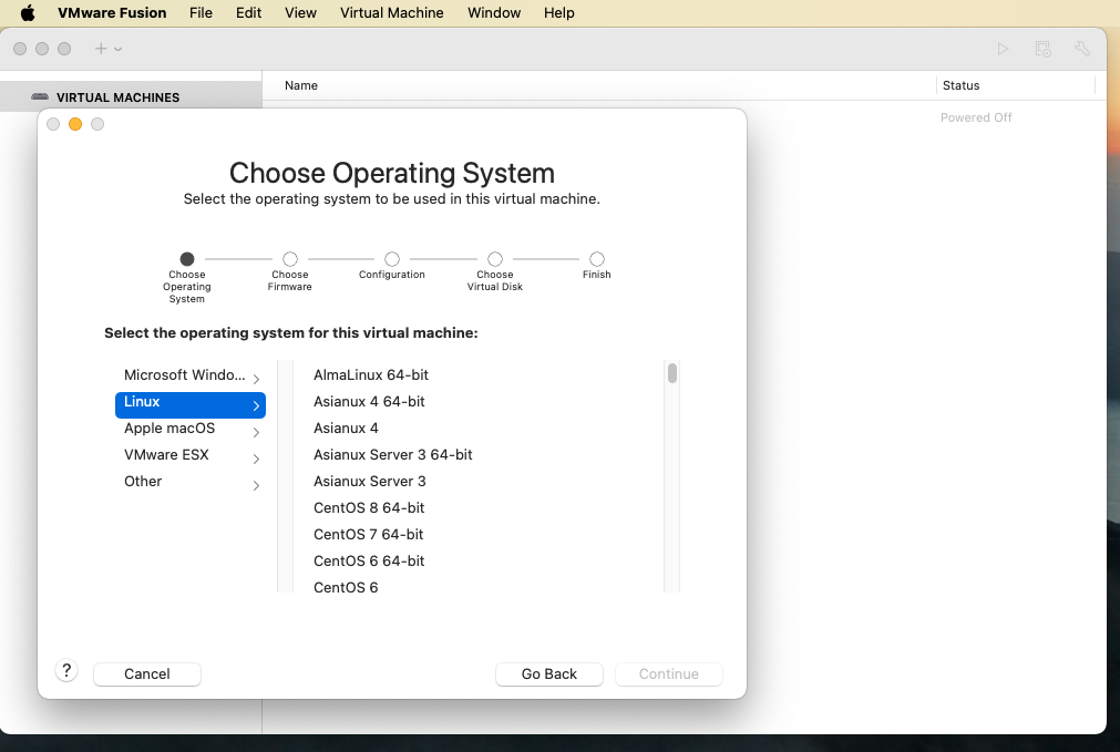

I want to use VMWare to make and run Linux instances on my 2012 MacPro. that macpro already runs Sequoia. /Sequoia/Open Core Legacy Patcher. I was thinking I can just install vmware on my 2012 macPro and start creatng linux instances.
But now, when I read more closely, what I see is Sequoia can run on a mac under vmare. I don't see any mentiom of running Linux under Sequoia with vmware. I can run linux on sequoia but only with Parallels.
This is what I am reading:
VMware Fusion 13.6 and later versions support running macOS 15 Sequoia as a guest VM on Intel Macs, provided the host Mac supports Sequoia natively. For unsupported Intel Macs (e.g., 2015 MacBook Pro limited to macOS Monterey), you can run a Sequoia VM by using OpenCore Legacy Patcher to create a standalone macOS Sequoia installer, then using VMware Fusion Pro 13.5.2 (the last version compatible with macOS Monterey) to install it via a created .dmg or .iso file. "
Reactions: TimothyR734

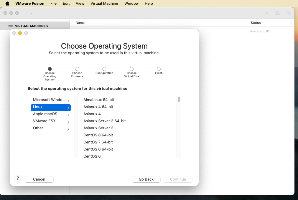

VMWare Fusion running in Sequoia. I have option to create Linux VMs

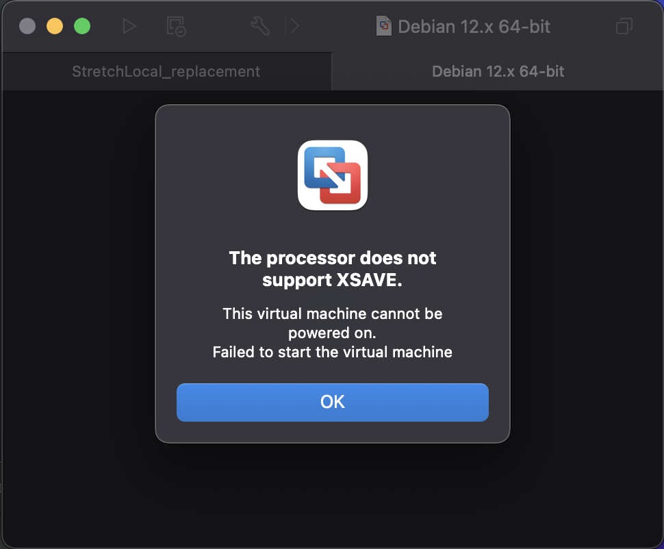

Did you run the VMware Fusion of the screenshot above with a MacPro5,1?
Since macOS Big Sur release, VMware Fusion Hypervisor started to require the XSAVE instruction that is not present with the Nehalem/Westmere Xeons and the last VMware Fusion that works with a MacPro5,1 is the 12.1 version back in Catalina.
Yeah.. doh! It launched VMWare but starting the VM bombs w/ the XSAVE not supported message. Man, has it really been before I installed OCLP Sequoia on my 5,1 that I've run a VMWare VM? I guess so, since I mostly use my 2018 Mac mini for VM's. 😳 Sorry for the bad intel.
that is what I thought and have been running into. Thank you for leading a correction of the well-intentioned, but unfortunately, false story here. I was experiencing a glorious hope while it lasted. Thank you for asking the critical question that exposed the confusion that was the leading the wrong way.
You deserve credit for doing your best to lead to a promised land. And owning up to the error in your report when it was clarified by perfect question from the Great Dude of DOS is a good move. Thank you for your great contribution. I am sure you provide many solutions without the unfortunate complication this one has. Owning up proves you are awesome and not a dirt bag. Sometimes, that is the best any of us can do.

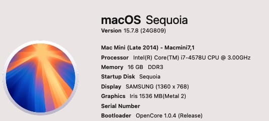

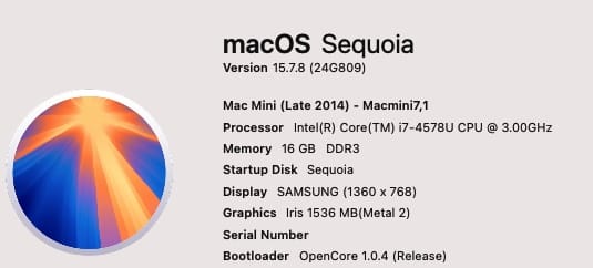

Have a question if I may.
I get the usual update notification, this time for Sequoia, 15.7.8.
But I'm already on that version ?, and clearly it's a full installer?
Relax, it is most likely another RC (Release Candidate) with a small increased build number. The version you have must be RC 1, and that prompt is probably RC 2. Using OCLP you always get full installers. 😁
