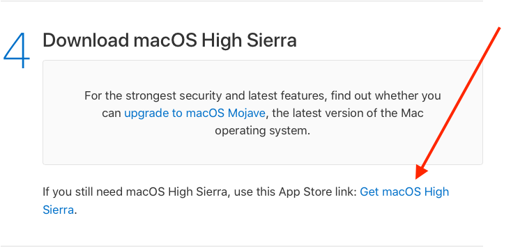

Is it possible to get the High Sierra installer from somewhere other than the patch tool? I never installed it previously, and it's not available to me in the App Store.
If you have a supported Mac, you can still get High Sierra from Apple:
Apple Support: How to upgrade to macOS High Sierra
