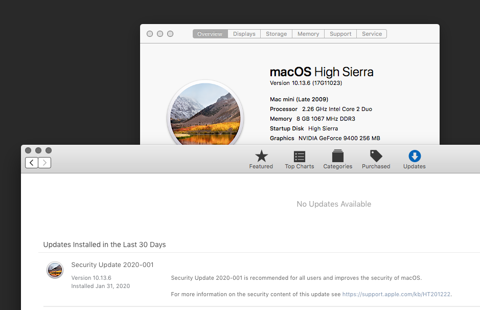

I just did the update on my 3,1 Mac mini, and it went perfectly. I didn't even need to do post-install again. In my experiences on this machine, the updates work much better, and this time perfectly, if you use APFS.

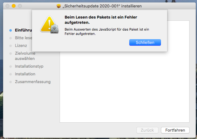

This refers to a MacBook 5,1 (Unibody, late-2008) and applying Security Update 2020-001.
I tried to modify the update package "SecUpd2020-001HighSierra.pkg" as downloaded from Apple (using the apple.com / Support / Downloads section on their websites) and as described in Post #1 of this thread (post #1) as to section 'Security And OS Standalone Updates'.
Even added this addition, so that the volume check is not performed:
function VolumeCheck(prefix) {
to
function VolumeCheck(prefix) {return true;
but - that did not help, I always get a result (see picture), complaining that some readout for JavaScript resulted in an error :-(
Thus, in the end I booted with DosDudes patcher, applied the patches fresh (just to be safe; also did select "Force Cache Rebuild"), then restarted and went with the update as available from the AppStore.
That did go through the first restart round, the second restart never progressed (while it does on supported machines), I thus shutdown the MacBook5,1 forcefully after some time, and the next restart showed it is on version 10.13.6 (17G11023).
Hoping everything is fine now ...

Sorry, but in the instructions/WiKiPost in the first post for 10.14 I don't see a section on how to deal with "Security And OS Standalone Updates" - that is present for 10.13.
So: What is missing in the instructions for 10.13 ?
Download the update.
Open the update.
Move the update.pkg to Desktop.
Open Terminal.
Enter "pkgutil --expand " now AFTER THE SPACE drag and drop the .pkg from the Desktop into the Terminal window and type after ANOTHER SPACE " ~/Desktop/Expanded" hit Return and wait, this takes a little while.
Quotes are not needed.
Open Expanded folder and then open Distribution file in Text Edit
Scroll down to the line
function InstallationCheck(prefix) {
enter the text return true; so it looks like this
function InstallationCheck(prefix) {return true;
Save changes
If you are trying to install the update to an HFS+ disk then there is another alteration you can make, before flattening and creating the package.
Again in the Distribution file scroll down to
again enter return true; after the bracket, so it looks like this,
Save changes
Go back to Terminal enter "pkgutil --flatten ~/Desktop/Expanded ~/Desktop/Modified.pkg"
Using the .pkg extension is crucial.
One thing to note is if your Mac like mine has different OS's on it on other drives this method will tell you that all drives are able to install the update, DO NOT INSTALL ON ANY DISK/ PARTITION, ONLY INSTALL TO A DISK/ PARTITION THAT HAS 10.13.X ON IT. Select your disk wisely, and double check."

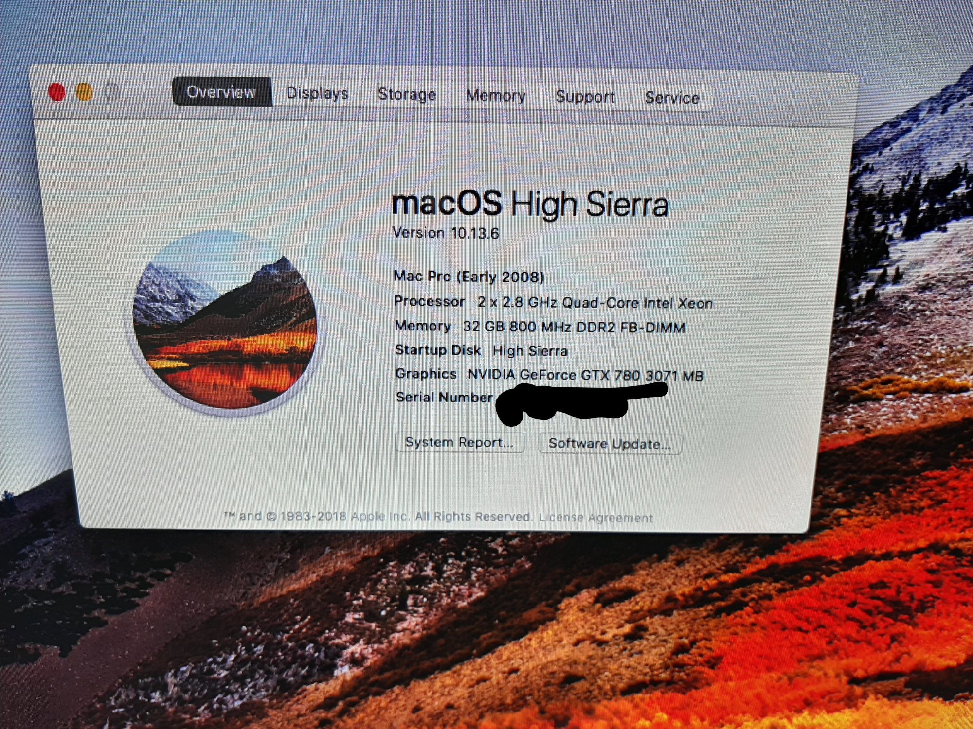

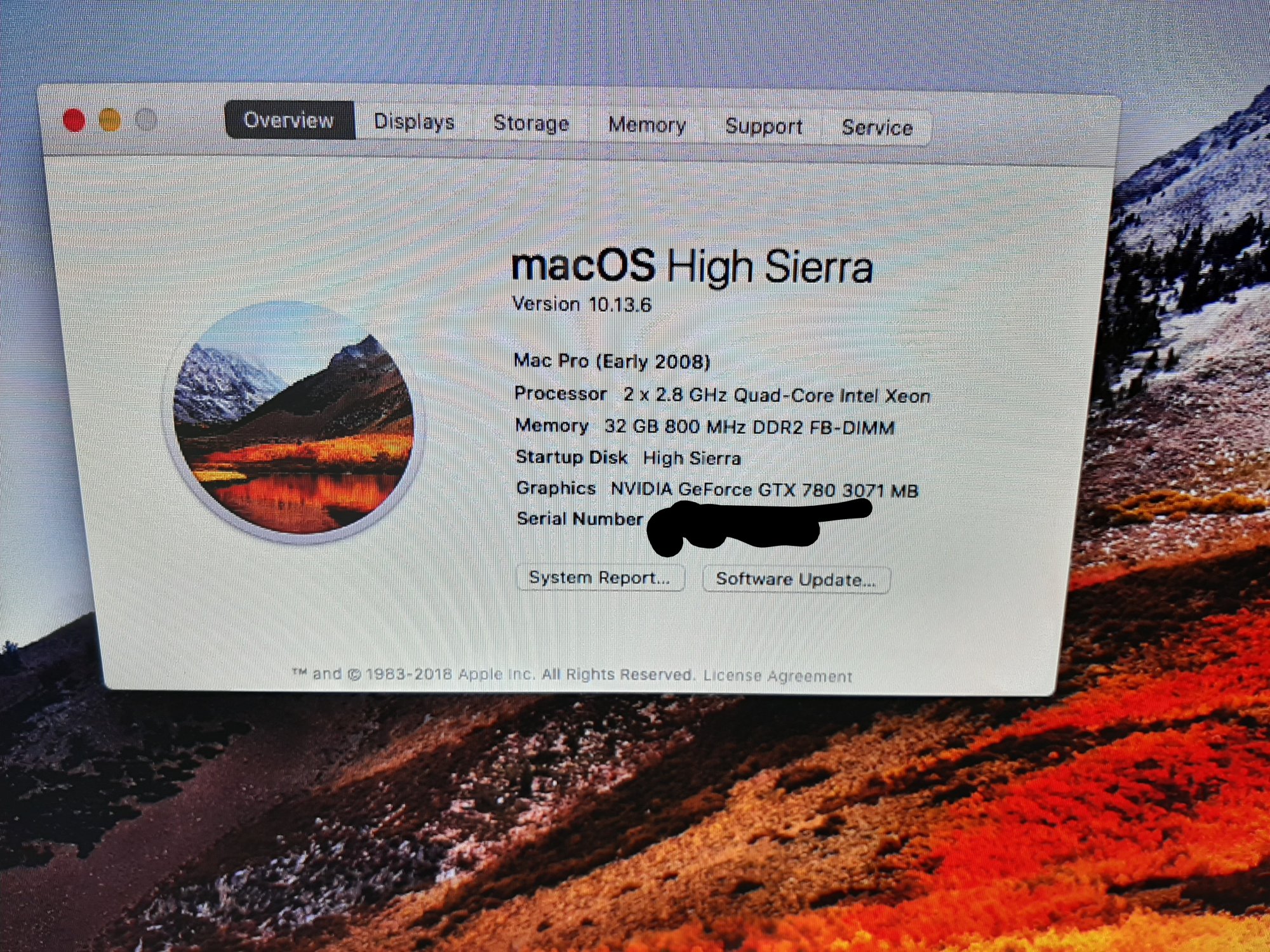

If I wanted to replace the original video card of my old MacPro 3.1 (ATI Radeon HD 2600) with a Metal compatible video card which card could I buy?. I don't have big graphics needs and I don't use games, I would like an inexpensive card to be installed quickly and that works immediately. Obviously it must be compatible with Mojave, now I use High Sierra.
GTX 780 3gb I have works beautifully, mine isn't flashed for Mac so no efi boot screen, but if you can find a flashed one you'd be golden!

All the GTX cards from GTX 660 to latest will run fine,
Just remember to use the GTX 680 OSX 10.13 drivers for High Sierra,
It is a good idea to used a flashed card though so you can have a boot screen.

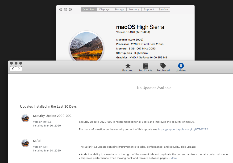

Apple has released the Security Update 2020-002 for 10.13.6. Can it be installed without issues? Does Patcher 2.7.0 work or do we need an updated version?
Unlike Security Update 2020-001 and Safari 13.0.5, which installed on my iMac 9,1 without issues through the MAS, Security Update 2020-002 and Safari 13.1 downloaded and installed through the MAS with the following error at the end of the install process:
The operation couldn't be completed.
(PKInstallErrorDomain error 112.)
After the restart, I got the Updates Not Installed notification. No updates available to install in the MAS.
FWIW, Safari now shows as version 13.1 and in About this Mac, the OS build number shows as 17G12034.
Reactions: K two
3,1 Mac mini with an APFS formatted SSD, and installed via the app store. Just like 2020-001, it installed perfectly with no post install needed.
