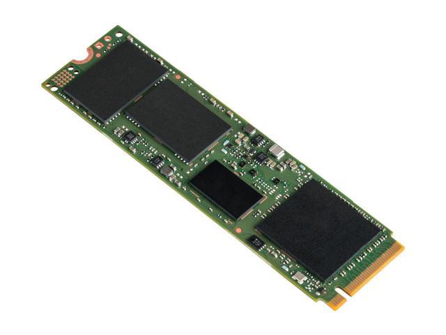

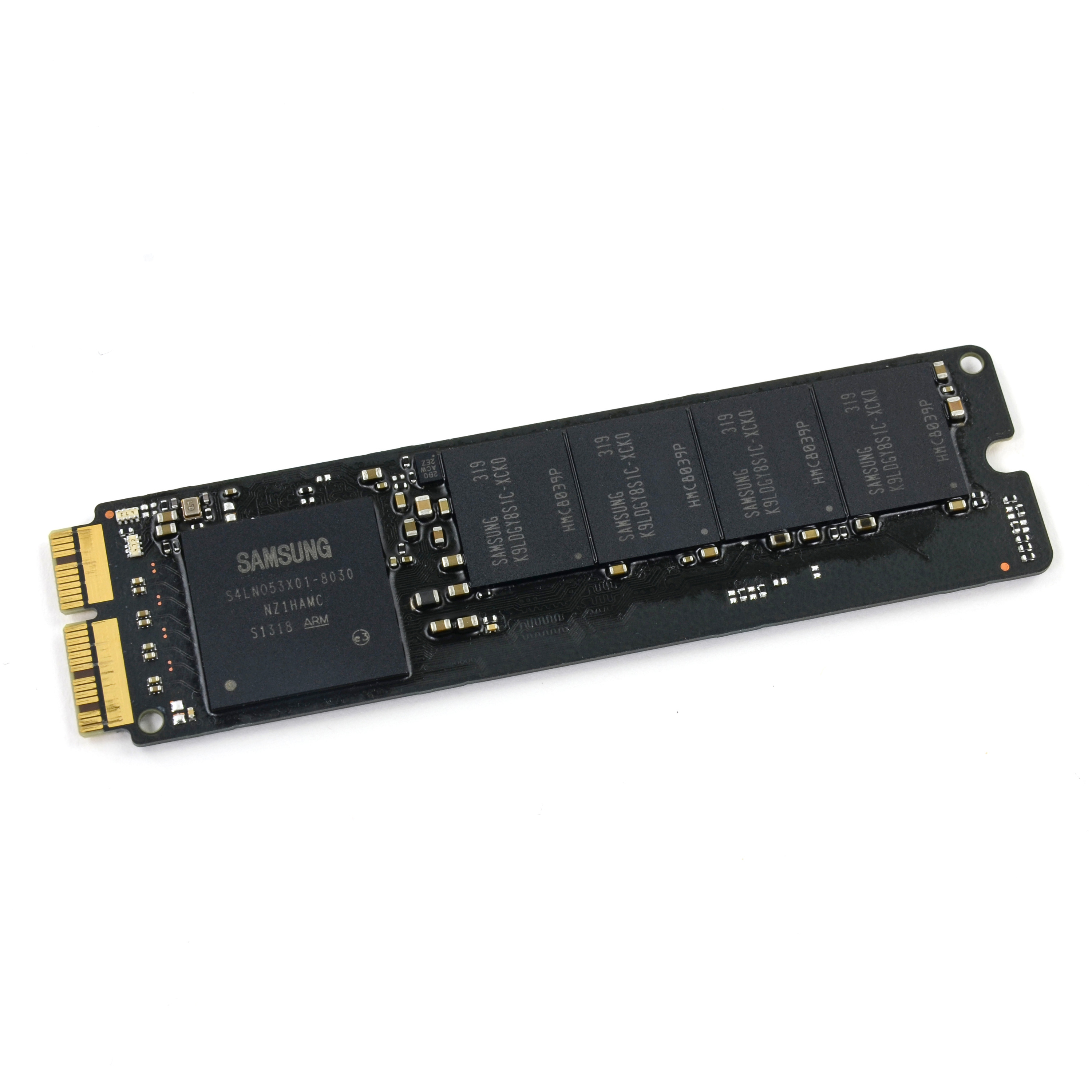

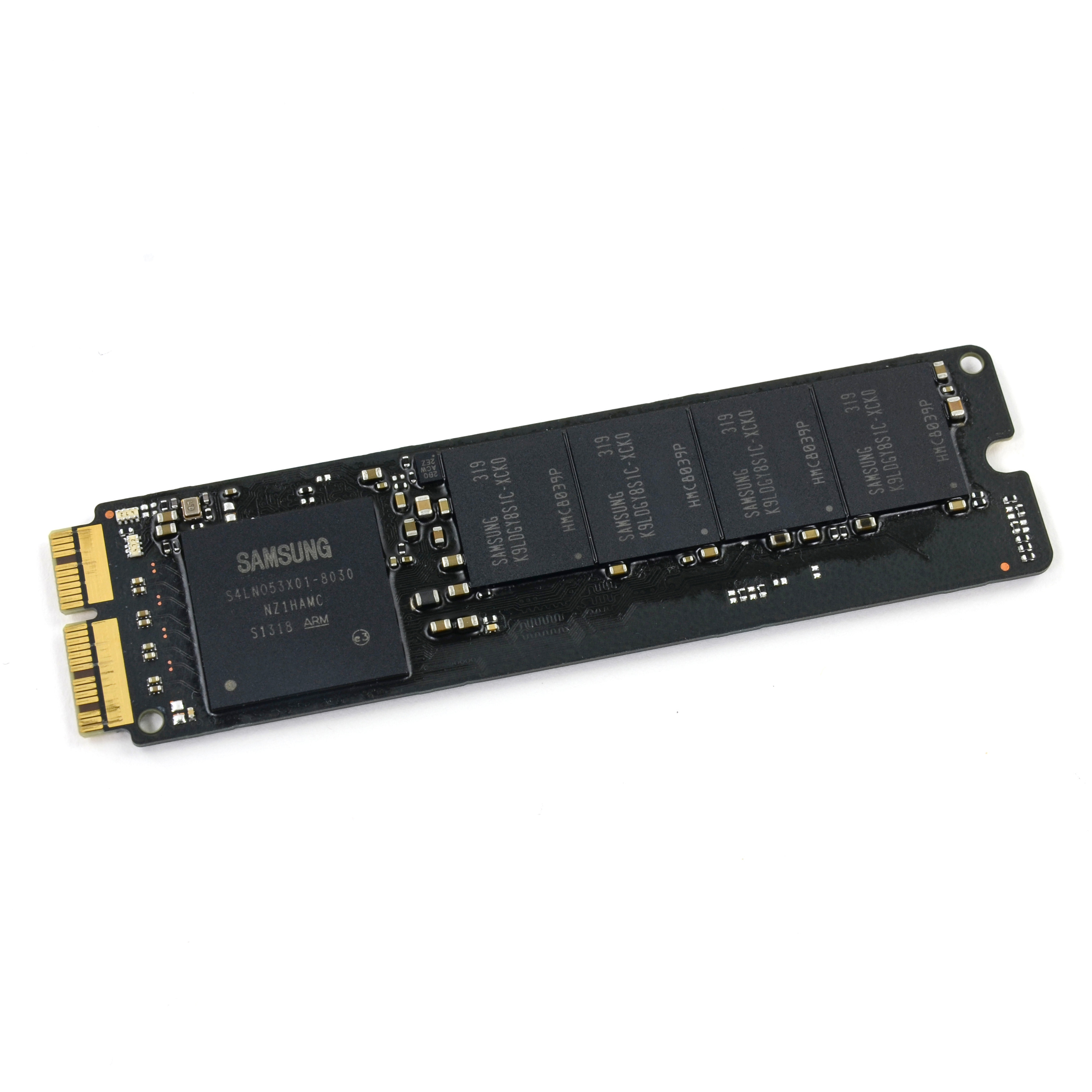

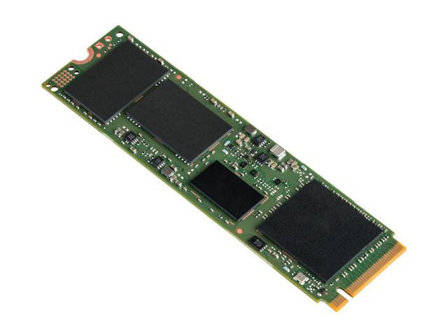

If the drive you ordered is not Apple OEM what brand is it? The only other maker that would fit is OWC. Unless you bought an adapter, the drive needs to be an Apple branded OEM drive that came from a late 2013 MacBook/MacBook Air or newer. Otherwise the slots are different, and it will not fit.
Look at the examples I attached. The first one is an Apple OEM SSD made by Samsung. The slot is near the middle. The second is an aftermarket Intel. The slots do not match up.
It's a WD Black PCIe NVMe with an adapter. It fits just fine and is recognized whenever the MBP is started in recovery mode or when I go to Disk Utility after getting the installation failure screen. The firmware update in High Sierra is supposed to make the bootrom recognize and run non-Apple SSDs. I just wish they'd made this firmware a separate update then I could better isolate the problem if it didn't update.
