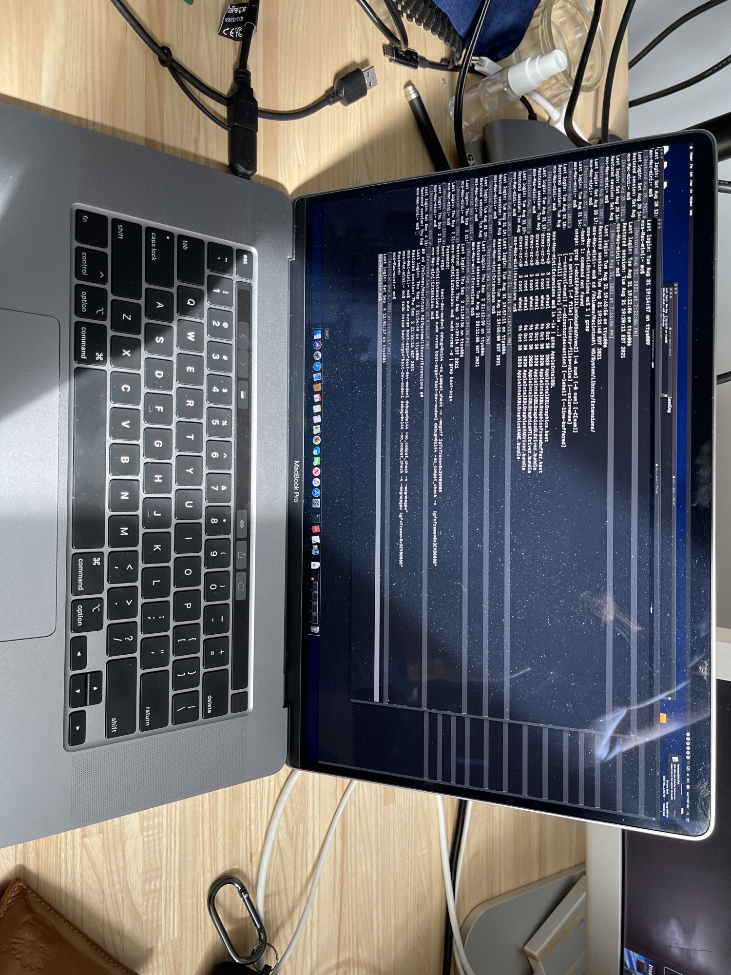

It will first got stuck at WindowServer initialization loop [1] (after some research on hackintosh forum: that its allegedly due to dGPU trying to control the display).
- I even added WhateverGreen kext to the usb and use a ‘boot--wegnoegp’, and It then kernel panic on loading IOUSBHostFamily after using WhateverGreen to patch out AMD GPU.
- So in the end I just used another mac (a Mini 2012 I had lying around) to install Mojave onto external boot drive and patch the Boot.plist on there.

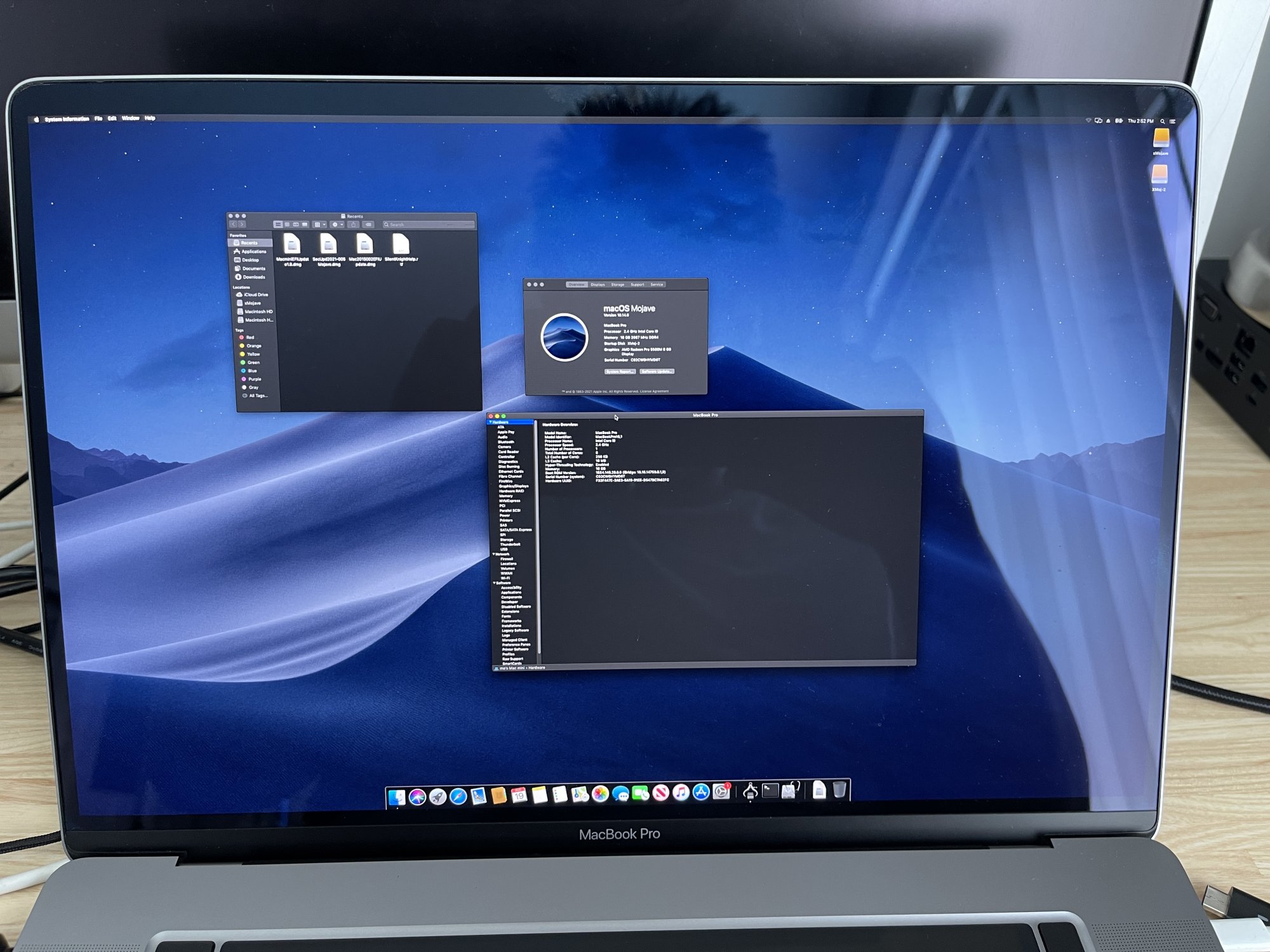

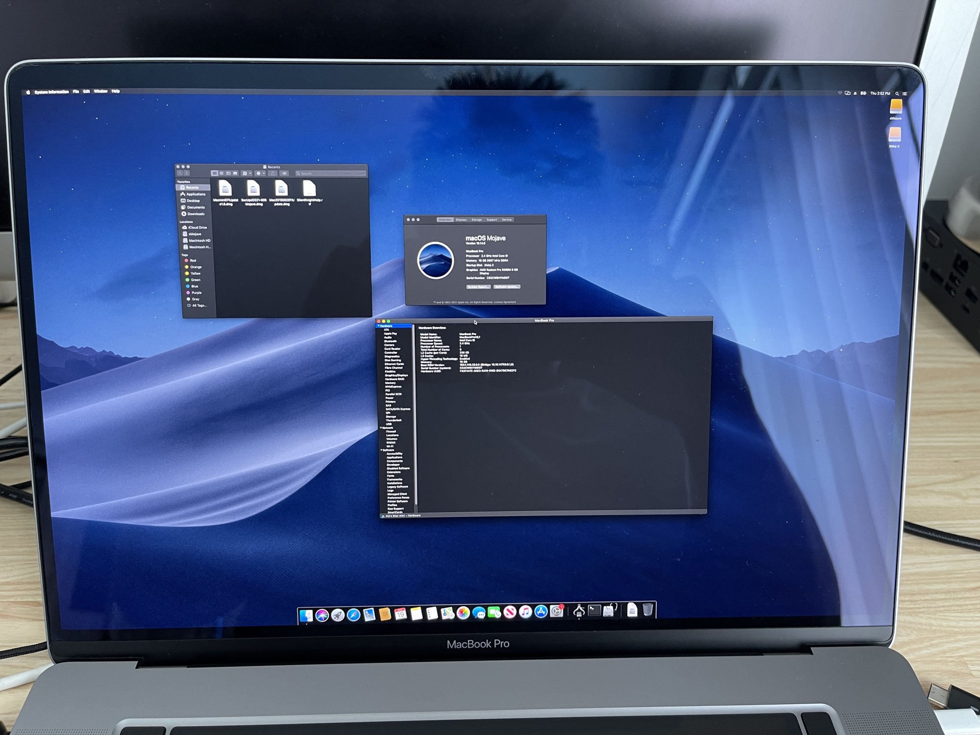

Results

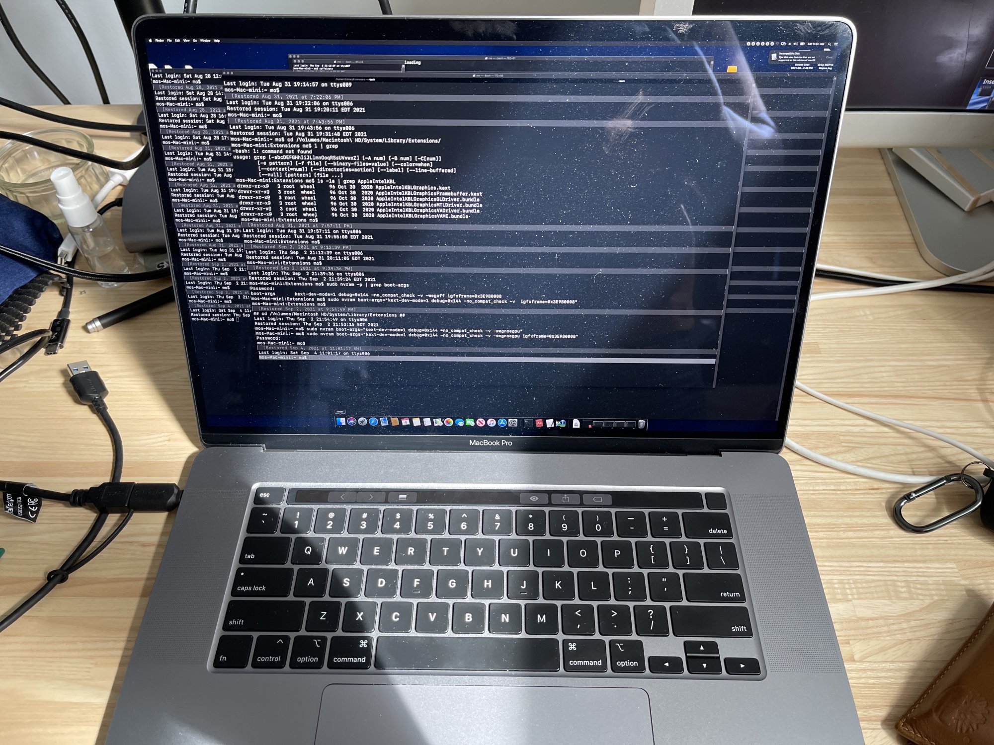

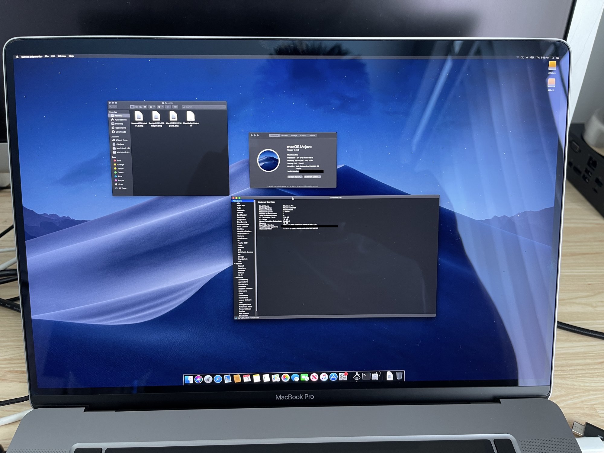

- AND it BOOTS (barely)

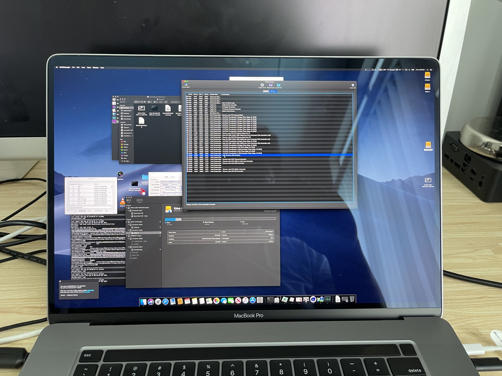

Current State and remarks:
- Right now this is pretty much in a "proof-of concept"/experimentation stage of things
- There is no GPU acceleration yet.
- error: [IGPU] Graphics Driver failed to load: could not register with Framebuffer driver!
- using -wegnoegpu causes the machine to not boot.
- iGPU, wifi seems to be discovered just fine, just no driver loaded. (might have to fake device ID?)

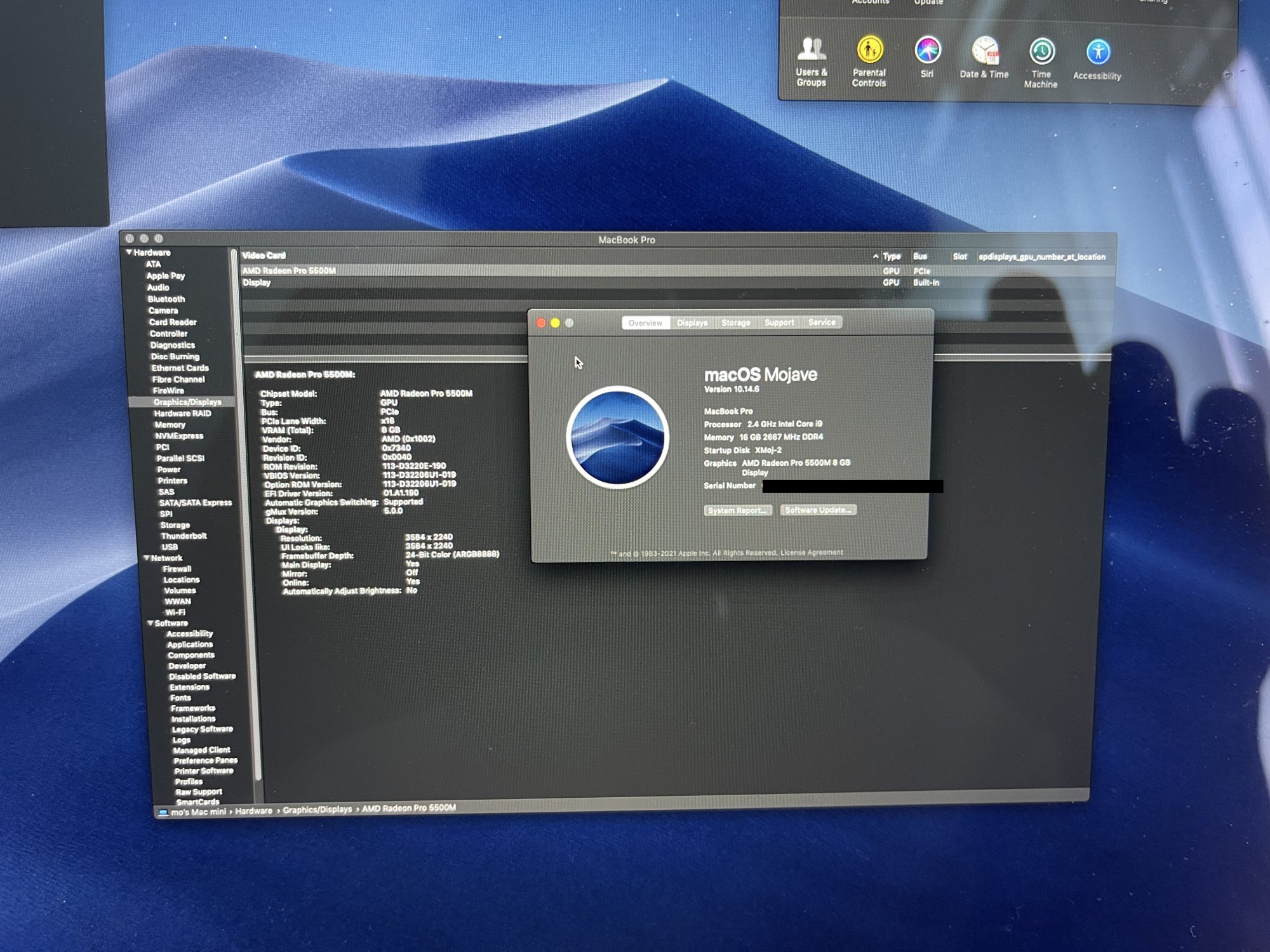

- Can assume that 5500M is the dominant GPU at the moment. (dcpi manager reports 5500M .Display_boot. framebuffer is used), in c​
What’s working:
- T2 SSD Controller, You will be able to mount, read/write internal drives. (actually this auto mounts)
- TouchBar (surprisingly), but no TouchID, and no Fn Key buttons (for some reason, yet to investigate)
- Thunderbolt/USB ports (somewhat)
- Bunch of Power/Temp Sensors.
- CPU States (seems to work. Shown in powermetrics, intel PowerGadget)
- Bluetooth
What’s not working:
- SMC version reporting (no version reported, despite working ok)
- no iGPU acceleration (no kext loaded, VRAM not detected)
- no dGPU acceleration (sorta expected, will try to remove whatevergreen argument)
- eGPU acceleration is not possible at the moment

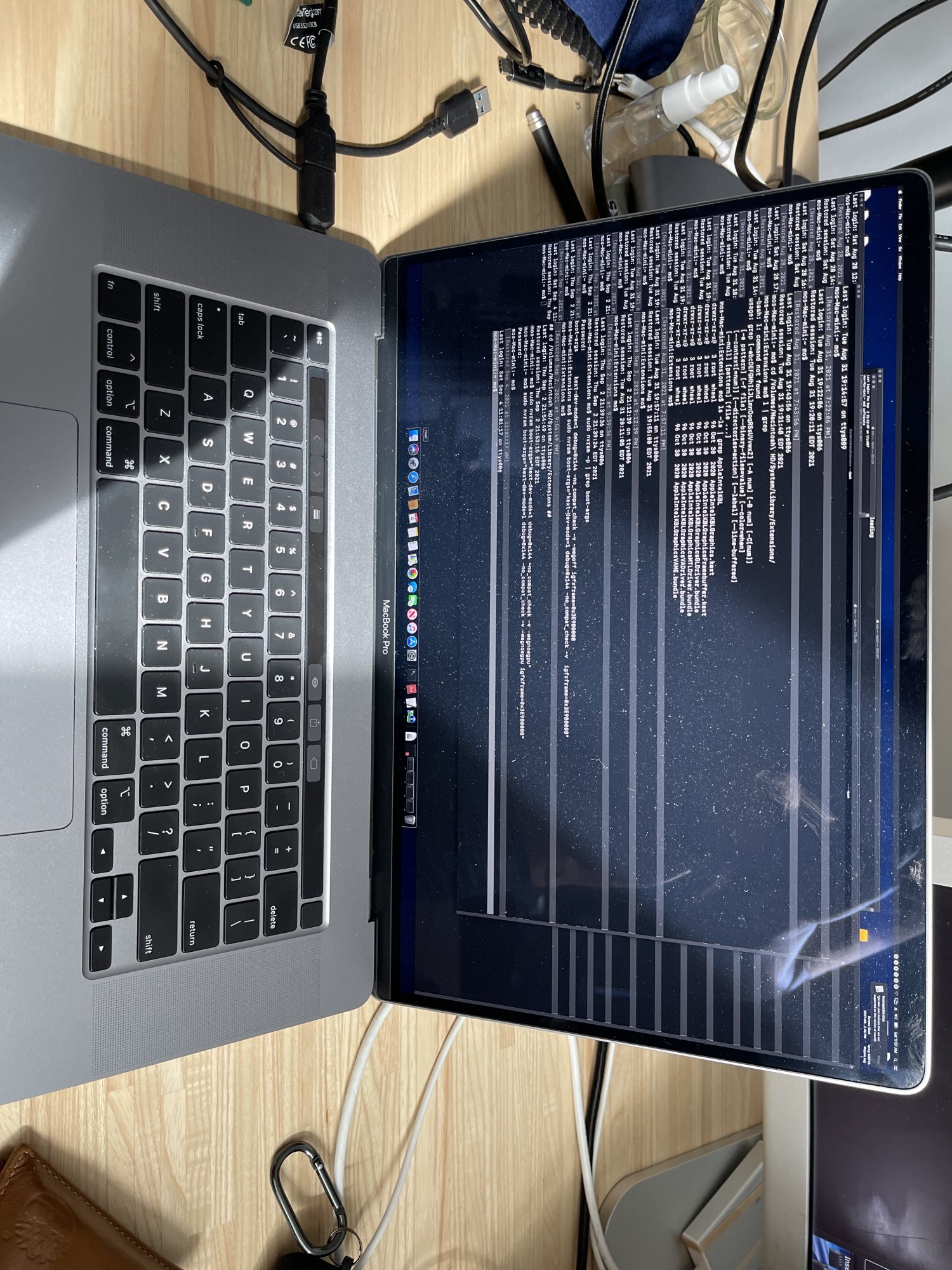

- eGPU got detected ok. But causes intermittent freezes. It can even output to secondary screen from the eGPU dock. But will not have acceleration.
- Suspected issues framebuffers between iGPU, dGPU, eGPU.
- Towards this end. Tried 'logging of and logging in'
- eGPU driven screen seemed to have acceleration, but I'm auto logged out as soon as I tried to log in.
- Display - Backlight Control, not reported as internal, stuck at 1:1 resolution, despite having switchresX
- Audio (It makes sound only on left speakers, might be hard to fix, as T2 handles audio now)
- WiFi - driver not loaded, cannot use.
- Trackpad (basic functions only, no gestures) (drivers not loaded)
- intermittent freezes. (when booting off Thunderbolt dongle)
