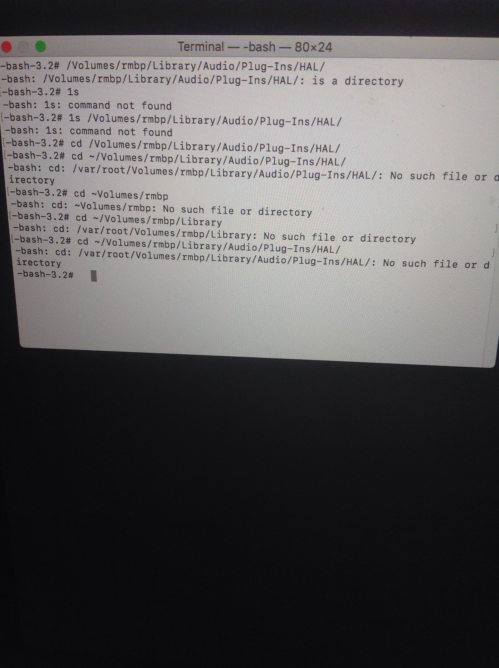

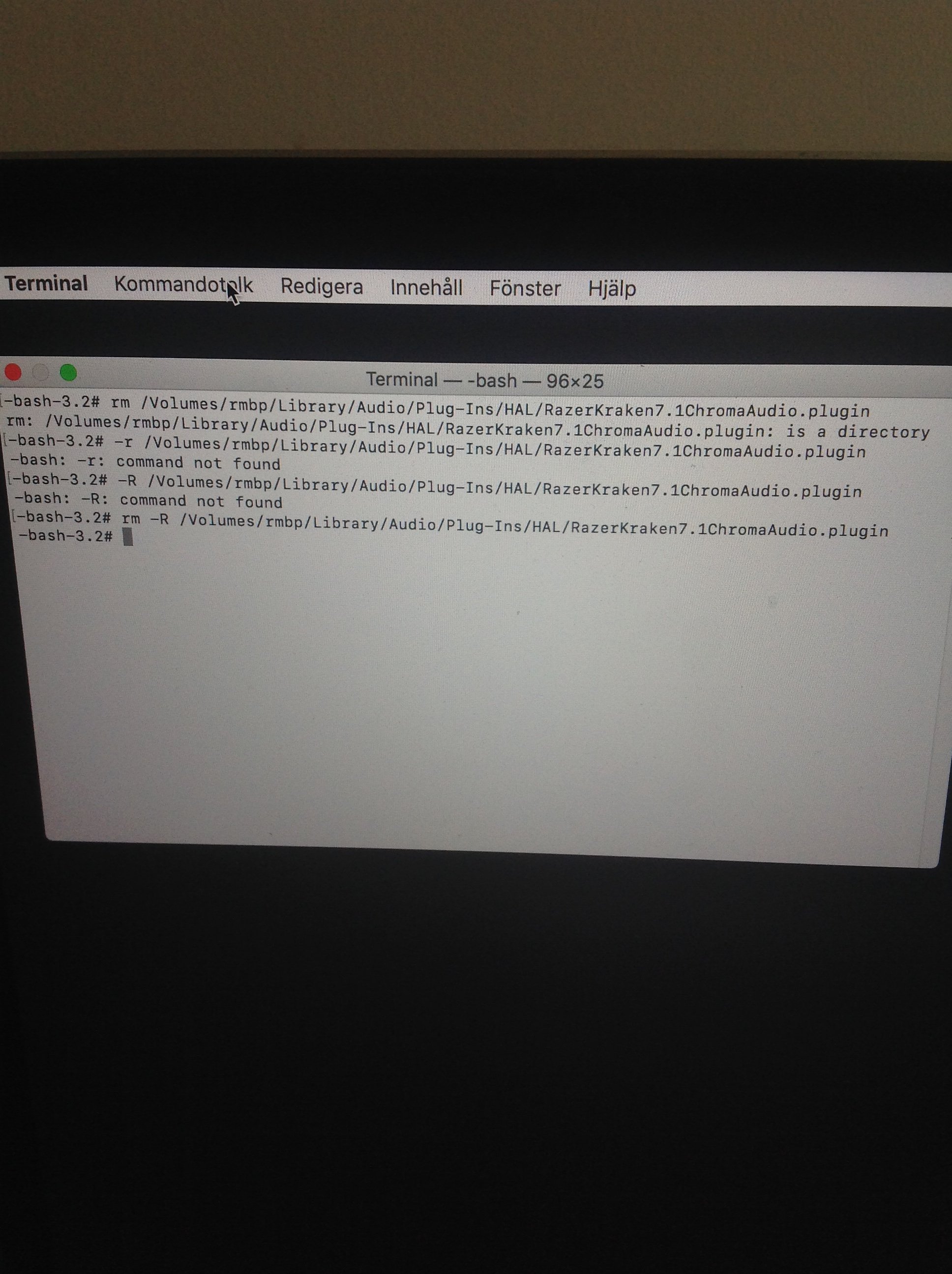

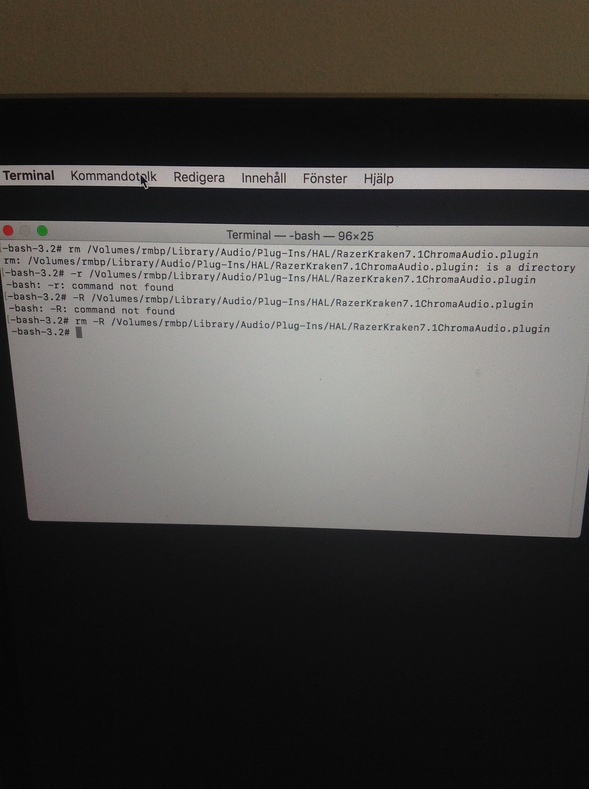

I also have razer headphones, and trying to go to the directory but I'm a total terminal newbie.
This is my terminal screen after trying to access the directory on the first line. Can't seem to use the right commands.
Would appreciate any help, been scratching my head tirelessly for many hours straight.
Thanks in advance.
[doublepost=1537873077][/doublepost]It's this file I guess that needs to be deleting. How do I write in terminal to delete it?

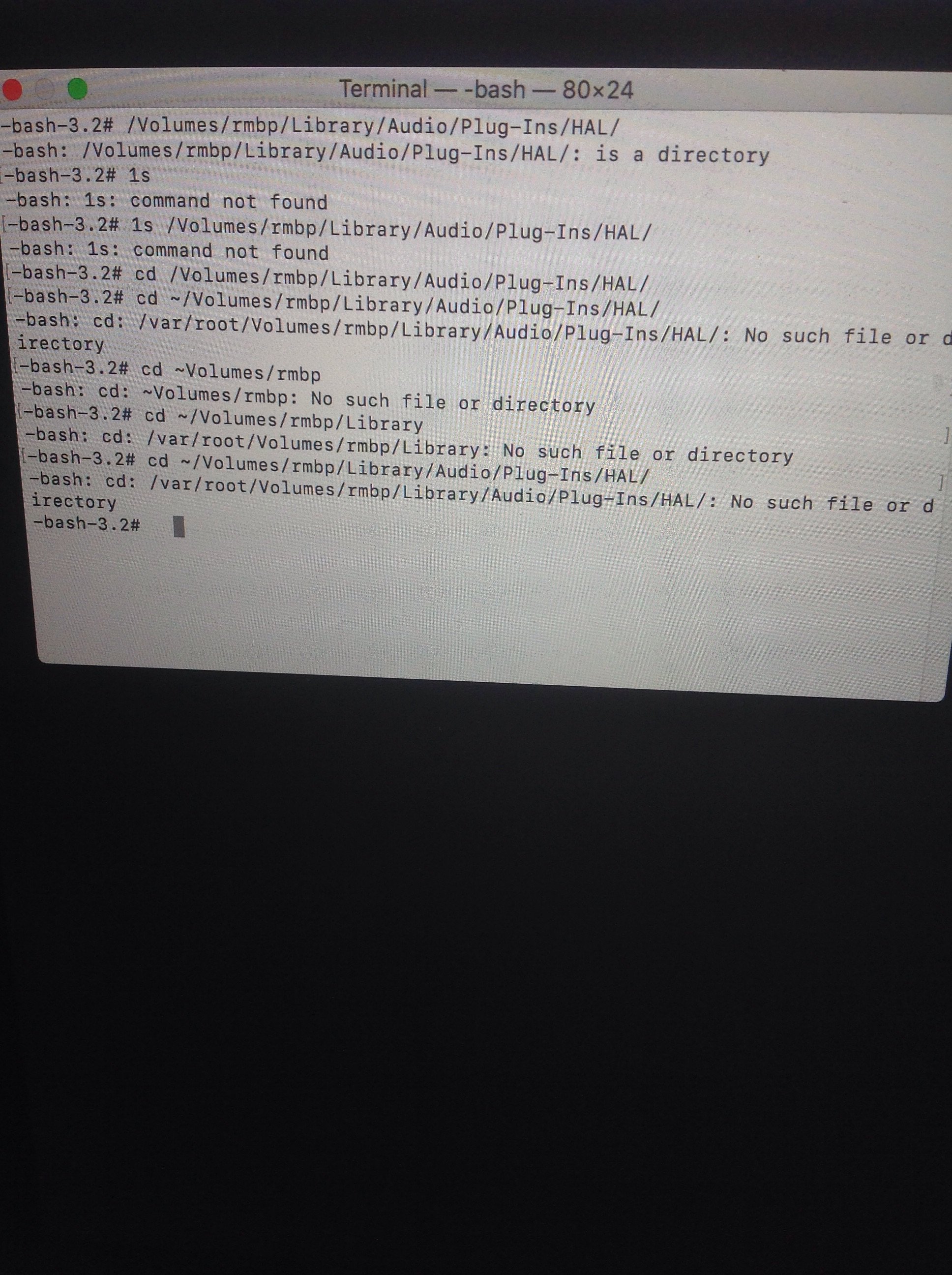

Thanks in advance.

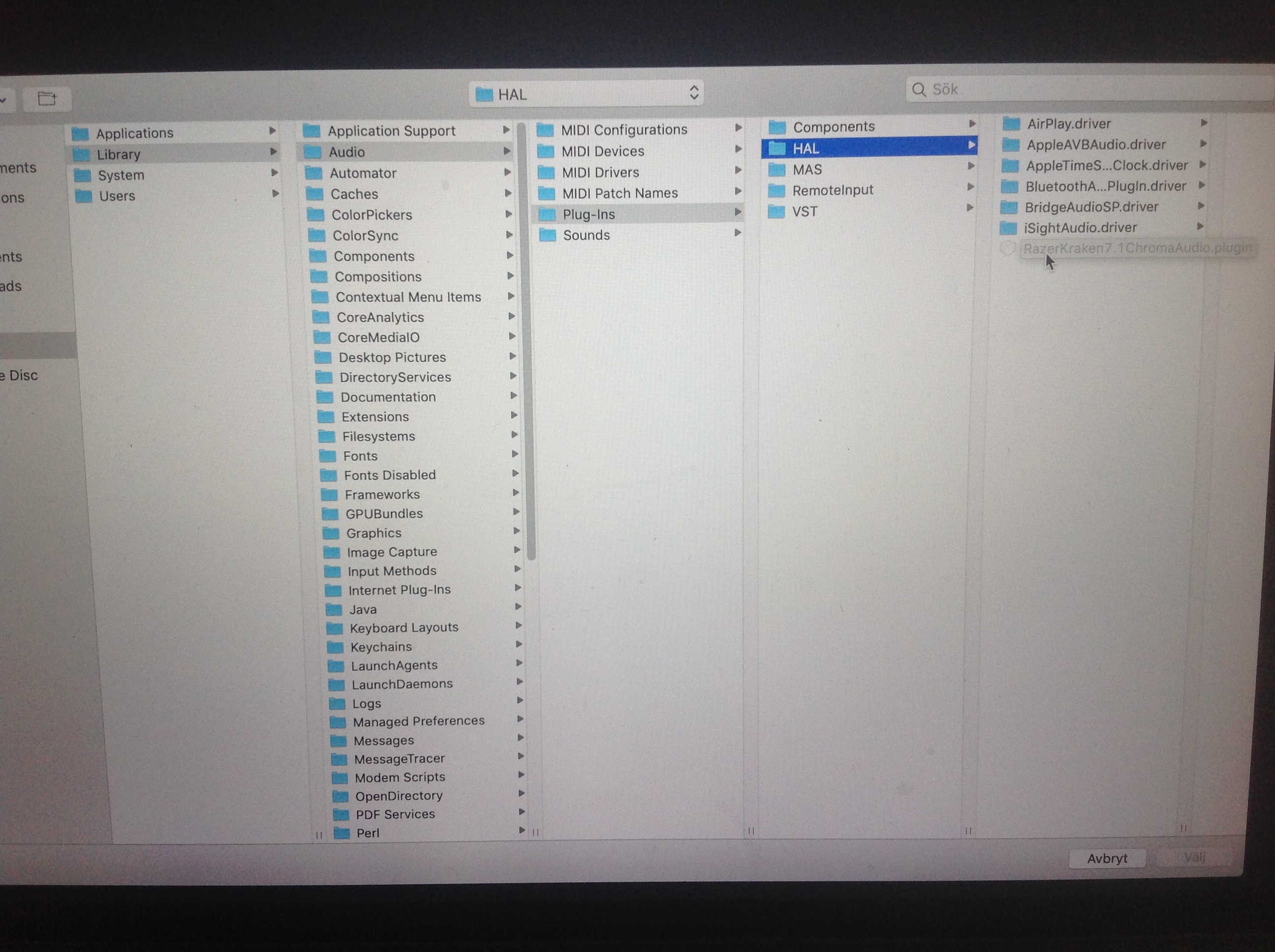

Same problem here and also got Razer Synapse installed. Curious if we can solve it trough the terminal!
Reactions: KaeptnTousu

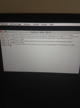

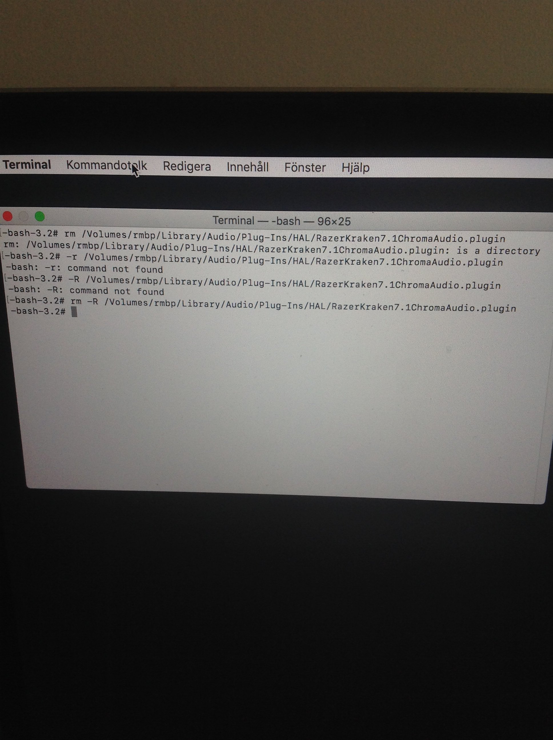

This last line worked and problem solved!!
[doublepost=1537874948][/doublepost]

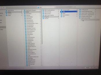

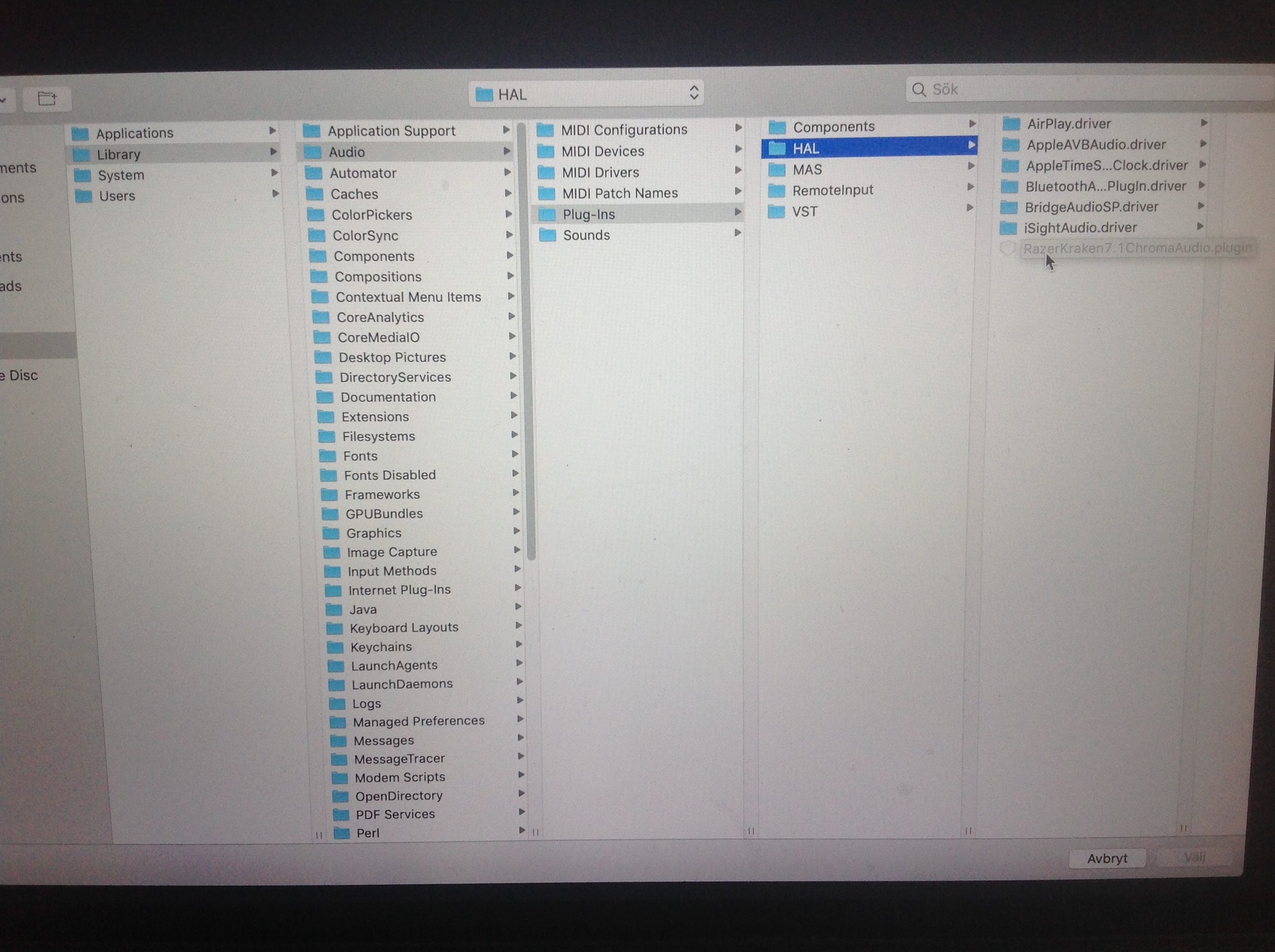

check my last post, change the /rmbp/ to whatever the name is on your HD, you can find it by opening the disc utility, if you want the exact line for your razer files in the folder, also use discutility, and by using one of the functions there, i dont remember which, probably restore from file, i was able to navigate through and find the contents of the HAL folder and locate the name of the razer files.

This community is amazing. I was having the same problem and this fixed it, with one difference. I didn't have any Razer plug-ins but I did have the "Hear.plugin", and when I deleted that the problem went away.

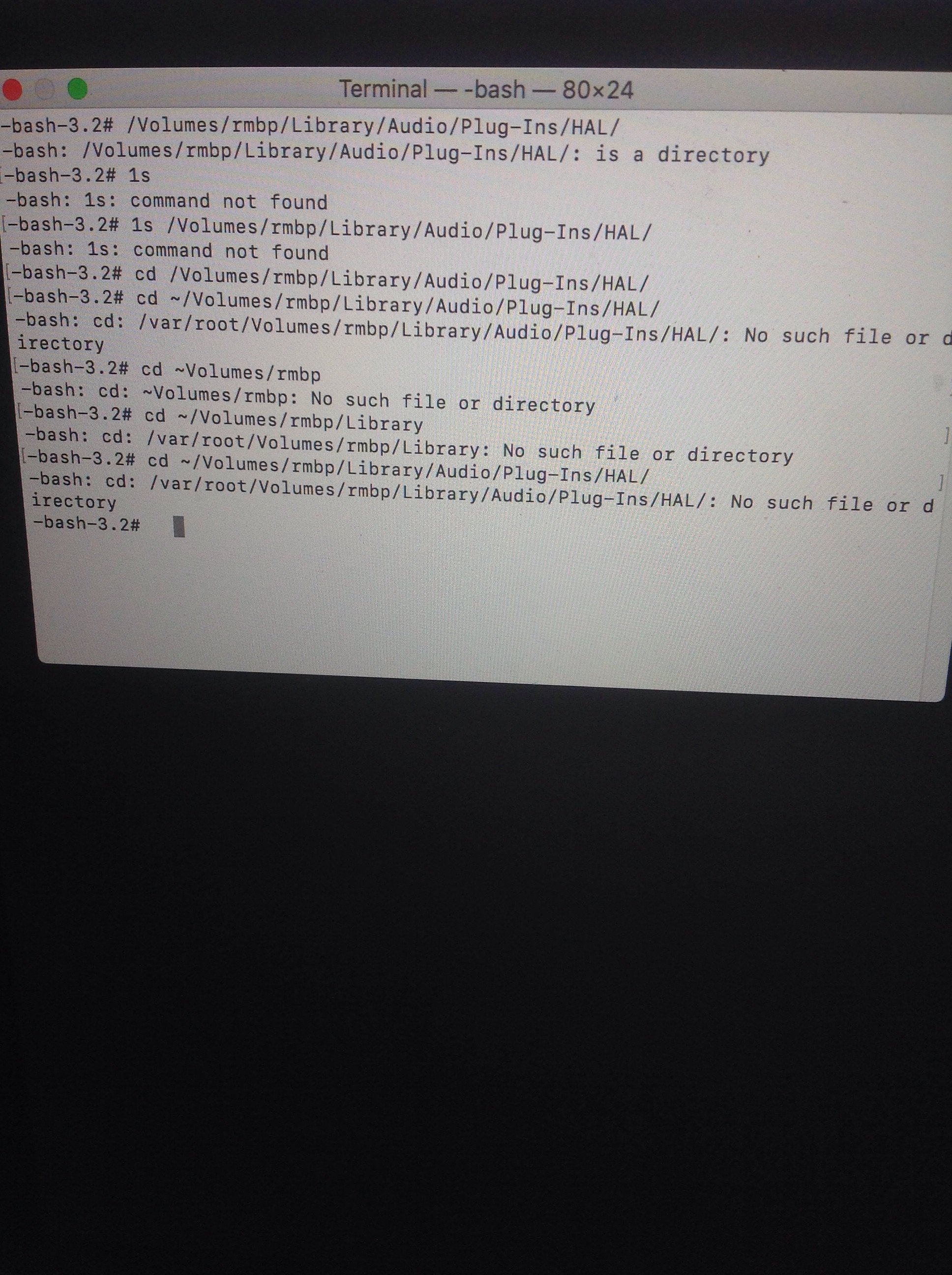

Hello all, thx for all your helps and postings here.
I have the same problem, but can‘t get it fixed. I think i‘m totaly noob but i dont know how to use the terminal...
My Razer Audio Plugin has the name „RazerKraken7.1Audio.plugin“ which i found out using the disk utility manager. But i cant see the full path of that file there so what should i write in terminal? I have only one HD...
terminal says always: No such file or directory
I think its totaly simple but i am biggest noob ever :-(
