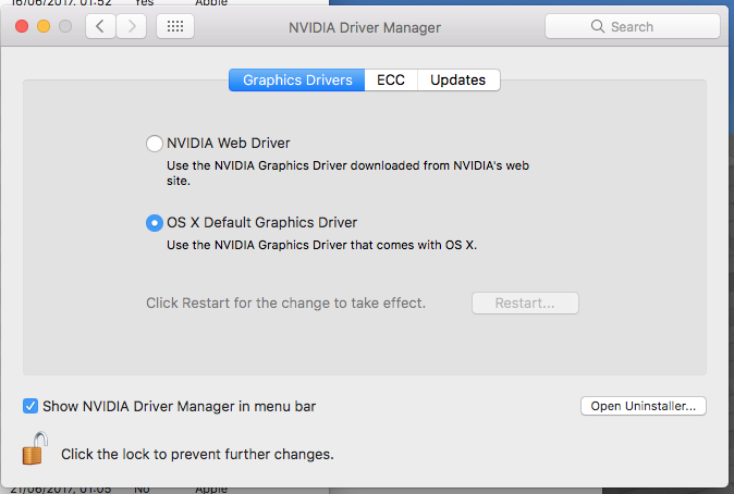

So once you've installed the proper driver, you can't select the web driver from the driver manager preferences? It's normal that it would revert back to the default after a system update.
All of this seems to point to you having the wrong version of Nvidia Web Driver.

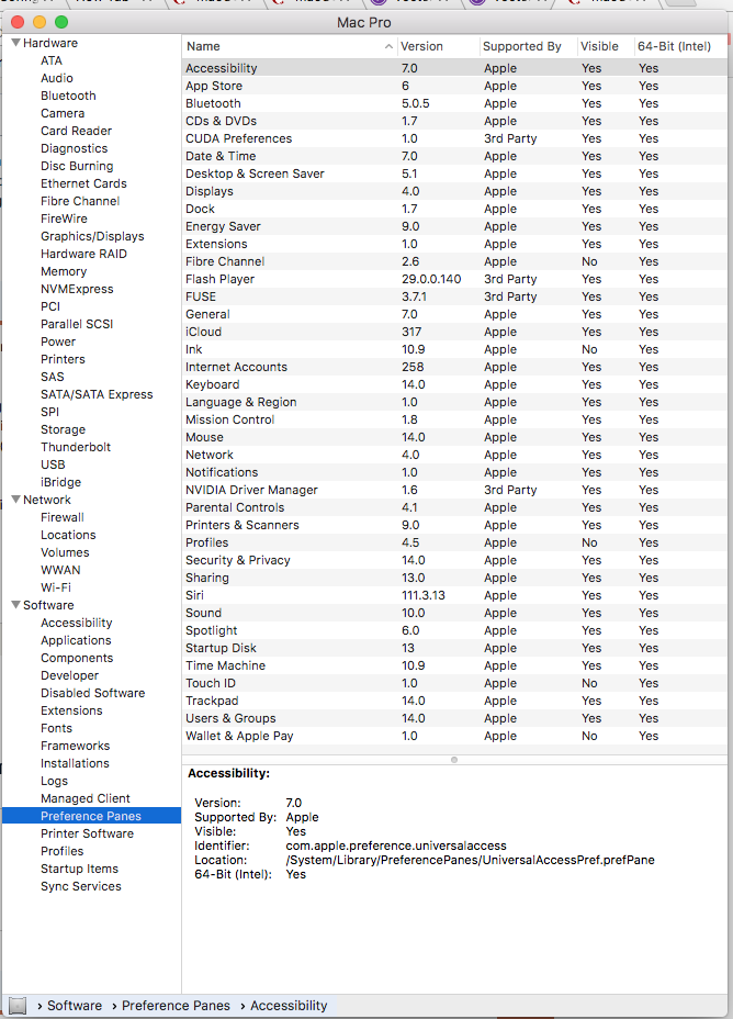

Go to Apple > About This Mac > System Report and post a screenshot or list of your Software > Preference Panes and Software > Extensions.

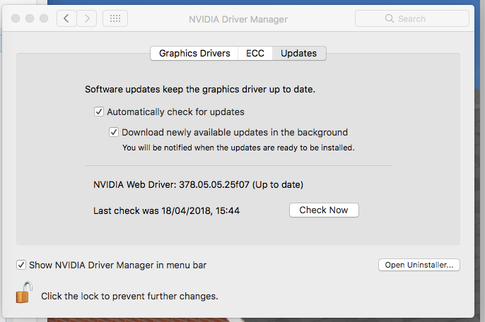

The Nvidia driver was installed form the preferences pane via the Nvidia updater and is the correct one for the system. See the attached screenshot

I attach a screenshot of the preference panes and a printout of the Extensions (80 pages). I have two spare internal hard drives so I could go the nuclear route if necessary...
The real issue is crashing. I need to do some work and see if the crashing issue has been solved with the system update before doing something more drastic. I've spent too busy today dealing with this issue to find out if I've still got the problem....

what does the GRAPHICS DRIVERS tab on that NVIDIA Driver Manager preference pane look like?
See attached screenshot

Have you manually set the NVIDIA driver manager preference page > Graphics Drivers to NVIDIA Web Driver then click the LOCK icon before restarting?
