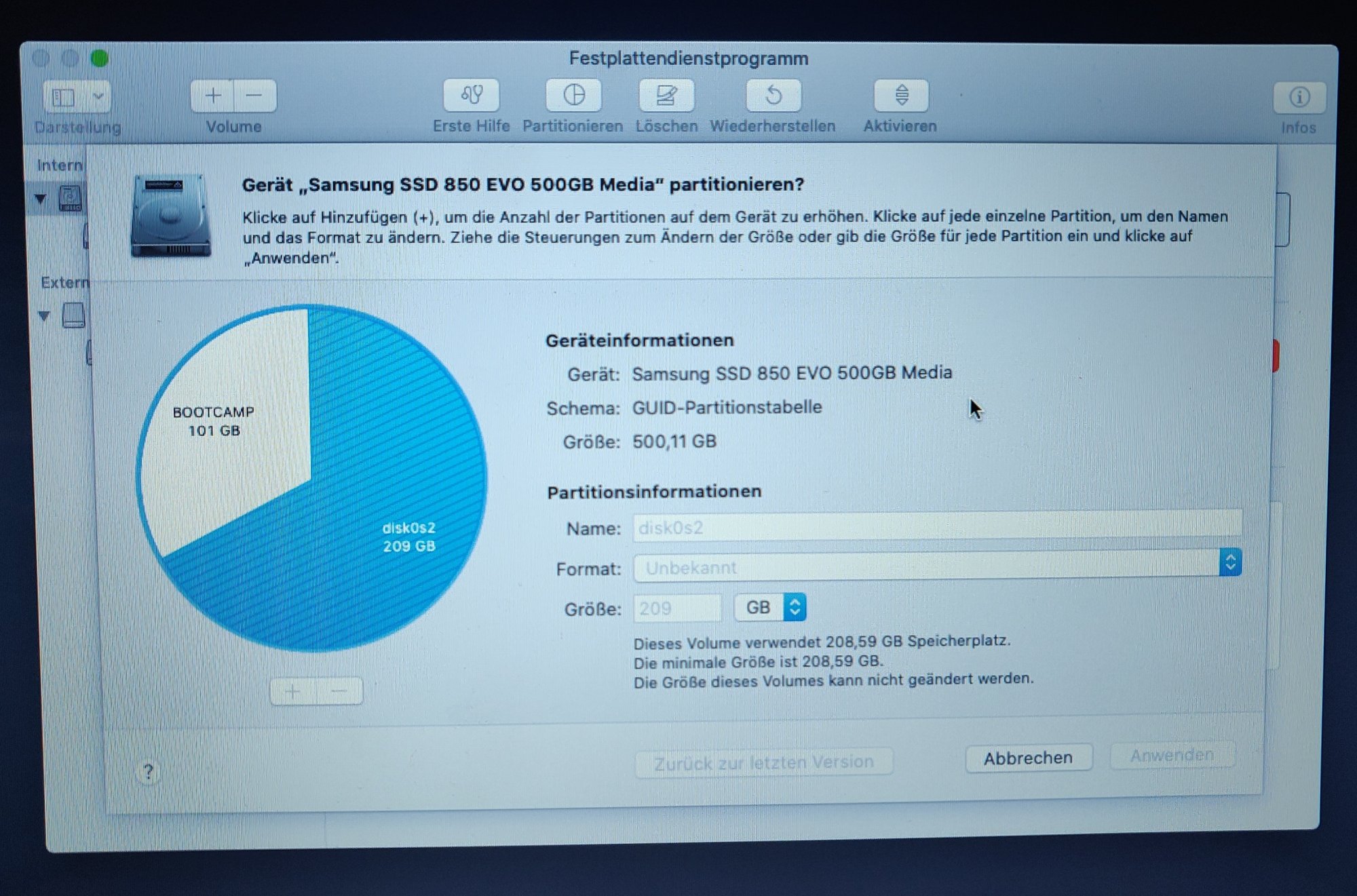

Then i created a USB-Stick with a macOS installer on it and went into Disk-Management-Utility to get to see that there is no macOS partition anymore. At least macOS doesn't recognize it as one.
The partition where macOS should be installed on is just named disk0s2 and the one where Linux was installed on is just gone and its not even shown as free space, 190GB are just gone.
I attached a photo of the partitioning of the drive.

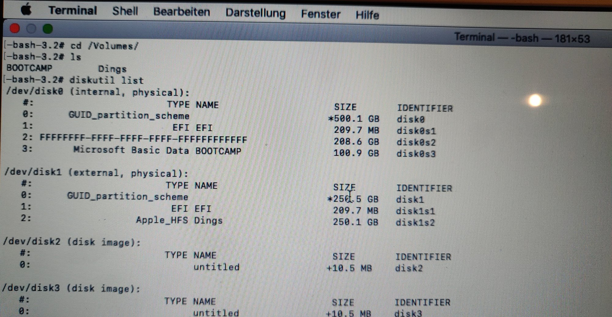

EDIT: I added a photo of "diskutil list"
EDIT 2: When i try "diskutil verifyVolume disk0s2" or "diskutil repariVolume disk0s2" i get "Error starting file system repair for disk0s2: Unrecognized file system (-69846)"

As you have discovered it is dangerous to install other OSs on your boot disk. Put them on another disk. Or, perhaps better, in a virtual machine.
Enough preaching. You can recover by doing Internet Recovery, erasing your disk, installing macOS and with Migration Assistant get back your apps, data and settings from Time Machine. Or whatever backup system you use.
Maybe not Internet Recovery on such an old Mac. You probably need to create an installer USB stick on another Mac.
Internet recovery is impossible on any 2009 Mac -- can't be done.
Sounds like you'll have to boot from an external source (if the USB flashdrive works), then ERASE the internal drive and start over.
Hope your Mac stuff was backed up...
