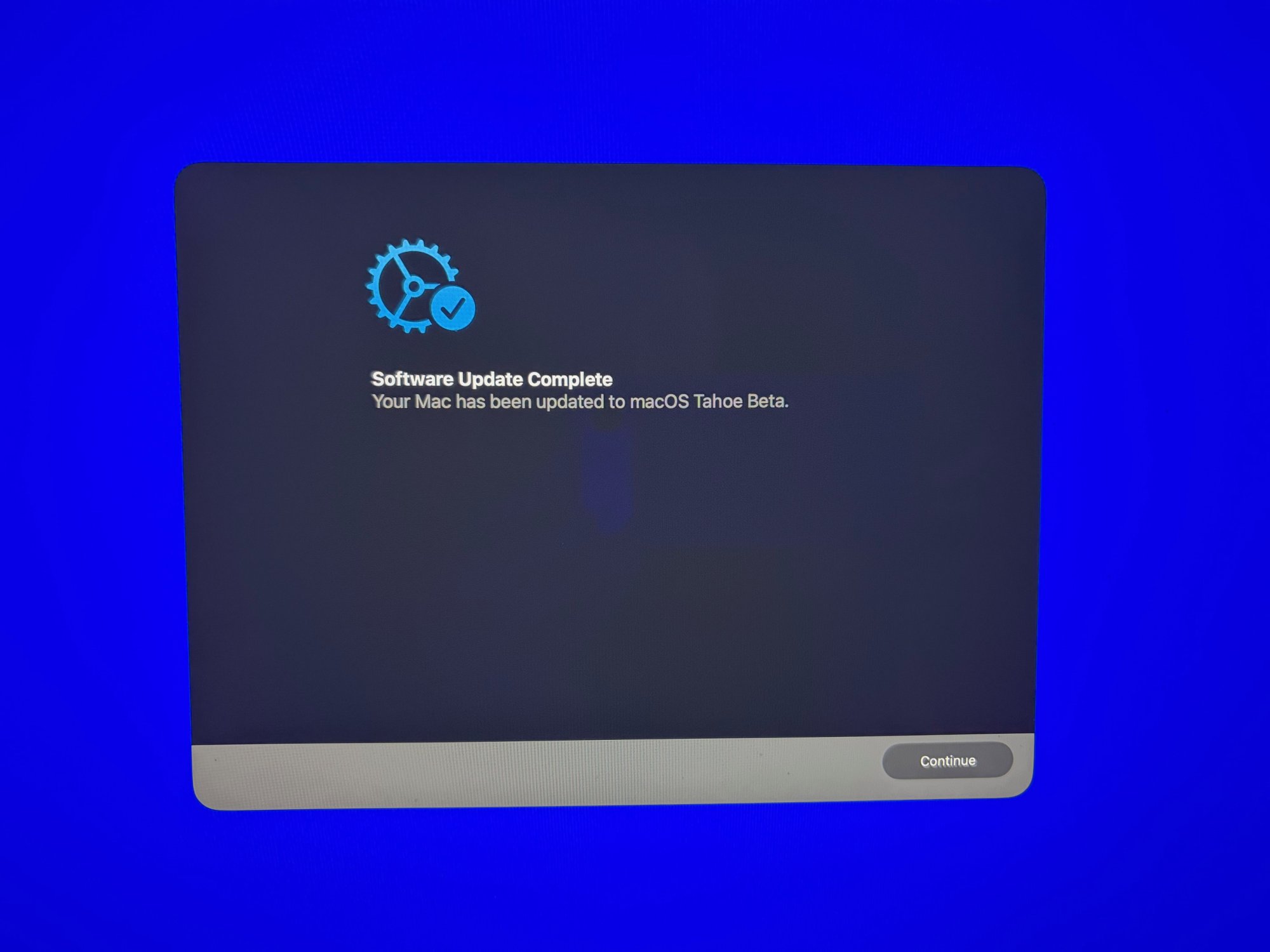

T26 B3/3.0.0n. OTW/OTA
Edit: If you have never heard the old saying "ya godda be kiddin me", just take a peak at the pic. Apple is melding the MacOS and IOS. No wonder the Devs are having a hard time, but someday the wait will be worth it.
The pic is the screen of the Imac, I had to restart to get things really going, after taking a long time to get the mouse on continue, which finally acted like an update on the phone. Now it is back to normal but every thing was stacked in the process. The visuals seem to again be improved.

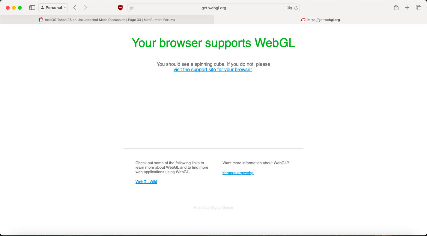

Please take your time. And in the time you take, can you please also address the glitch in Safari where sites requiring WebGL are black, and a spinning cube doesn't show up in get.webgl.org? It's been happening since I updated to macOS Sequoia and used Safari 18.0, and the situation still hasn't improved in Safari 26.0.1.
Thank you in advance.

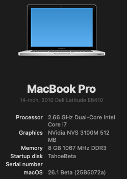

BTW, Tahoe 26.1 Beta 4 is out also (Build 25B5072a). Perhaps there'll be OCLP 3.0.x that will work for Tahoe, perhaps not. No matter. It's for a laptop gift, I've been awaiting - patiently - for 5 months. Either Sequoia or Tahoe.
