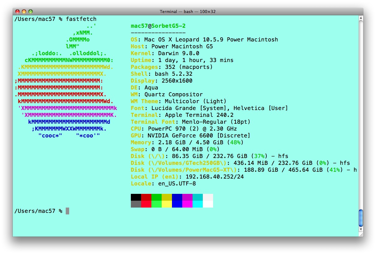

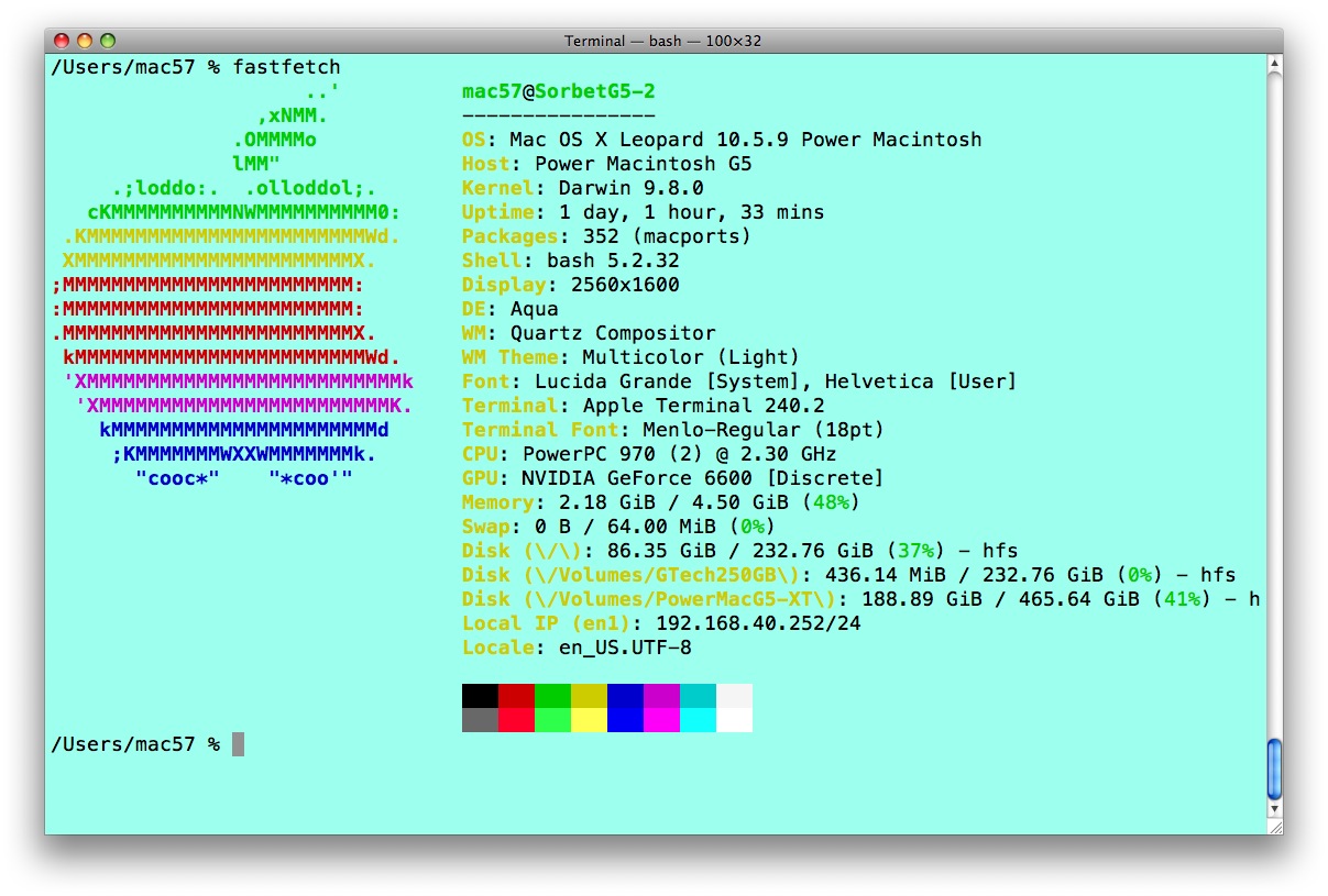

Finally, success! ... the pointers from @barracuda156 were right on the mark. I had to install TextWrangler, and hunt for a long time to find the portfile for libjxl, but in the end all was well, and when I made the port file change suggested by @barracuda156 , the port went right through and the install of fastfetch *finally* succeeded.
[drum roll please]
... and the output of fastfetch appears below:
MANY, MANY thanks @barracuda156 !
[drum roll please]

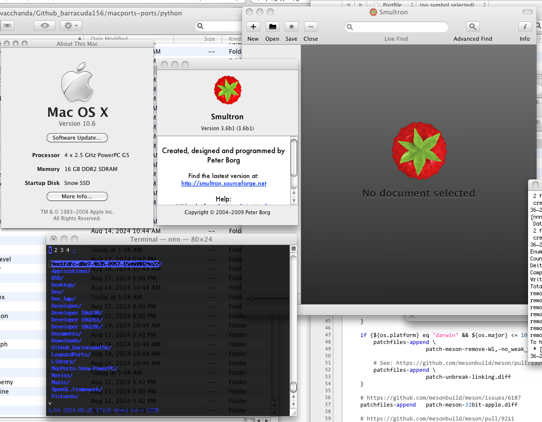

Smultron has built with zero changes, so now I have all ports which you were asking about.
Thanks @barracuda156, I will retry nnn and Smultron and post back.
Meantime, a new day and inexplicably, new results. I tried building Abiword-x11 and rebuilding nnn, and captured logs as requested. Both failed, as expected. Then, on a whim, I started X and tried running my existing sxiv port. It worked! What crashed yesterday ran flawlessly today. Ditto for gnumeric, which popped up a big, beautiful content-full window. Again, what crashed yesterday succeeded today.
I am at a loss to explain. I did do a few additional build attempts, and those built and deployed a few new dependencies, and I did restart my machine at one point. Now sxiv and gnumeric run successfully, despite no attempt to rebuild them... the exact same ports that failed yesterday work today. Did I happen to build a dependency that was not included by the portfile for one or each? I just don't know!
I checked to see which version of X11 I ran, and it was the one in /opt/local/bin, which looks to me like xorg-server-legacy. I issued the command "startx" to get it running, but I have yet to check what startx is configured to do besides the basic of starting X-Windows... Ran out of time for the day yesterday. I will check today.
Anyway, I am delighted to have gnumeric running... and also sxiv. Now I am going to try Geeqie, am interesting looking image viewer.
Oh... and attached are the logs for the build failures of Abiword-x11 and nnn.
