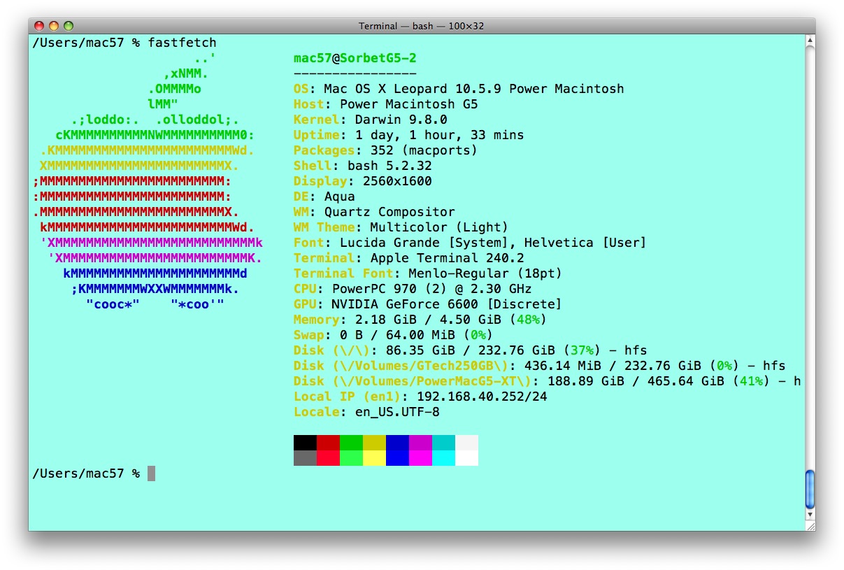

Finally, success! ... the pointers from @barracuda156 were right on the mark. I had to install TextWrangler, and hunt for a long time to find the portfile for libjxl, but in the end all was well, and when I made the port file change suggested by @barracuda156 , the port went right through and the install of fastfetch *finally* succeeded.
[drum roll please]
... and the output of fastfetch appears below:
MANY, MANY thanks @barracuda156 !
