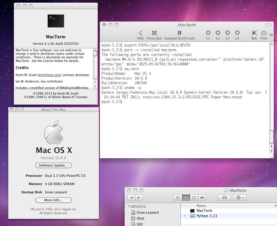

Made a port for MacTerm, fixed a newer version to build for ppc:
Do you know if its possible to bring in a newer build of iTerm? It's always been my go-to terminal for its ease of use and featureset.
Reactions: Jazzzny
