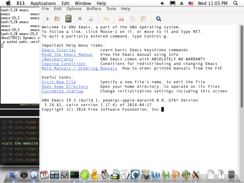

this is impressive. any chance the gui version can be compiled? gtk2 and 3 are broke on powerpc if i recall
Both versions of GTK work fine. What you may need to do is wipe out Apple X11 from the system and use Macports one. (Reverse might be possible, but you are likely to have some libs missing, and why use an older thing anyway.)
Having both produces nasty obscure bugs which no one recognizes, and breaks X server. Avoid it.
Emacs should be from this: https://github.com/macports/macports-ports/pull/23381
Use emacs-devel. Non-devel may or may not build.
Also pick this:
I had no time to try X11/GTK variants here. In principle they should build.
JIT support at the moment does not (both ppc and i386, though for different reasons).
P. S. I was thinking GTK are broken myself, until I finally decided to spend 5 minutes to clean the mess. Everything works beautifully now. (Well, I won’t say every X11 app works perfectly: for multimedia Qt4 is better, but GTK apps do work fine.
Also pick this:

do you have a quick rundown on how exactly I can do this? wiping out apple x11 in favor of hand built and building emacs gui?
I advise to follow this sequence:
1. Make sure you are able to install `xorg-server-legacy` or `xorg-sever-1.8`.
If you are on 10.6 ppc, add this: https://github.com/macports/macports-ports/commit/8cf1a5a22d5df57663cacb64928a3c106acdd12e
2. Provided step 1 works normally, wipe out Apple and XQuartz X11:
Reboot.
This should fix X11 and GTK stuff.
Build `emacs-devel` from the PR referred. (Non-devel has not been tested, but may work too.)
Reboot.
oh i thought this was leopard but u are on 10.6 oops
Well, it should work on Leopard as well, I just cannot check that at the moment.
UPD. Fix for emacs has been merged, so should be available soon without manual trickery. Please try installing and if something fails, let me know. We will fix that :)

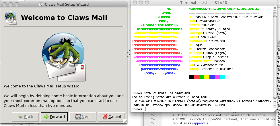

Re Claws-Mail: I have just updated it few days back and it should build:
(Ignore “non-functional” in commit title, this is a second one, previous one updates and fixes the build.)
P. S. You may need to wipe out Apple/XQuatz X11 and install Macports xorg-xserver-legacy for X11/GTK apps to work.

emacs-devel +x11 +gtk builds fine on ppc.

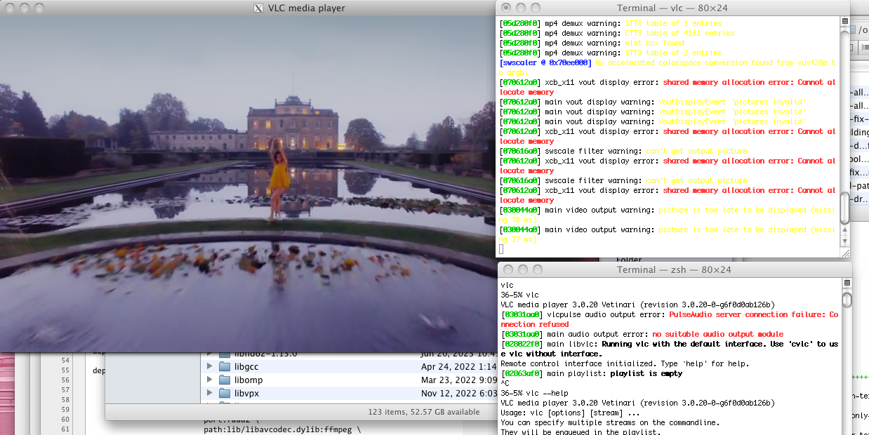

I got VLC 3.0.20 built :)
Kind of. Audio output does not work at the moment, something with Pulse, but video works. Oddly, yeah.
UPD. Sound is fixed in VLC3 now.
Not via PulseAudio, that one is still broken on its own (and not just on ppc in fact), but I have fixed CoreAudio module.
