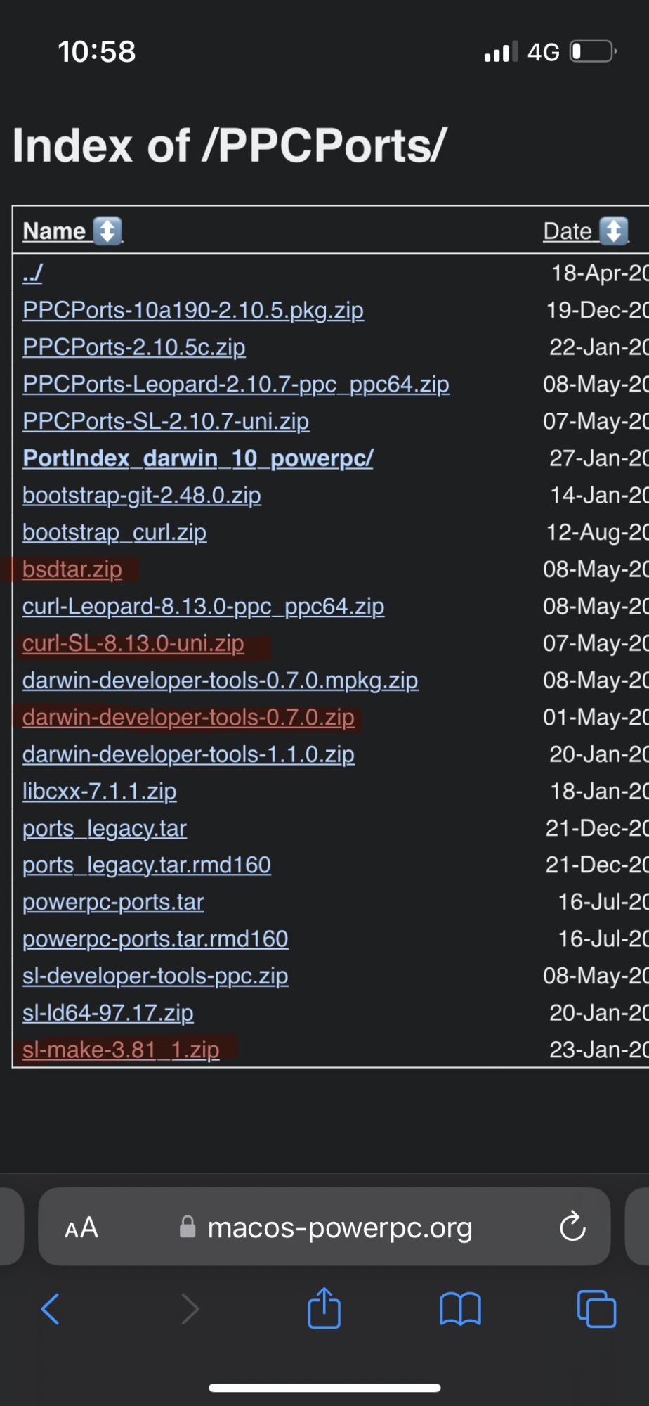

Hi all, trying to get PPCPorts installed on a G5 with Snow Leopard. The git MPKG would fail install in the middle of installing, but bootstrap_curl installed fine. However, I cannot get the PPCPorts MPKG to install, it says "Xcode is not installed, or was installed with UNIX Development (10.5+) or Command Line Support (10.4) deselected."
I was not instructed to install Xcode, what version do I install?
Well, Xcode is the requirement, as it is for the mainstream MacPorts.
Use standard 3.2.6 and after that install these:
Of these, curl is independent and can be installed before or after. If you used the old version, it will probably still work, but updating is recommended.
bsdtar here is not an installer but an archived binary picked from 10.6.8 release. It should replace the one in /usr/bin. You don’t need “my” binary, you can grab it yourself from standard 10.6.8. (This is a bug in our ppc image, it has a wrong bsdtar.)
Alternatively, this will also work, without replacing tar: https://github.com/barracuda156/powerpc-ports/issues/3#issuecomment-2847516667 (with this old tar can be used).
