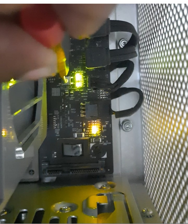

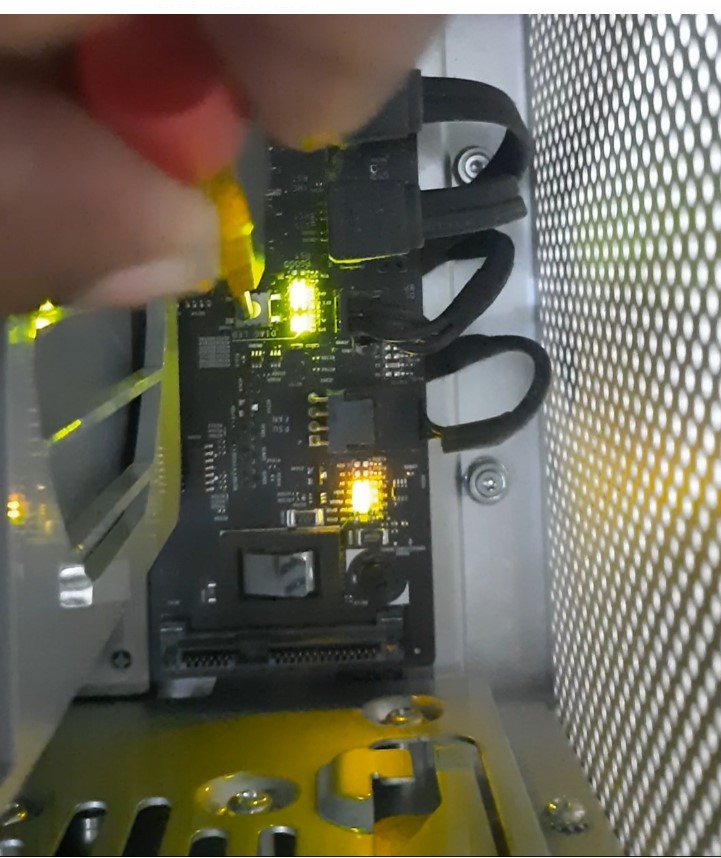

MacPro 5.1 2009 A1289 has no chime no display ,front side white led was on ,remove & keep single
memory on both side of slot and test no worked keep it off & remove power for 4 hours start working
with display after restart display was not working and no chime ,need to keep more time to disconnect the
power ,please guide how is it happen .

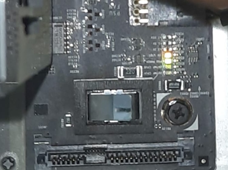

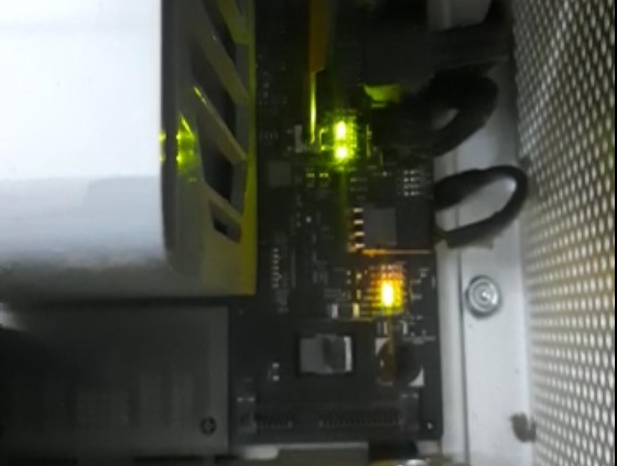

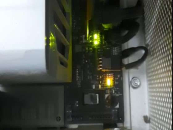

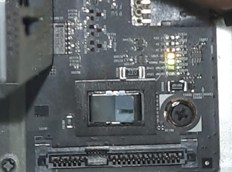

Thanks for the reply reset all memory & keep just one ram dimm1 & dimm5 ,if keep off some time power on after shutdown not turn on diagnostics led image was attached Power supply has to change ,having late 2008 model PSU don,t know it was compatible

I bet for the GPU, a 2600 is very ancient and tends to fail, it is compatible but from a 2008 machine.
Pull the GPU, pull all drives to do not harm them.
For POST you even dont need a GPU. Just the Processor(s) and at least one ram stick.
Pull Power for a minute.
Do Nvram Reset like @MIKX told, keep on holding the keys (for 3 minutes), maybe to make more resets in a row.
Until it chimes, hopefully...

Thanks for the reply we did the same as your messages ,connect with other gpu also same ,after keep more than 6 hours one time it was power on tested for any high temperature changes with apps not shown any high temperature issues also put heat sink paste to the cpu at that moment mac power on and make restart worked perfectly ,after shutdown not started again,suspecting PSU unit not available easily. Recently two days before upgrade 4.1 to 5.1 version which working properly ,after we have old El captain installed hardware connected ,after that new issue. started

Try a nvram reset, may be firmware update stuck press and hold power button for 10 second, get a beep sound with cd drive start opening & progress bar on screen, mostly same issue

Try boot with out gpu with minimum ram check there was any chime sound, also keep disconnect for 12 to 24 hours, my case it was bricked backpane board.
