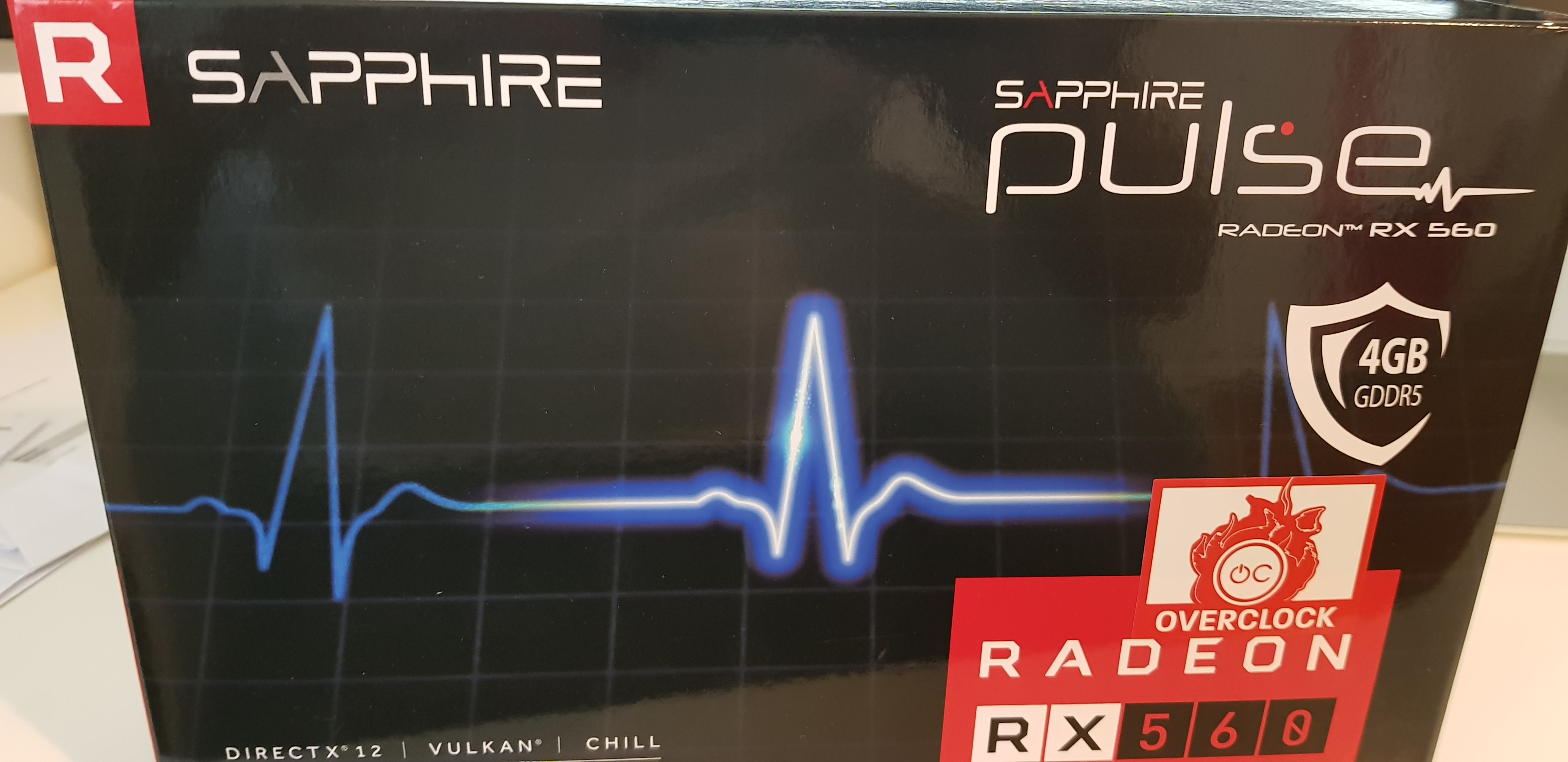

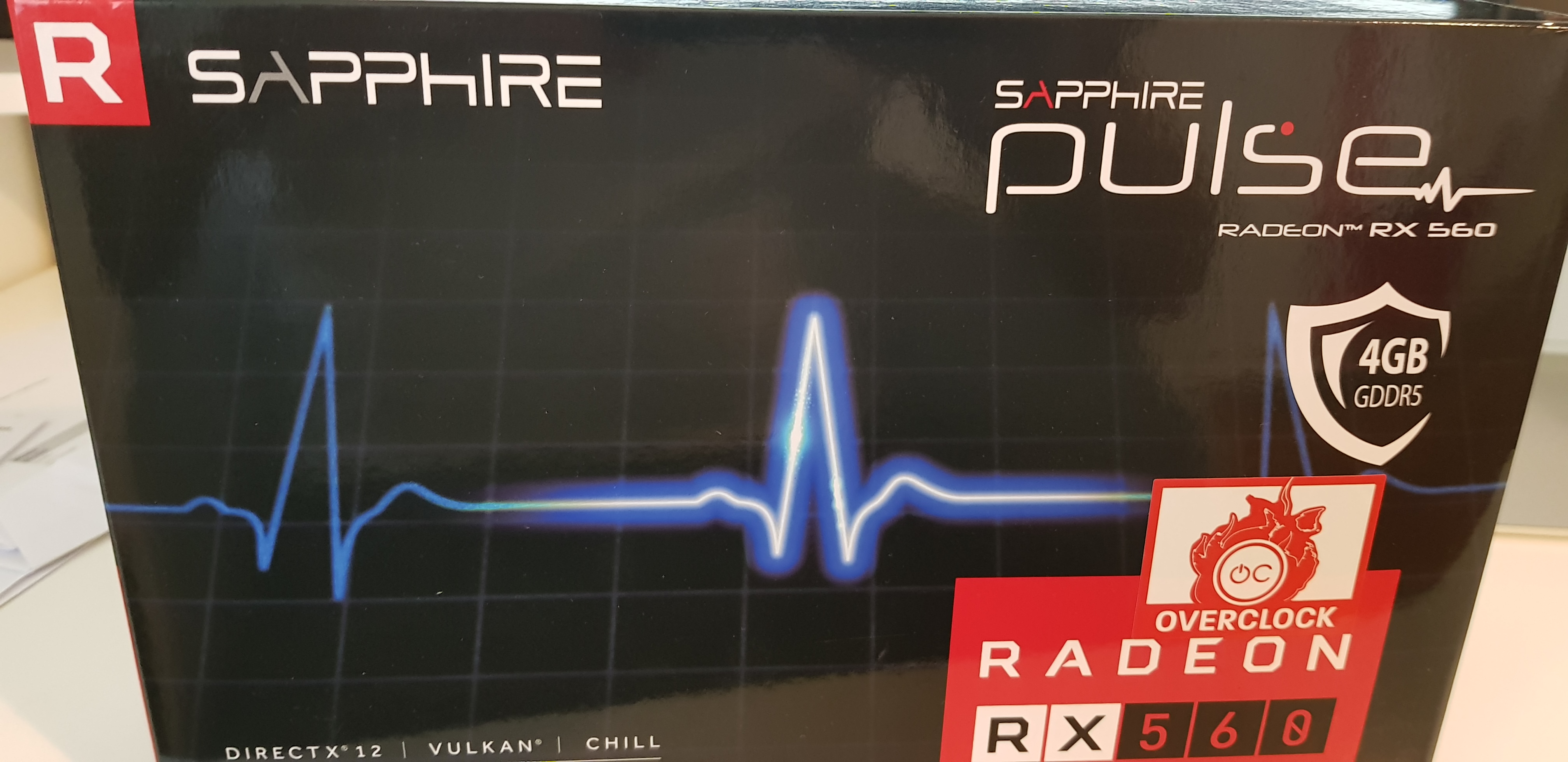

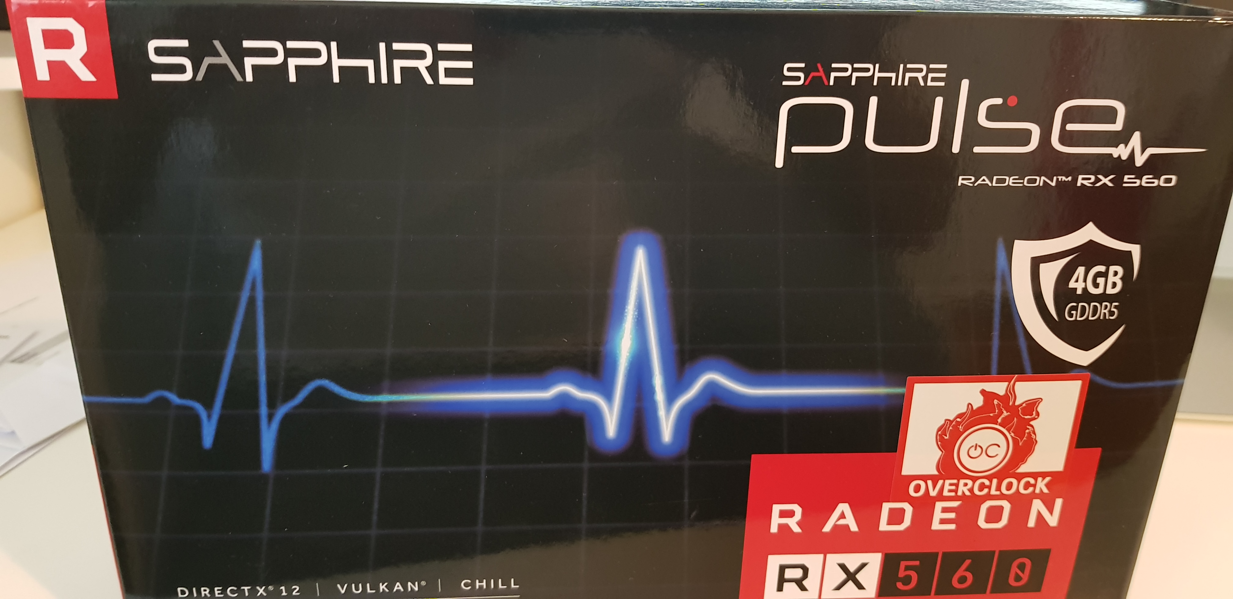

What's the exactly card you got?
Its the Radeon RX560 4GB. Attached a pic. Thanks

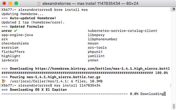

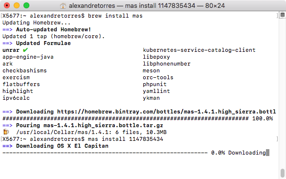

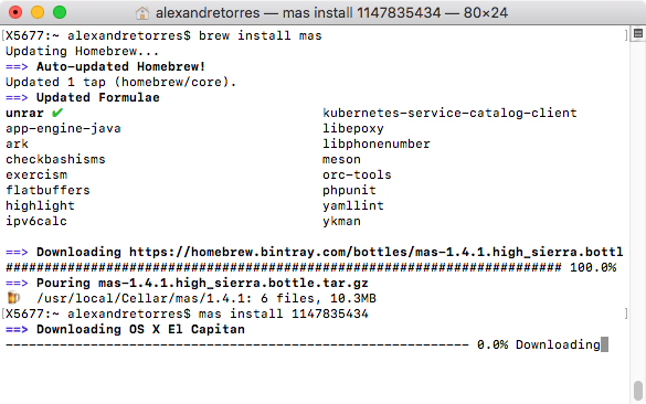

Mate sorry for the 100000 questions. I'm trying the homebrew but can't get the download going. Sorry man, appreciate your help
First you install Command Line Tools, then home-brew, then mas. You have to be logged on.
sudo xcode-select --install
So looks like I got them all installed but I cant see the command line to download el capitan. I must be missing something
OK so I tried on my old macbook pro and this time the store opened and asked for my password. That went ok but then it said I can't download as it's not available for this ID or was refunded or returned. So I guess I never downloaded it in the first place back in the day.
