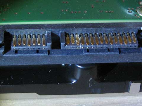

Just get a reply from Apple, they decided that my “HDD missing issue” is duplicated with another report (from another Apple user). So, obviously I am not the only one, and they know it already.
There is one way to make these non working drive work, but of course it breaks the warranty, so not good :/
For those who wants to know: cut the connection of pin 3 the on the power side of the HDD sata connection. It will cut the 3.3v that the Mac Pro send and that the HDD thinks is a "reboot" signal sent to the drive.
Manufacturers could fix it easily by including a jumper that when removed or put elsewhere does the same thing (open or close the pin 3/3.3v/reset pin)

I did come up with a better answer on the pin-3 (play-dead) issue. I did a writeup with pics at my regular digs, but the gist is: use Scotch tape to cover Pin 3 on the drive. It's easy, works like a charm, and doesn't void your warranty.
The idea came from something I vaguely remember from the AGP days. How to modify a 4x/8x card to work in a 2x slot. (the AGP fix required cutting a slot in the card edge, and taping over a pin.)
Just did a warm restart after today's High Sierra beta release. The tape-over-pin 3 trick didn't work with my two HGST Deskstar NAS 6TB drives (model no. HDN726060ALE615 and part no. 0F26700) - they didn't show up after the install. After shutdown and a cold restart, they showed up on the desktop
Yep, the tape-over-pin3 only addresses the SATA3.3 issue, which currently affects large HGST drives. Basically some 8TB models and larger. Your 6TB drive probably isn't affected by this issue.
If your large drive isn't detected after a cold boot, do the pin-3 tape trick.
If your large drive is detected after cold boots, but not restarts - try h9826790's trimforce tip, or use an external enclosure. No other solutions have turned up. Other than complaining to HGST and/or Apple of course.
