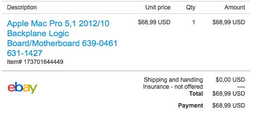

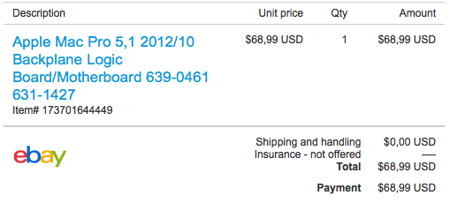

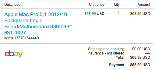

Next step is to replace the backplane, with some searching and without hurry you can get one from eBay around $70.
