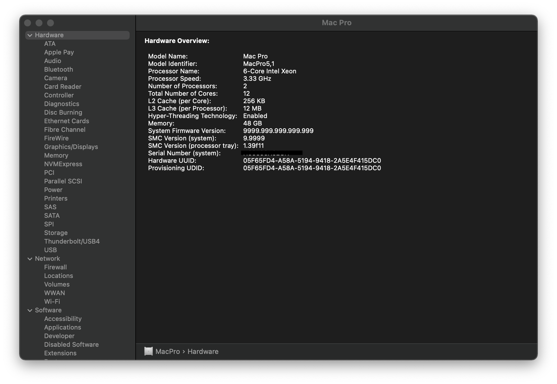

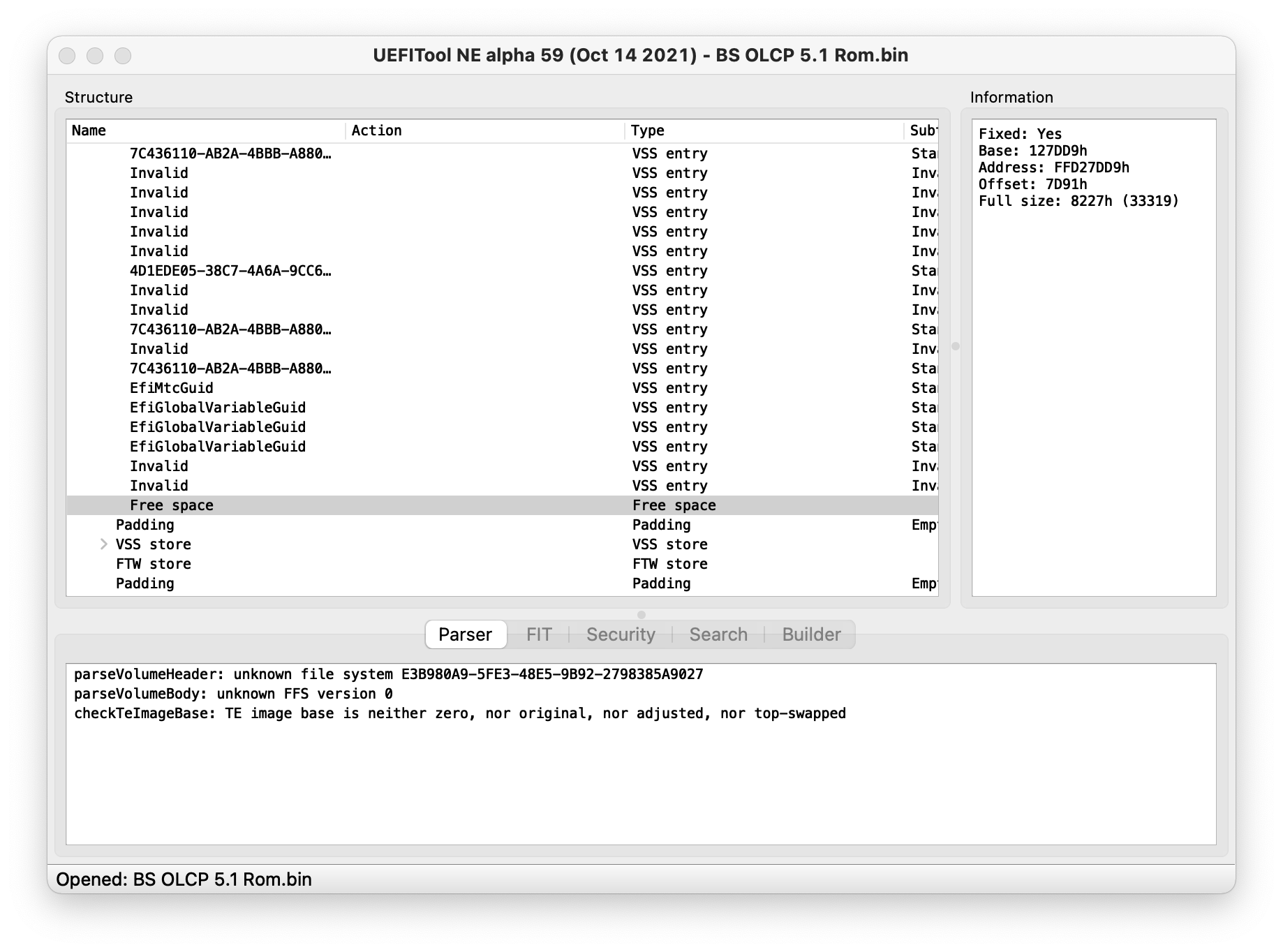

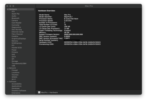

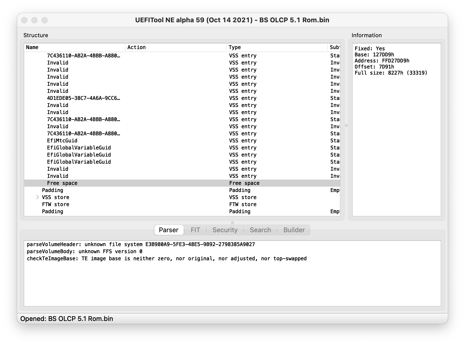

Bumping this because of late I have the same problem. Need to unplug the 5.1 for consistent booting. The system can boot day to day for maybe a week then will not boot until the SMC is reset. Ran the AHT extended, no errors except for the graphics card (expected). Currently running 11.7.2 w/ OLCP 0.4.11. I dumped the ROM and it look like plenty of free space, after a five chime pram reset. attached. Suggestions, recommendations appreciated. Thanks.

You should run ASD instead of AHT. If nothing is detected by ASD, then you can backup your BootROM image and try flashing 144.0.0.0.0 MP51.fd to see if the problem disappears. Some mid-2010s/mid-2012s have a problem with the BootBlock where sometimes you power on to a black screen, Apple solved it with the 144.0.0.0.0 BootBlock, but you can only install it via a BootROM reconstruction service, a catch-22.
If after flashing the MP51.fd, this issue is solved, you'll need a BootROM reconstruction service.
