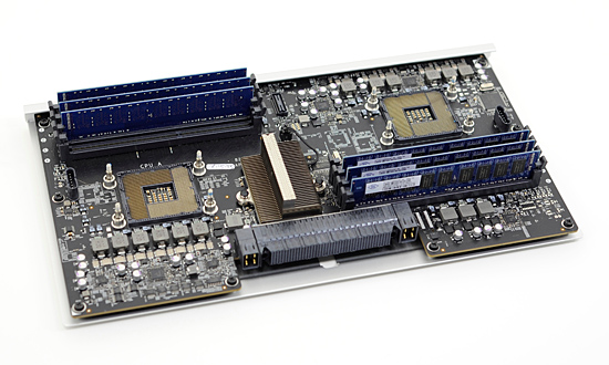

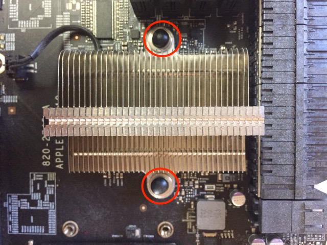

Could be an incident that in your Mac Pro a Northbridge heatsink rivet just broke?
The symptoms you described above look exactly like that (no chimes, fans spinning). Maybe it has nothing to do with your Windows installation.
Yes , i'feel that it has nothing to do with Windows, more a hardware stuff , how can I verify that it's broke?
Thanks

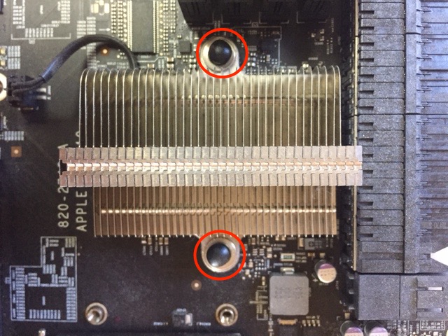

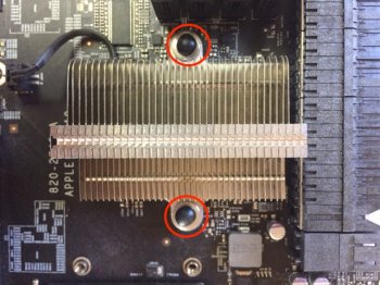

Remove the CPU coolers, if a northbrige heatsink rivet is broken it looks like that (happened to me): https://forums.macrumors.com/thread...ng-broken-northbridge-heatsink-rivet.2046462/
Example:
You need to reapply thermal paste when you install the coolers again.

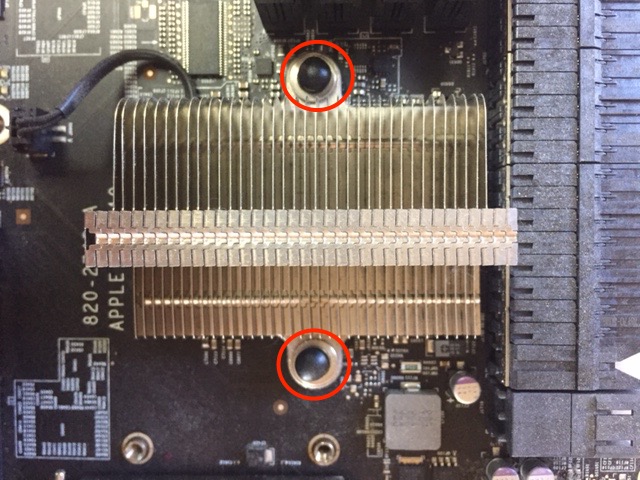

Example:

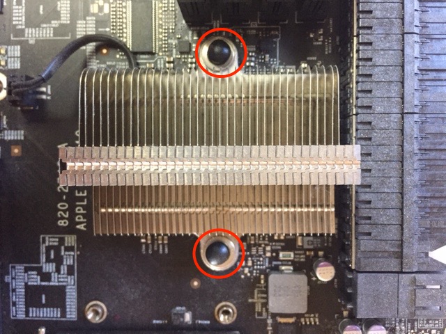

Example:

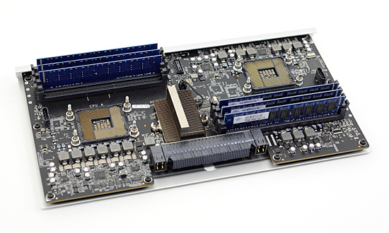

When i think about it, i got two CPU trails and they were both working, so it's seems unlikely that the NB of each CPU of each CPU trail went wrong at the same time, no ?

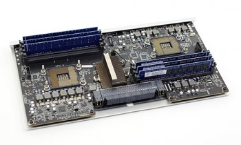

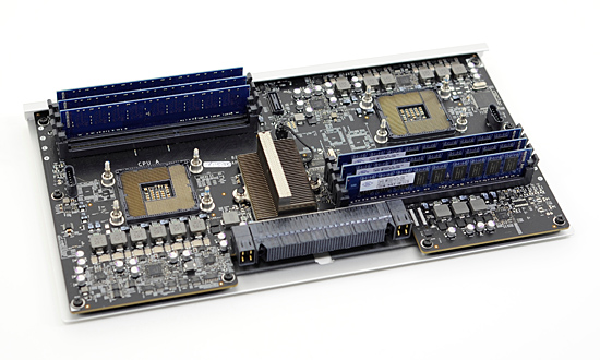

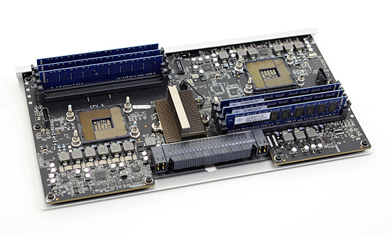

There is only one Northbridge, also on dual CPU board:
