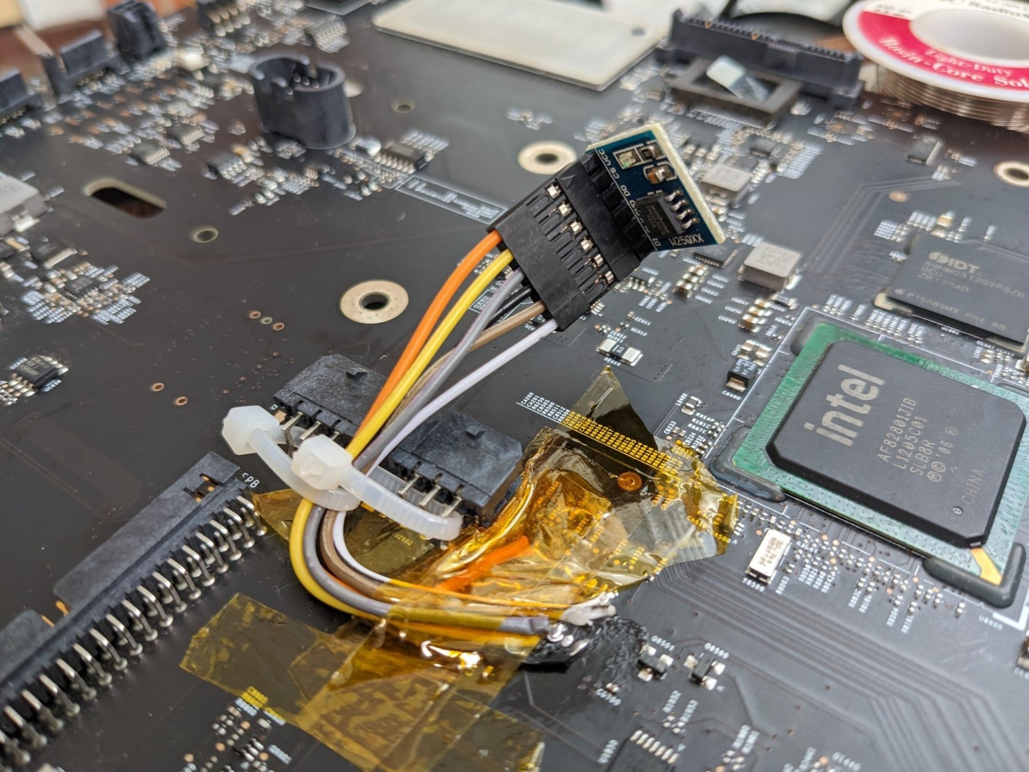

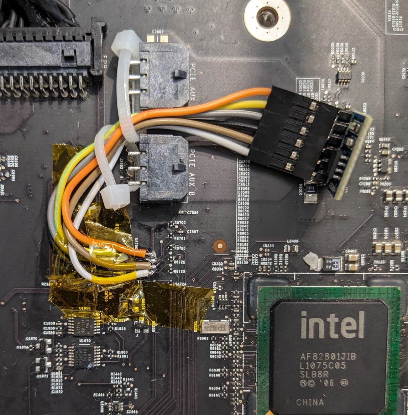

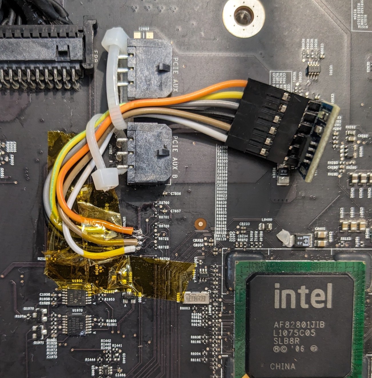

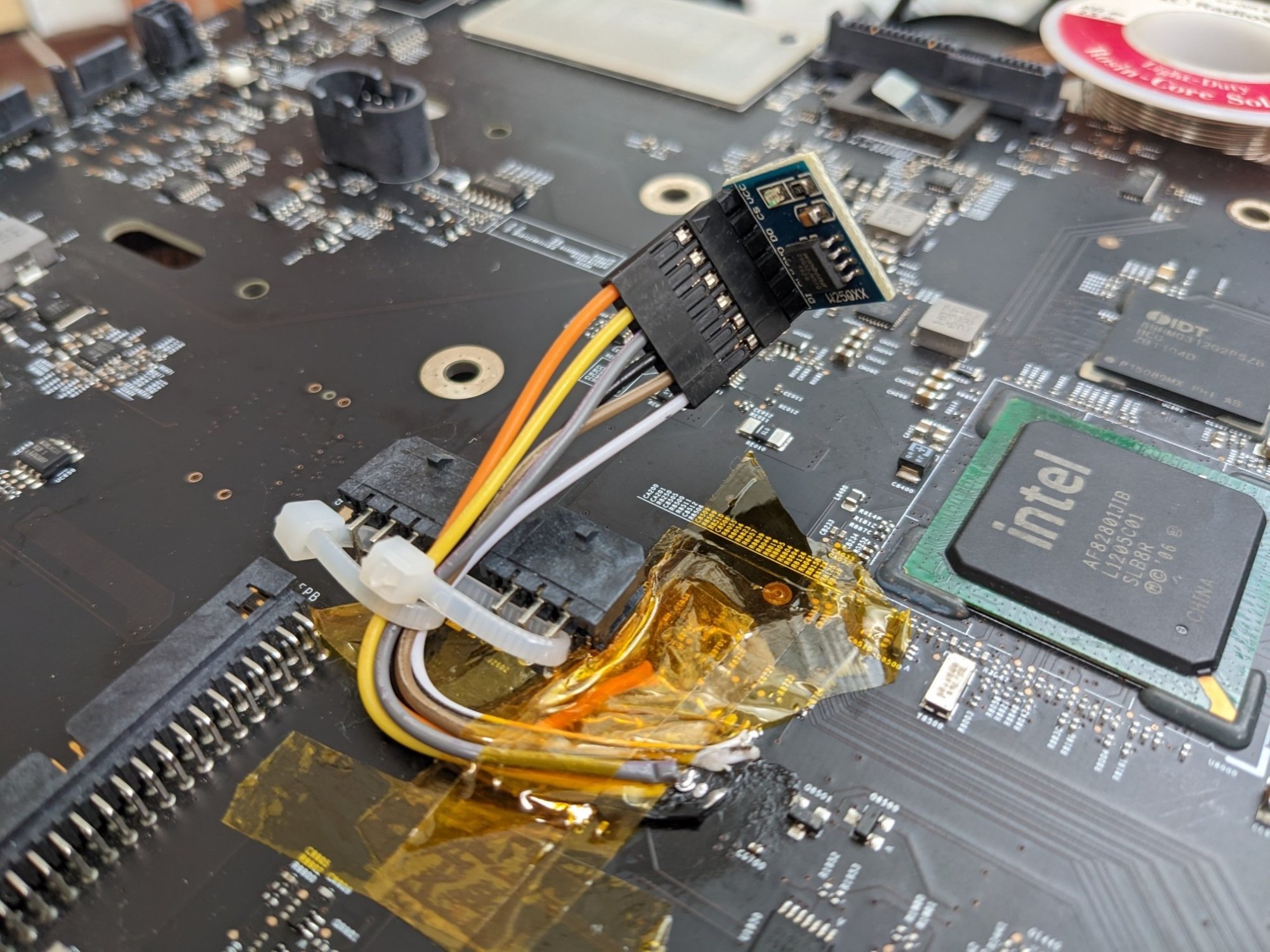

I suspect this "list" is essentially "unlimited", but I wanted to share my experience.

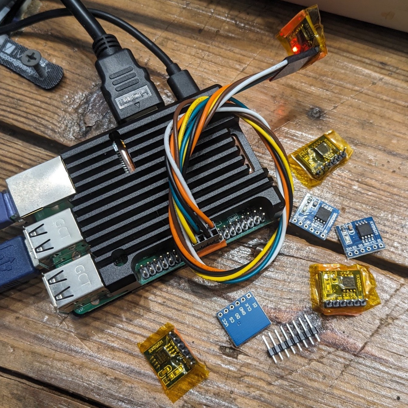

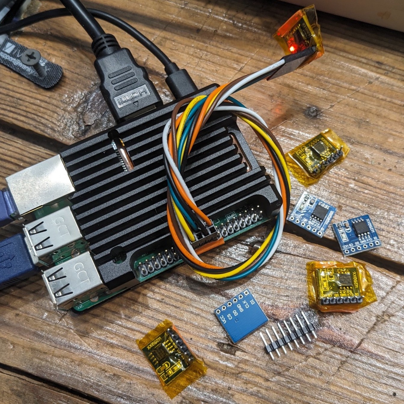

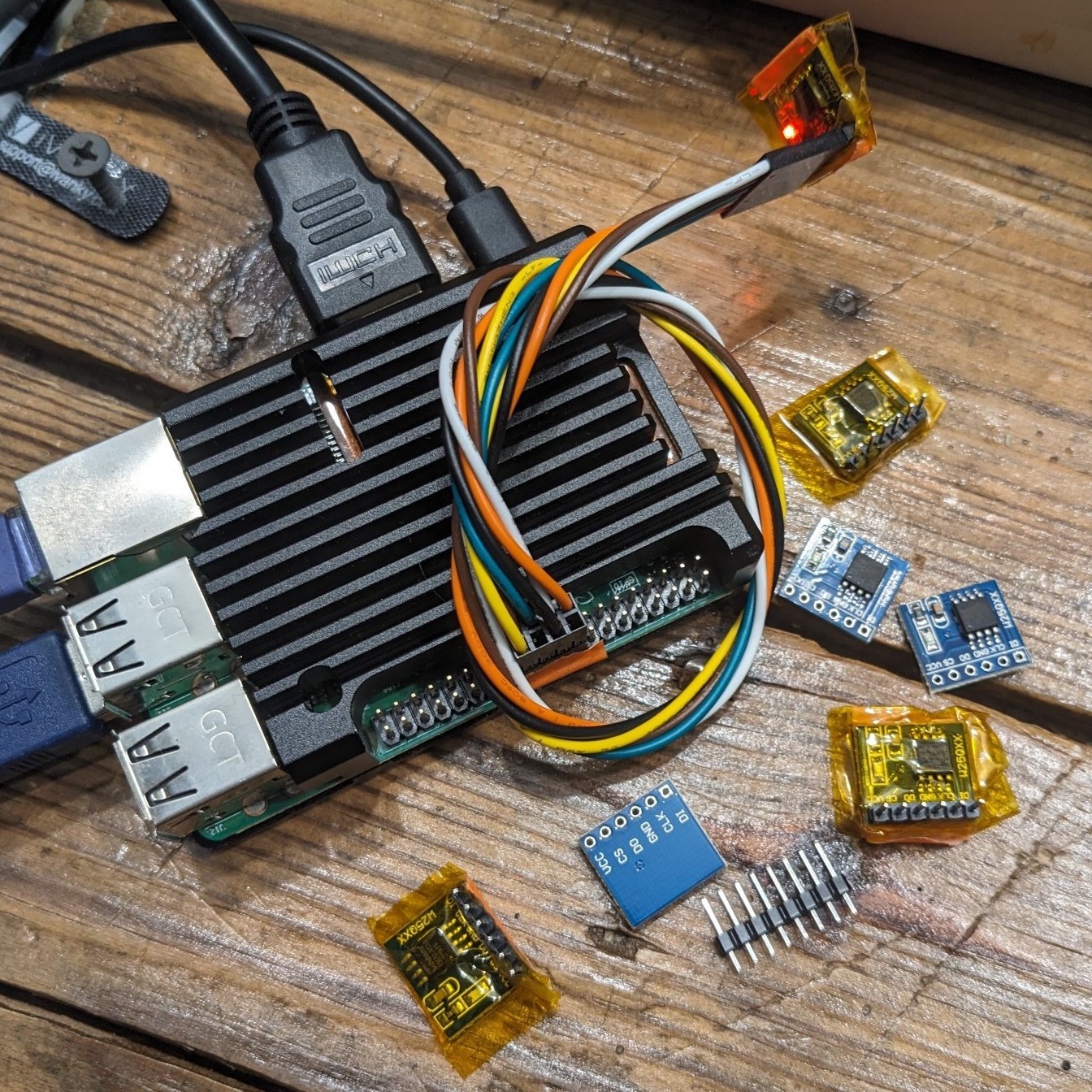

I corrupted the flash on my cMP 5,1. For technical reasons, it cannot be reprogrammed in circuit. I didn't want to ever be in this situation again, so I used some dupont wires to connect to a cheap Amazon SPI module (10 for $11) that could be easily swapped. I didn't know for certain the flash chip Winbond W25Q32 would be compatible, but I programmed the module with a RaspberryPi, plugged it in, and immediately got a chime!
Macschrauber's Rom Dump won't talk to it, but the module is easy to disconnect and reprogram offline. Food for thought...

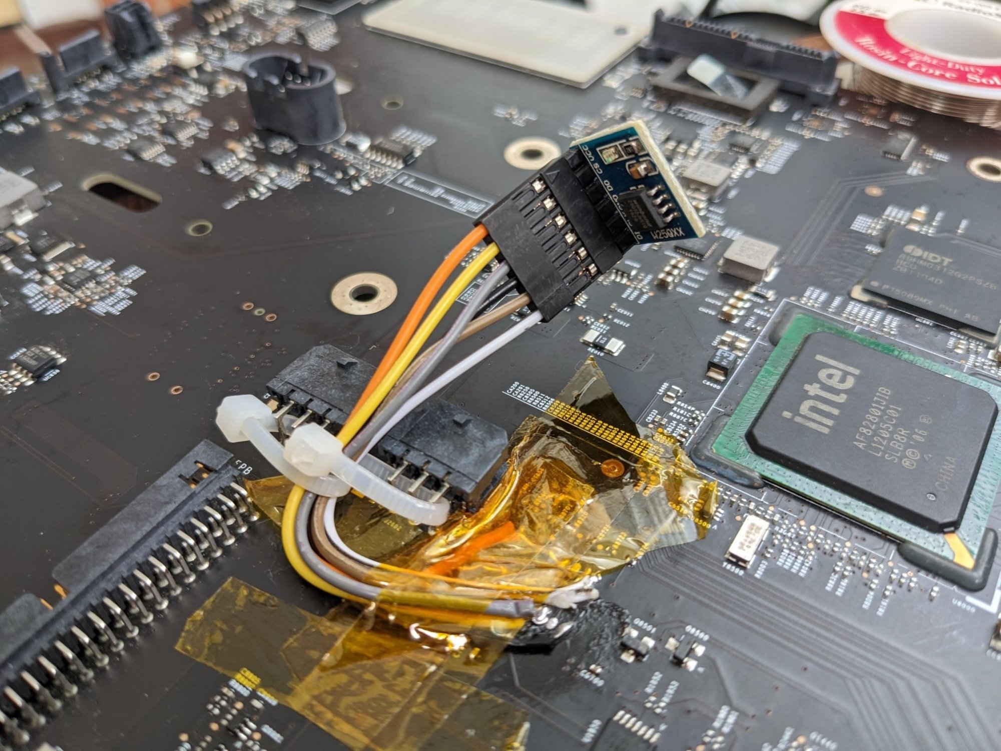

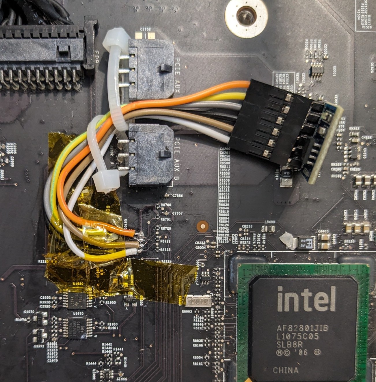

Just finished my 2nd box (both with bad SPI). NVRAM is saving just fine under 10.6 and 10.15, and otherwise no issues. The 2nd one turned out a little cleaner.
