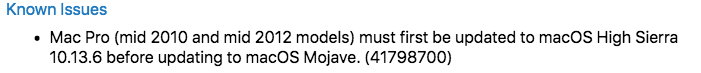

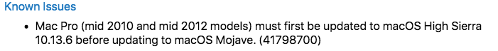

in-fact one of the known issues in the DP7 release is (I wonder if that bug report number matches anyones bug report here? :) )

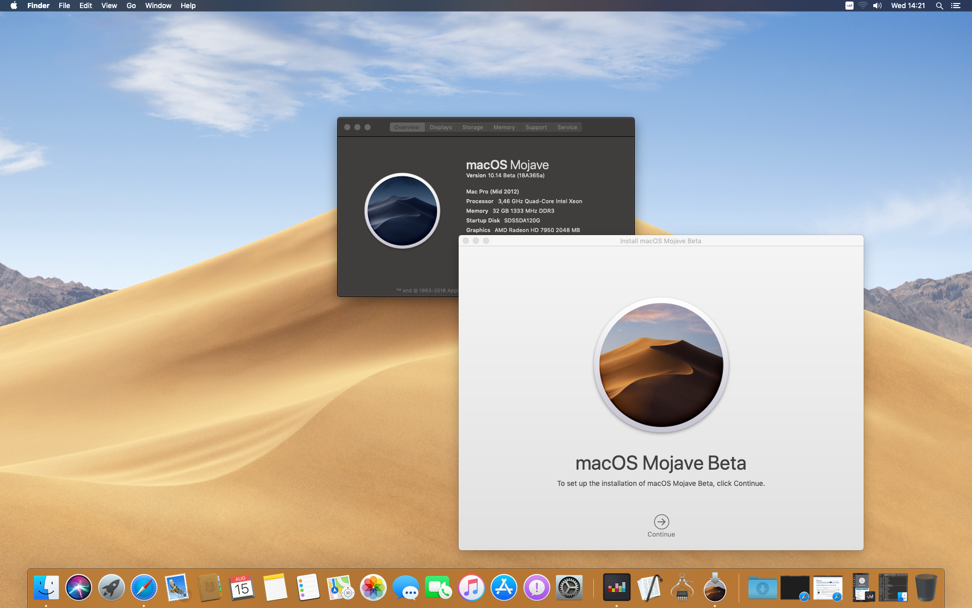

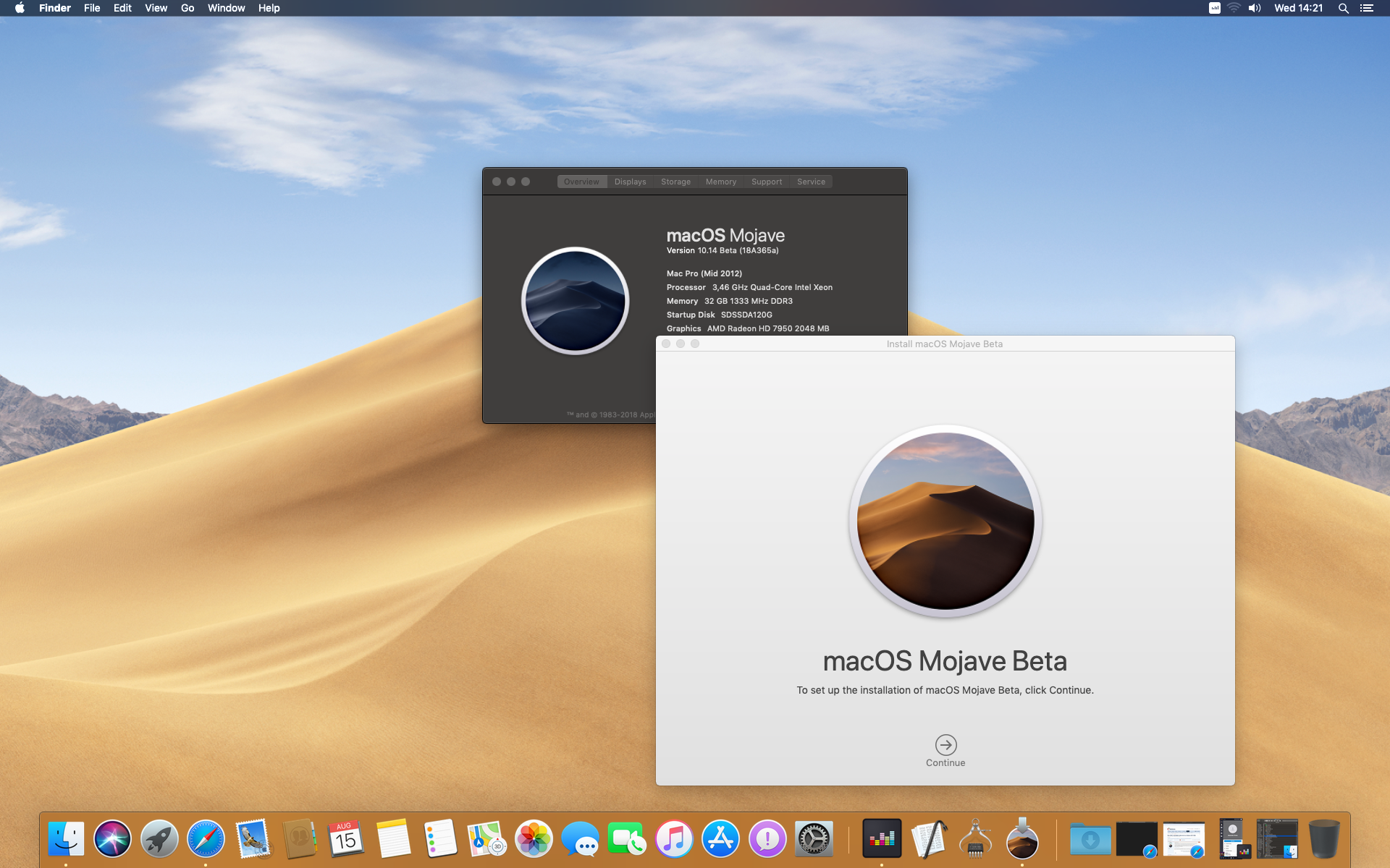

Like with @LightBulbFun, no problem with HD7870 flashed with HD7950 Mac EFI.

Like with @LightBulbFun, no problem with HD7870 flashed with HD7950 Mac EFI.View attachment 776129
Sorry, I am too lazy to search for the old post (especially I am just using my iPhone right now). Does the 10.14 give you the same METAL version for the 7870 as in 10.13?
From memory, the RX470’s METAL version will be upgraded in 10.14. That may be the difference.
