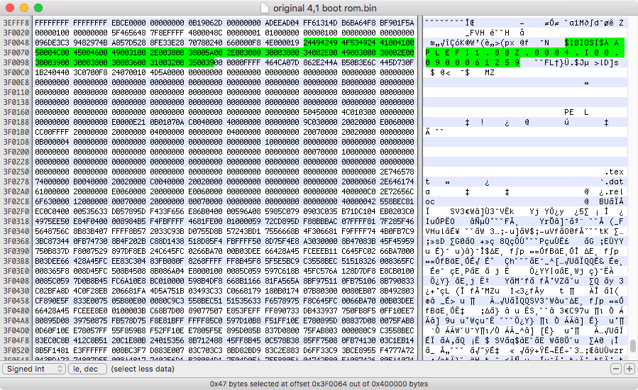

Checking dumps from MP4,1 that I cleaned/upgraded, found that one had a non public original BootROM version, probably B06:

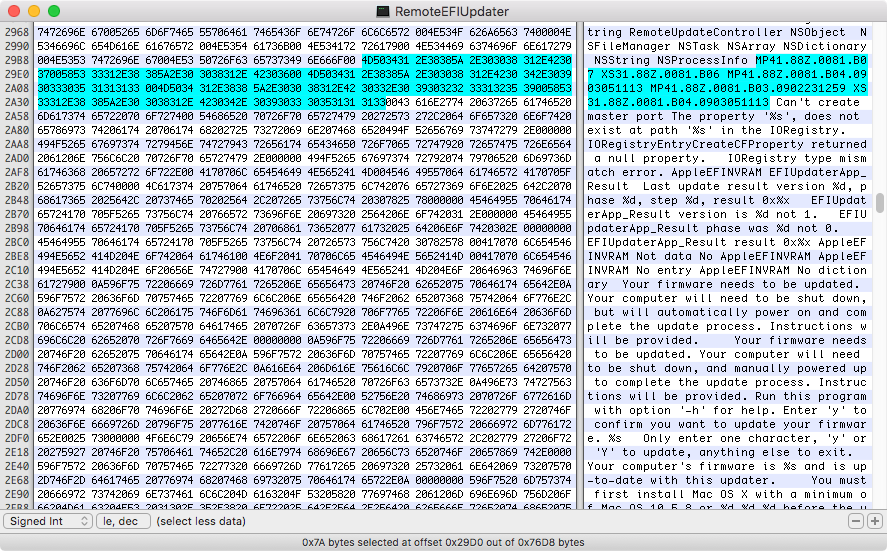

Know MP4,1 BootROMs:
  • MP41.88Z.0081.B03.0902231259 (B03)
  • MP41.88Z.0081.B04.0903051113 (B04)
  • MP41.88Z.0081.B07.0910130729 (B07 / EFI 1.4)
  • MP41.88Z.0081.B08.1001221313 (B08)
I don't have dumps from B03/B04, but those are listed in the efiupdater table:

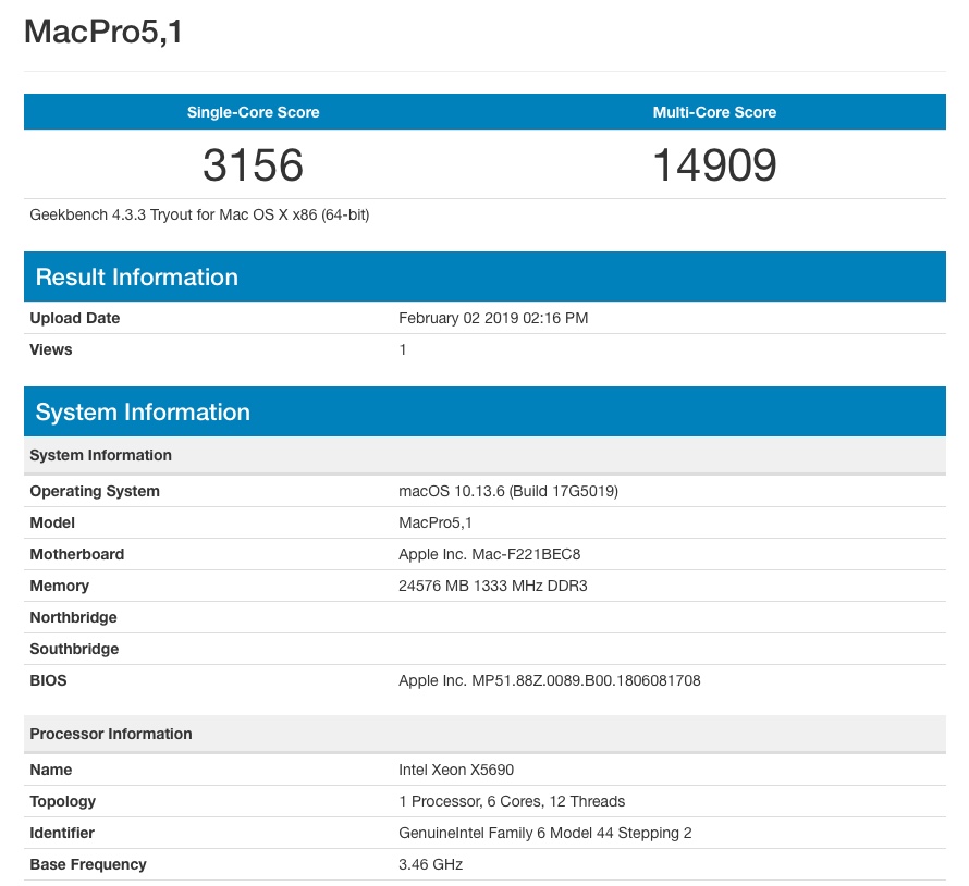

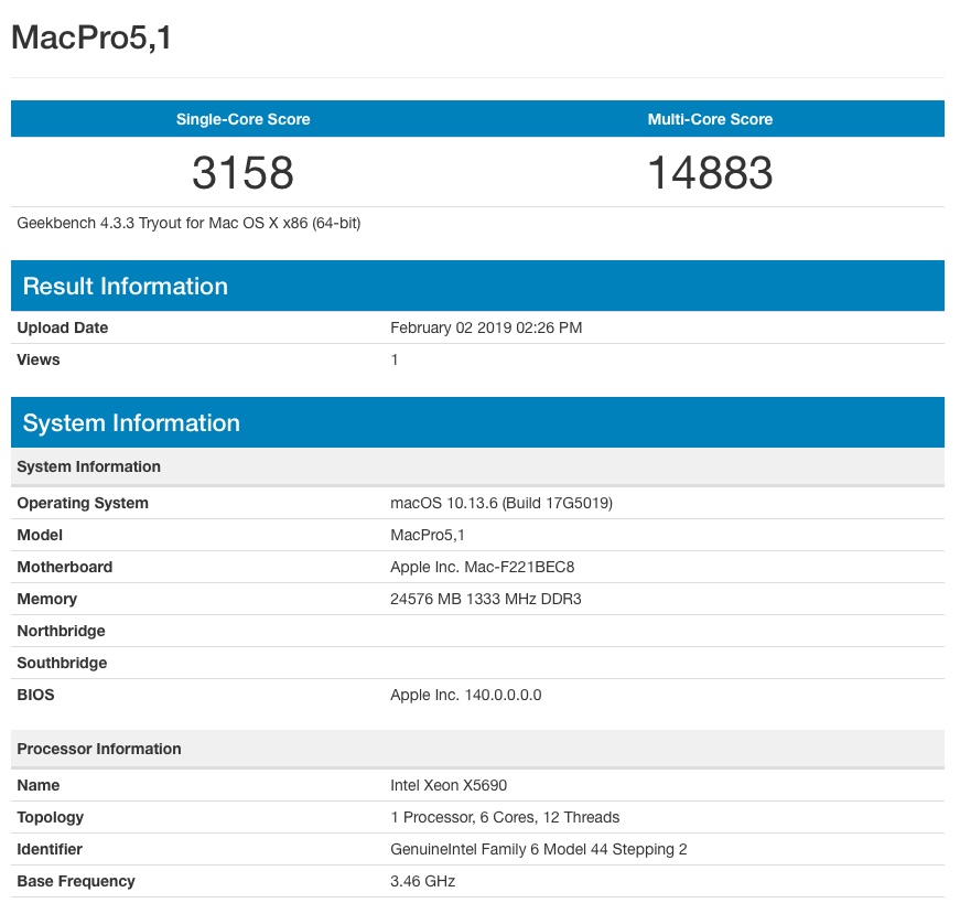

I just did the firmware update.
I pulled my GTX 980 and put in at GTX 680 knowing it had Mojave support (little did I know that I don't have to install Mojave)
Super simple update, I just downloaded the update from the App Store, it told me to do a firmware update..... Followed the onscreen instructions and BANG! done!
I did a Before and after screen shot of the system profile and a geek bench before and after just incase.
Not much change!
Happy days!

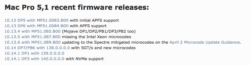

Read the first post again. Look at the bottom:

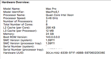

nicko3.0i
macrumors newbie
Feb 3, 2019
10
2
Verona, Italy
Just started the Mojave installer 10.14.3 (using Mojave 10.14.3) just to upgrade firmware .... 138 to 140. Using a RX480 non efi. Flawless process, just impossible to see anything on the screen. Properly rebooted and now it's 140 :-D
