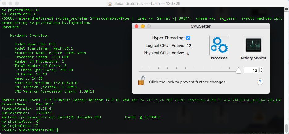

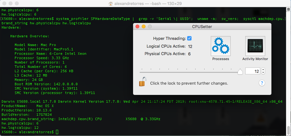

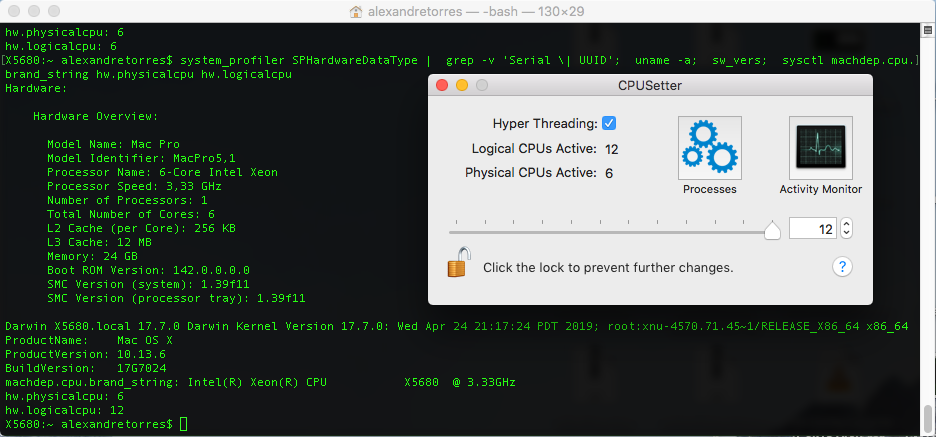

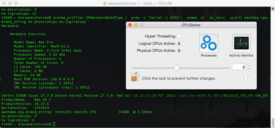

I just showed that the security updates are linked to 144.0.0.0.0 and don't work without it.

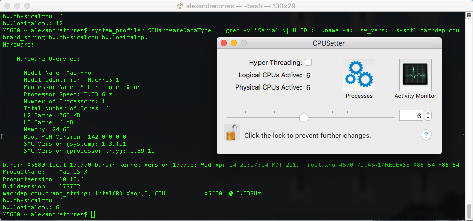

Seems to work, but it works AFTER the macOS is fully loaded while Apple SMTDisable NVRAM setting works at kernel time. This need to be fully understood.
View attachment 837595 View attachment 837596

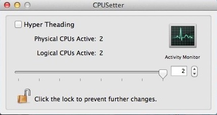

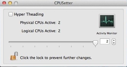

Cool I was literally typing this exact question but I didn't read all the newest posts at first. I was wondering if there was a difference between using terminal commands to disable hyper threading vs. using an app such as CPU Setter
oh I wanted to add if someone is on an earlier bootrom than 144 the app CPU Setter will work for disabling hyper threading. when I was on earlier bootroms this app always worked for me for that function at least
