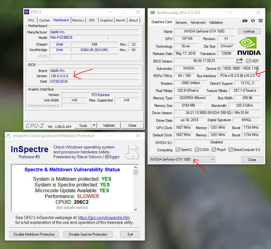

Okay, I did some benchmark testing pre bootRom patch and after.
My specs
  • Mac Pro 2010 5,1
  • 12 core X5690
  • Sapphire Nitro RX480 4GB
  • 48 GB, removed two sticks to get tripple channel
  • Bootrom 89
  • Mac Os 10.13.6
  • Windows 10 Pro 1803
I ran the following benchmark apps on Mac OS and 1 on Windows 10 (1803), I did 3 runs pre and 3 runs after.
  • Unigine Valley
  • Cinebench R15.038
Now that 5GT/s is enabled I get better results, not a big difference, but still some.
However under Windows GPU-z it still reports as pcie 1.1 After a complete shutdown it reports 2.0 speed.
Unigine Valley (Mac Os)
Pre Bootrom
Post Bootrom
Cinebench R15 (Mac Os)
Pre Bootrom
Post Bootrom
Unigine Valley (Windows 10 Pro)
Pre Bootrom
Post Bootrom
I think cpuz shows 1.1 as long as there is no load on the gpu. Reopen cpuz during a benchmark perhaps it will show 2.0.

The spacey thing on the right of the screenshot is a function of GPU-Z where it fully utilize the GPU. After a complete shutdown of my Mac it reported correctly to 2.0.
I updated the screenshot.
