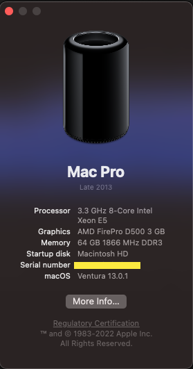

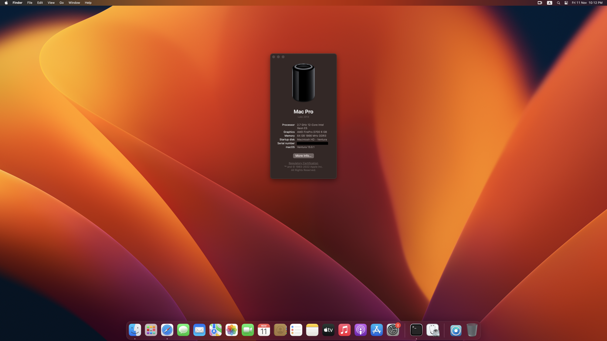

Success

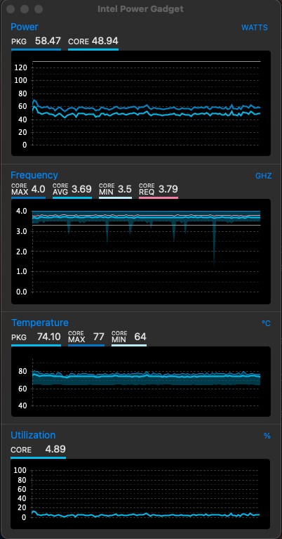

The other week I had installed Ventura on a spare SSD I had (the original 256GB one that it came with) in my Mac Pro 6,1 and while it worked fine, I noticed the Intel Power Gadget app was no longer showing me any data, I presumed that was due to the lack of CPU management. I today upgraded my main NVMe to Ventura (in-place upgrade) with the nightly 0.5.2 build of OCLP and it's not only running great, but the Intel Power Gadget now shows me plenty of data. This is working really well.

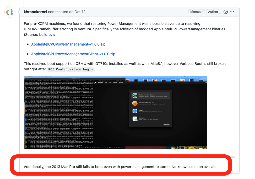

The MP6,1 with D300 is/was additionally problematic: 2013 Mac Pro and macOS Ventura Boot Issues #1009

Power Management was not addressed yet, it's just showing the CPU info with Intel Power Gadget now. If PM/SpeedStep was working, @KD7IWP CORE MIN should be 1.1GHz with the screenshot below:

Oh, ok, thanks for clarifying. I didn't realize there was still more to it.
The section I quoted was from Broken Power Management on Ivy Bridge and older.
The workaround for this issue above was booting as a VM bypassing the missing power management, AFAIK, no changes for MacPro6,1 yet and no SpeedStep support (when SpeedStep is enabled and working, the CPU clock can go as low as 1,1GHz).

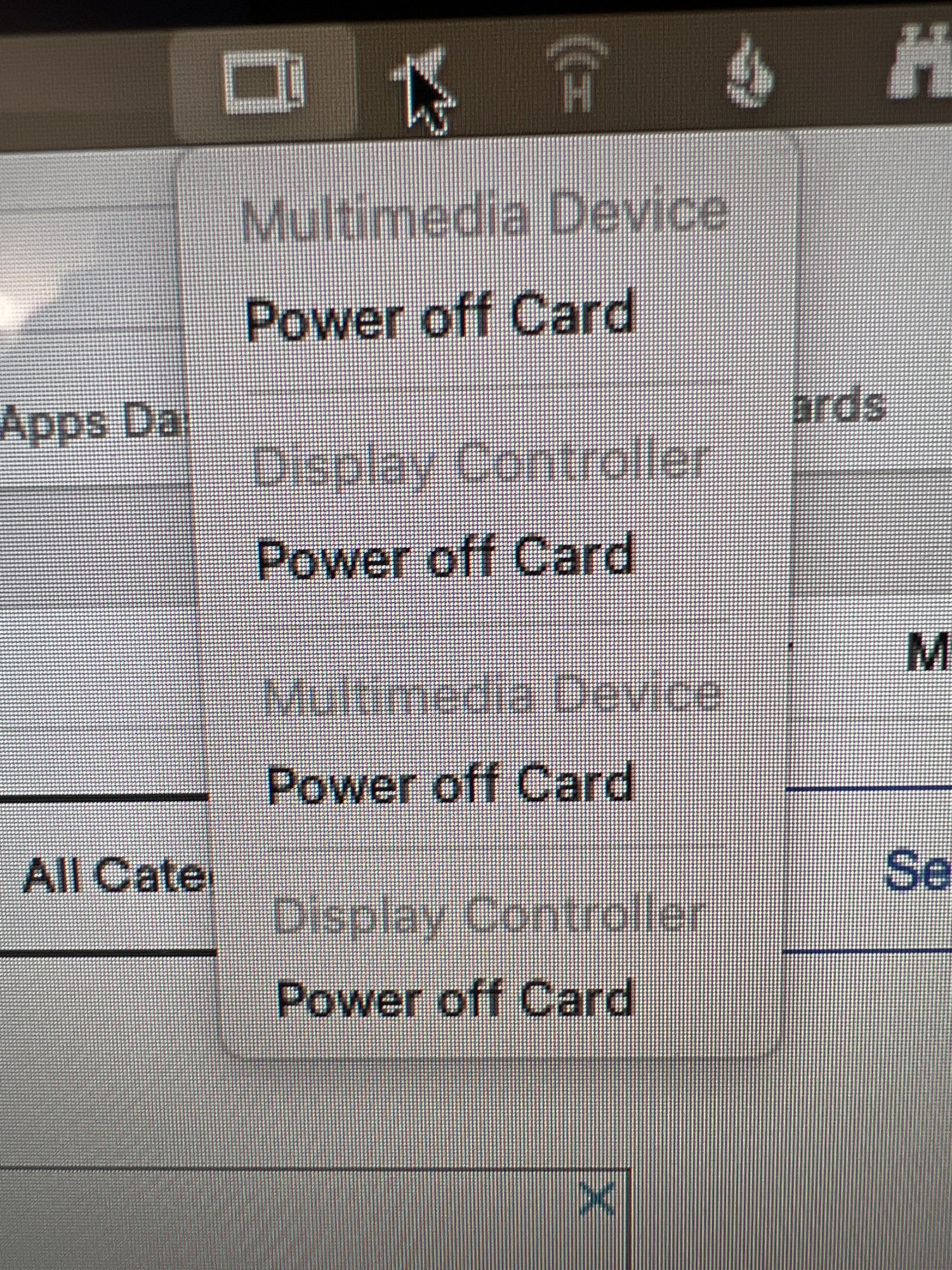

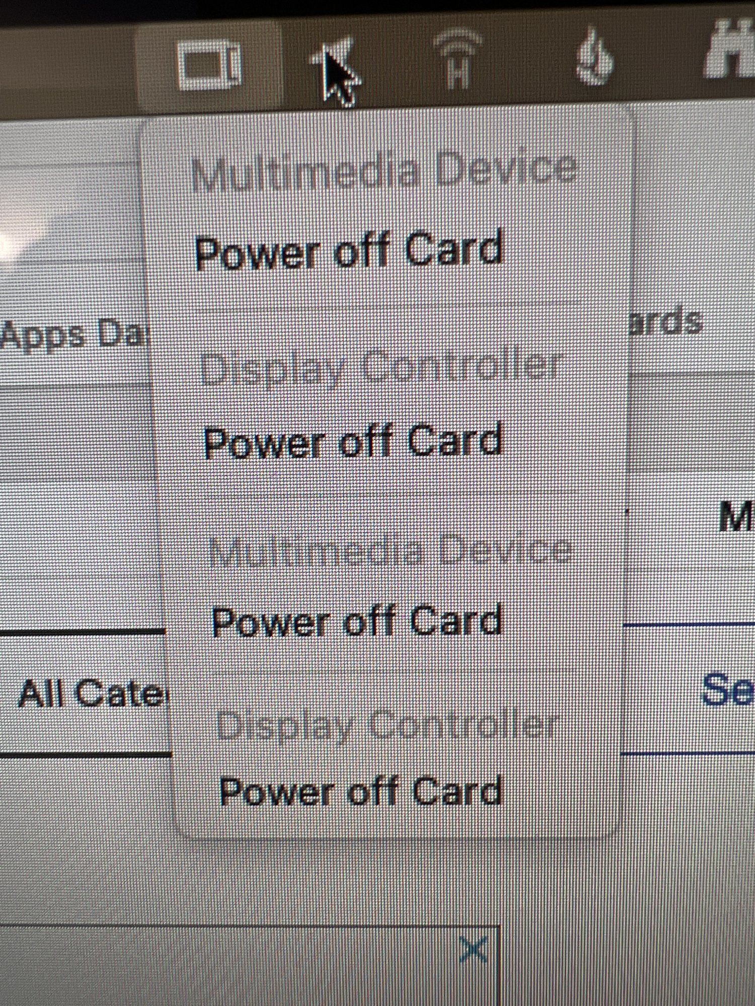

I ran OCLP on my 2013 tonight. Pretty much flawless installation and went off without a hitch. So far it works great. One new thing I see is an icon in the upper taskbar is what looks like a PCIe slot card from the early days of MacOS X. Is there a way to hide this? I’m assuming it’s seeing the GPUs as their PCIe connections.

I ran OCLP on my 2013 tonight. Pretty much flawless installation and went off without a hitch. So far it works great. One new thing I see is an icon in the upper taskbar is what looks like a PCIe slot card from the early days of MacOS X. Is there a way to hide this? I’m assuming it’s seeing the GPUs as their PCIe connections. View attachment 2133640
I’ve been wondering what that is for as well. It’s been there ever since I did the upgrade.
I believe it's detecting it as PCIe. Also how are you finding it? Is the no DRM and CPU Management I presume the fans are always kicking off?

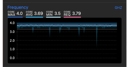

It’s working great! I don’t ever do anything that needs DRM so that is not an issue. I think I posted earlier in this thread with a phot from the Intel Power Widget that shows the processor speed still changes (Turboboost). Someone replied that it never throttles down below its minimum 3.3ghz though, without power management. It is possible it runs hotter than previously but I have Macs Fan Control running since I don’t like it getting as hot as it does out of the box (especially because I had to reflow one of the D500s and I’m hoping keeping it a bit cooler will let the GPU live longer). I wouldn’t go back!
