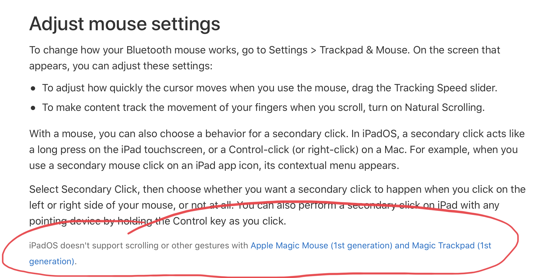

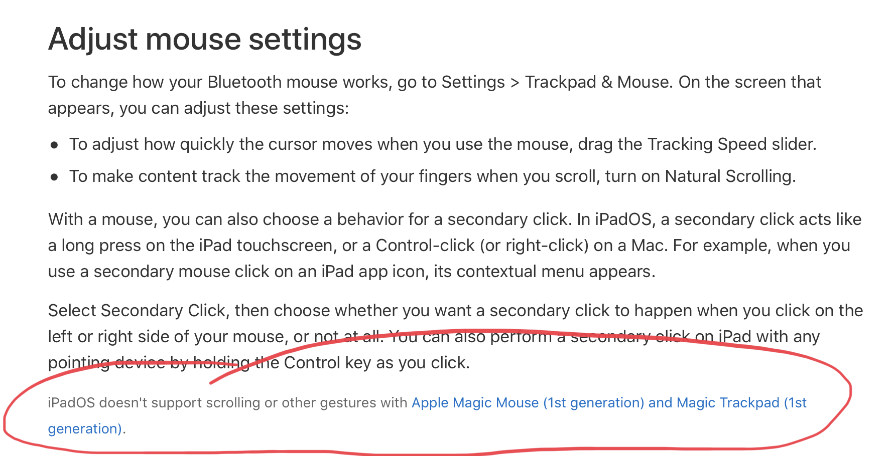

Ok, I talked to one of my Apple buddies and he said M1 and TP1 does not support scrolling. I went looking around on Apple’s website and found this...
So, not a bug, unfortunately.
This is very sad, and just confirmed accurate, unfortunately. Horrible implementation. No reason MM1 shouldln’t be able to scroll. Useless feature addition for those of us with MM1 or MT1.
I'm in the same boat with all of you regarding the revelation of Magic Mouse v1 incompatibility in iPadOS 13.4. I just complained to them about it at apple.com/feedback. Feel free to unload on them about this seemingly anti-consumer practice of artificially phasing out hardware like this. Hopefully if they hear enough of our fury, they'll include support for it.
