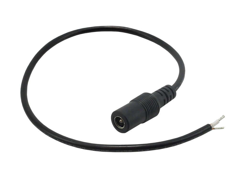

I have a 2009 17" MBP. Still works great, but I am on my 5th Magsafe L adaptor (after the demise of my 3rd T adaptor). At some point it would be cheaper to buy a new laptop than to keep replacing these pesky magsafe cables. So I had a stupid idea for a stupid hack, and was hoping someone might have an idea to make it work 🙂

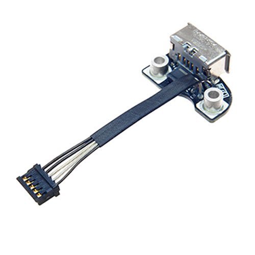

The dc-in magsafe board has two black wires, two white wires, and a green wire. I'm assuming black wires take 18.5 volts, white is neutral, and green is ground. I'm probably wrong; it's been painful finding a post that says what voltage runs through each line.
What I want to do is clip those wires and connect a female barrel pigtail to them, leaving the barrel hanging outside of the hole where the magsafe used to go. Then I could use a regular 18v charger from a Dell or HP or something. They're thrown away all the time. Magsafe 1s are getting harder to find....

So, I'd like to just skip the magsafe aspect alltogether. I've got quite a collections of white bricks (differing weights, differing shades of white!) with headless wires hanging from them. It's the magsafe end that frequently fails. So, why not remove it from the equation?
Based on the information in the wikipedia, Magsafe requires some negotiation logic with the computer's power controller. The middle pin is used for information exchange. If you tinker with that stuff and get your wiring wrong, you will most likely fry your logic board.

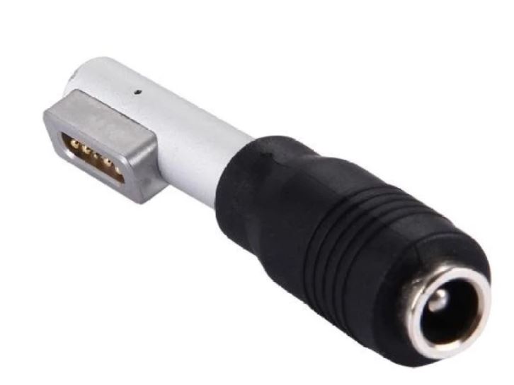

I saw this for about $12. I'm sure it messes with the one-wire protocol, but I'll give it a try, first. I'll first put a male barrel on one of my headless magsafe bricks. If that doesn't work I'll try a different manufacturer. And if it lights a fire, well, it is a 2009 laptop; I get it (we buried a 2005 last year).
Thanks! And, if anyone does know which wires do what on the actual DC-In board, I am still interested.

I knew I'd be sacrificing the one-wire protocol. Basically there'd be no more switching, just a constant higher voltage. That shouldn't hurt the logic board, but if any of the circuitry on the DC-in board controls signals or cleans the power or any such thing, bypassing that might kill the board.
It's interesting how many online schematics there are for the magsafe adaptors, but not so much for the dc-in boards. Probably because they don't die at the rate of the white bricks.

Just wanted to thank everyone for their contributions. Should my MBP turn into a working Frankenstein like thing I'll be sure to come back here and share how it went. But first I'll try that barrel adapter that goes on the outside of the machine.
