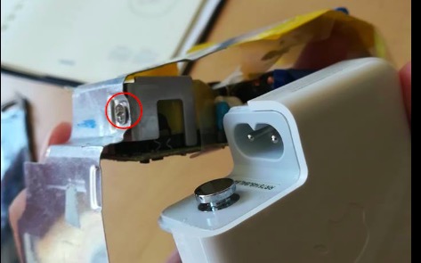

So a few days ago my charger stopped working and I assumed it was due to a cable malfunction as it often is. So I bought a new cable, opened the charger up and started to notice some weird things.
First of all,

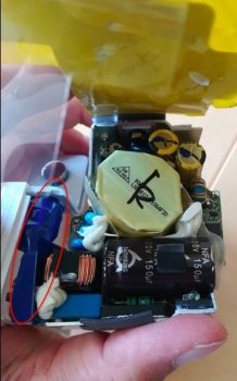

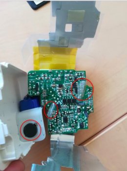

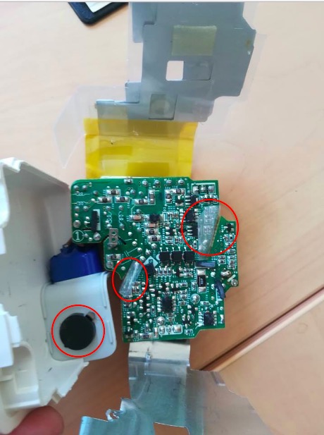

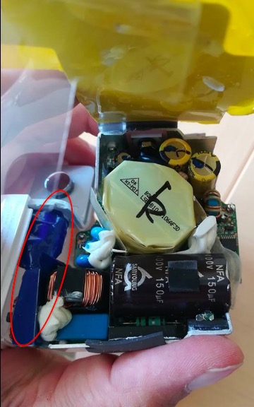

-I noticed an unusual amount of duck tape/isolation tape or plastic things pretty much everywhere

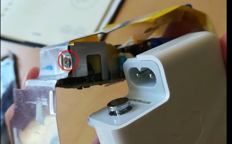

-The aluminum piece that surrounds the circuit board happens to be screwed on the circuit.
After taking a closer look I noticed that the ground pin was not connected and as I grabbed the circuit I took two strong discharge even though it was unplugged for a couple of minutes. Some component happens to constantly emit some kind of strong electrostatic discharge.
So I bought this charger in a computer store and paid for an apple one.
Is there any chance this might be a fake?
Thank you for your answers.

Honestly you are really luck something worse didn't happen with jerry-rigging that is inside that charger. It could very well be a fake, but either way looks like it is time to buy a new cord.

If the ground pin is not connected to anything it's definitely fake or tampered, apple ground pins are always connected inside charger.
