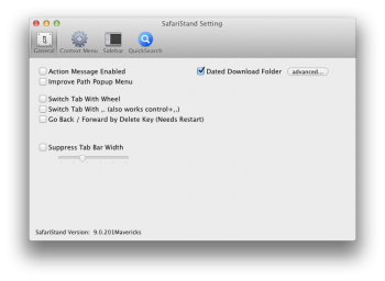

EDIT: actually, would you mind pointing to that setting please? I downloaded SS for Safari 9 on Mavericks but all I can see is a width of a tab, but no resize options for address bar

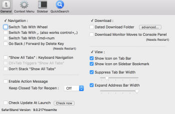

You need to update to the latest version (check my screenshot) although if you're still on Mavericks then you enjoy living in the past and the latest version may not work 😉 Don't worry, once you have SIMBL running then updating SS is easy.
It works - instructions in the github link I gave above, about half way down the thread. Look for the contribution:
"norio-nomura commented on Jun 30, 2015"
or just click on the date above as I seem to have cleverly pasted a link without realising 🙂
Thanks for the help, appreciate it! This 'feature' was driving me nuts, it works like a charm now... few more days and I'll be moving to EC fully 🙂
