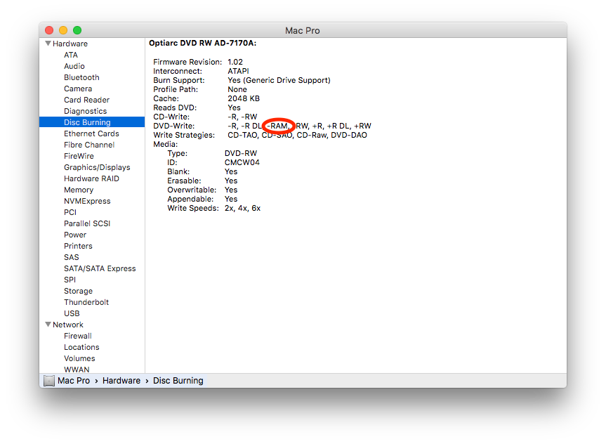

I've got a different problem with my Optiarc (a.k.a. SuperDrive) – it can write DVD-RWs, but is incapable of reading ones which already contain data. After around 20 secs of attempting to establish what the disc is, it simply states that I've inserted a blank DVD-RW!
Searching for the solution online brought me to this thread, and whilst it hasn't solved my problem, I thought I'd mention that whilst flashing the firmware, and attempting to change the booktype of DVD-RW to DVD-ROM, the drive has gained DVD-RAM writing capability (see screenshot).
I also had the same pitfalls as the OP with necflash claiming the firmware I was using didn't contain the expected bootcode for the drive, but eventually I found a version which actually works; I have attached it here as a ZIP file (102cbt_rpc1.bin.zip)
