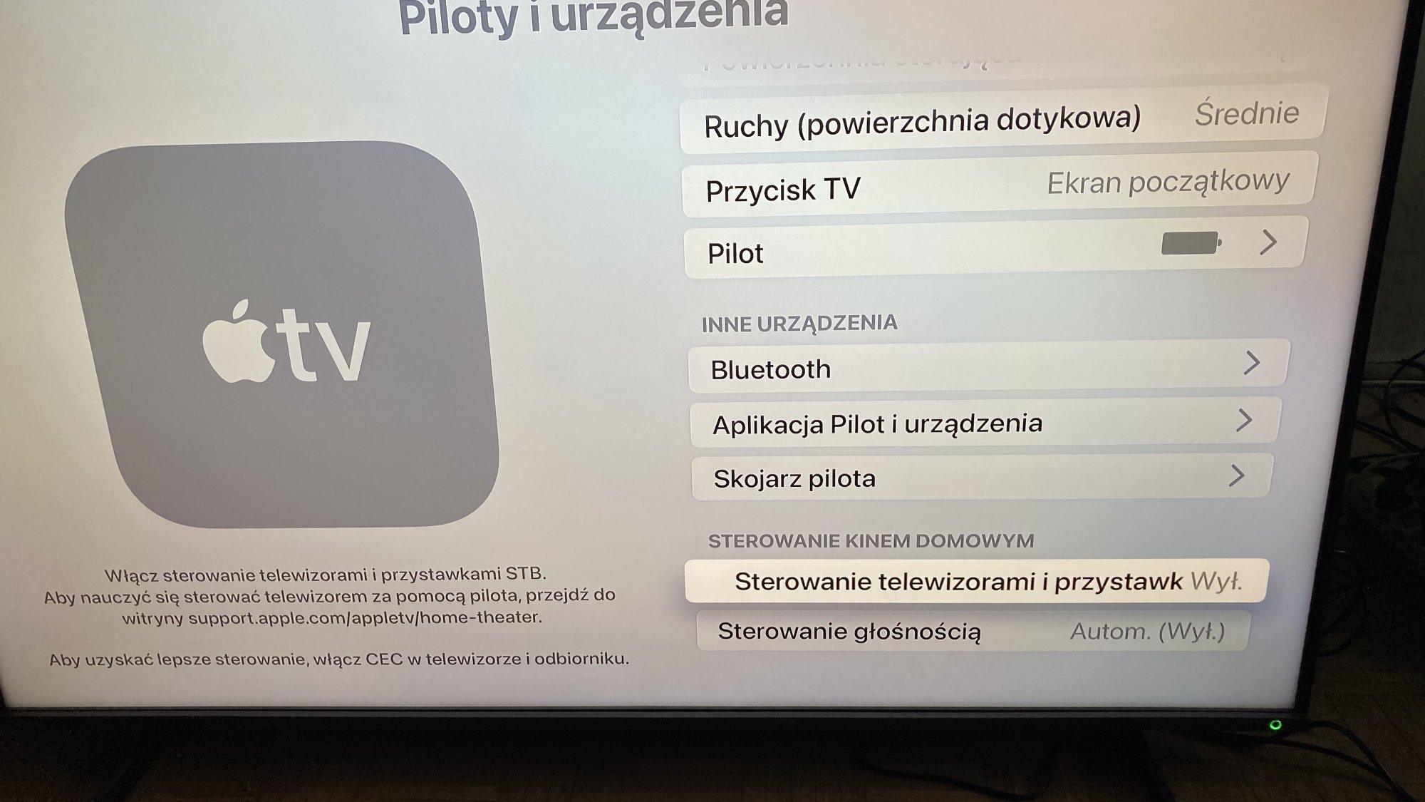

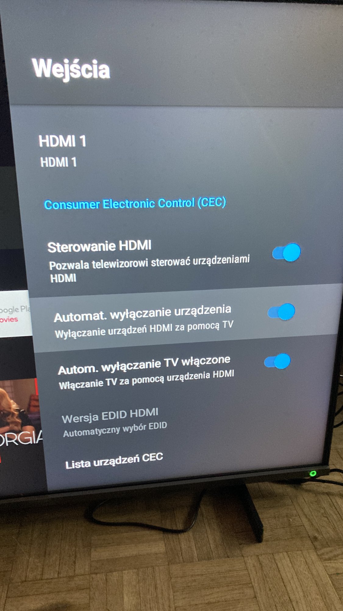

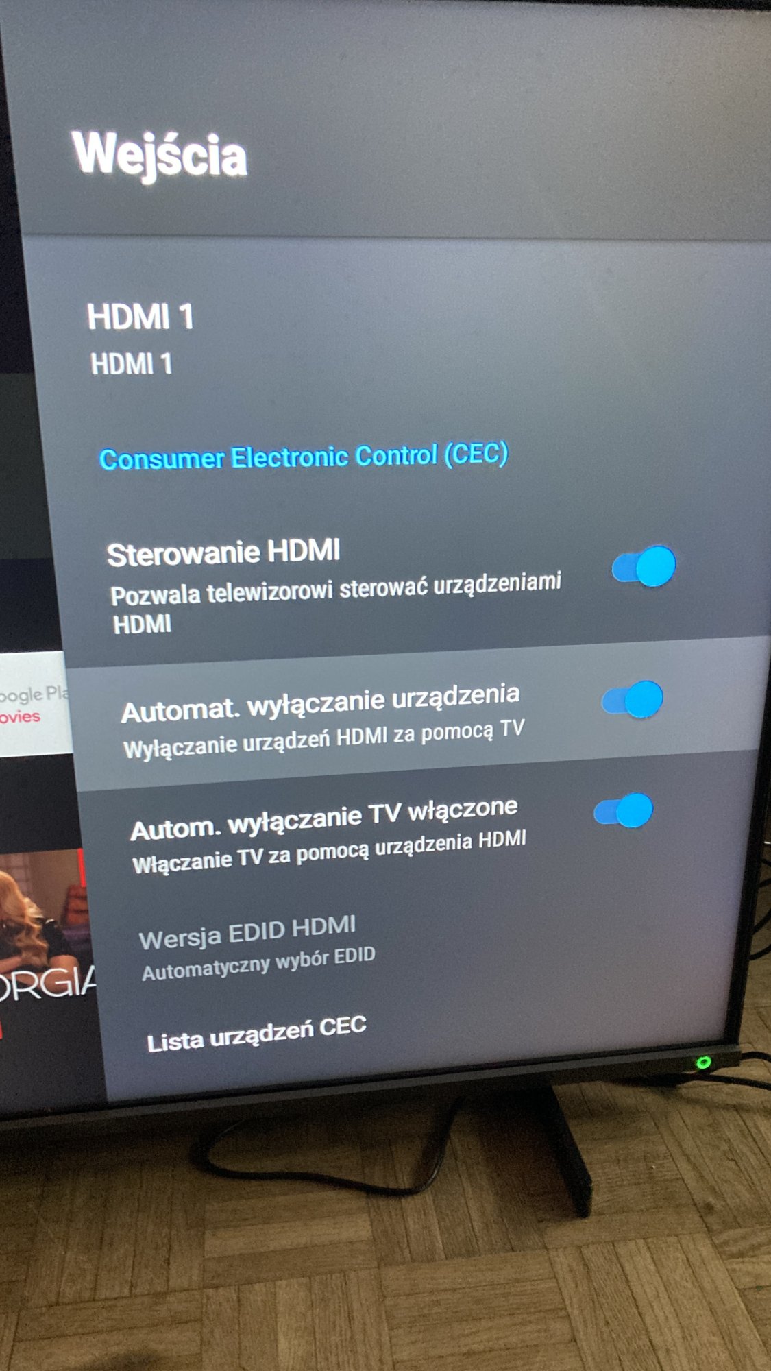

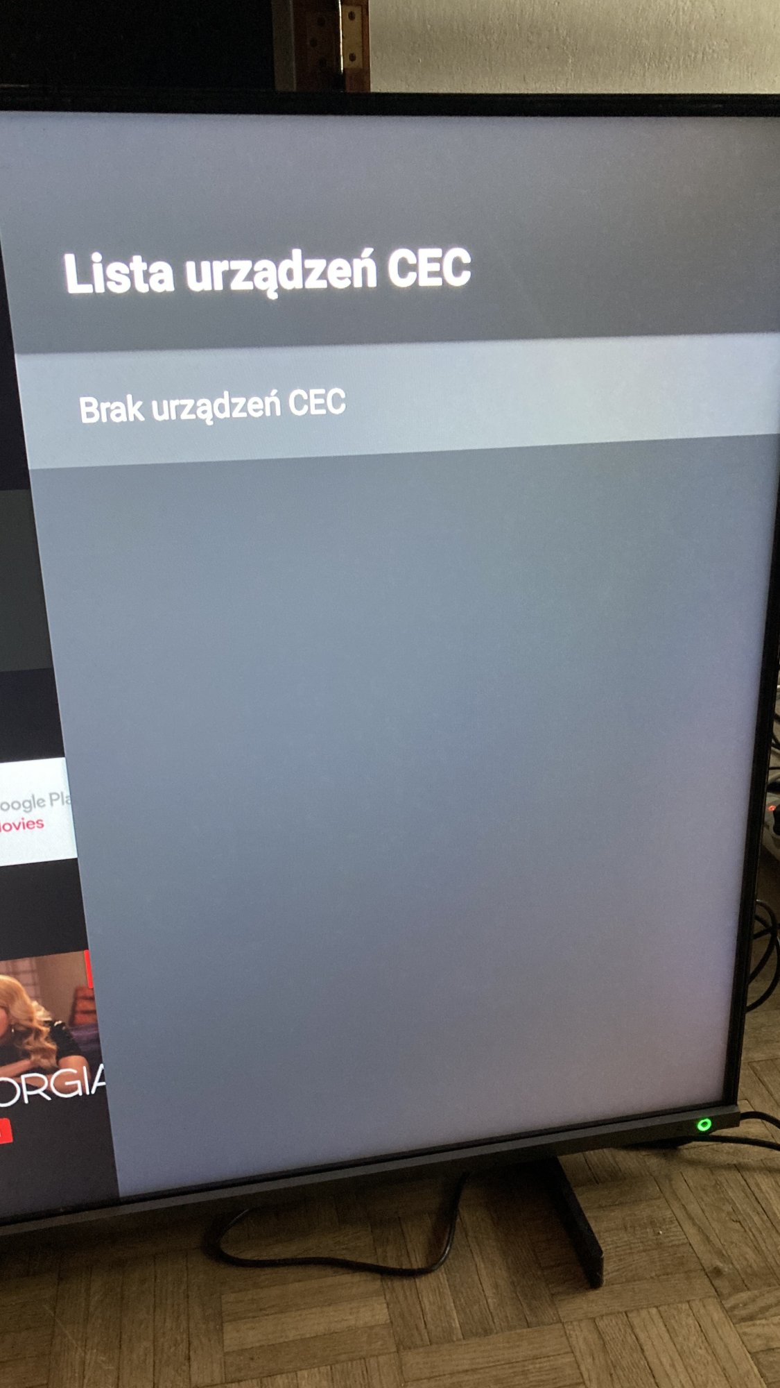

Dear All!

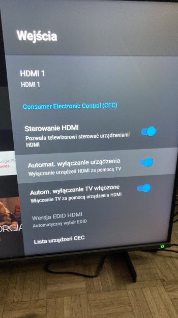

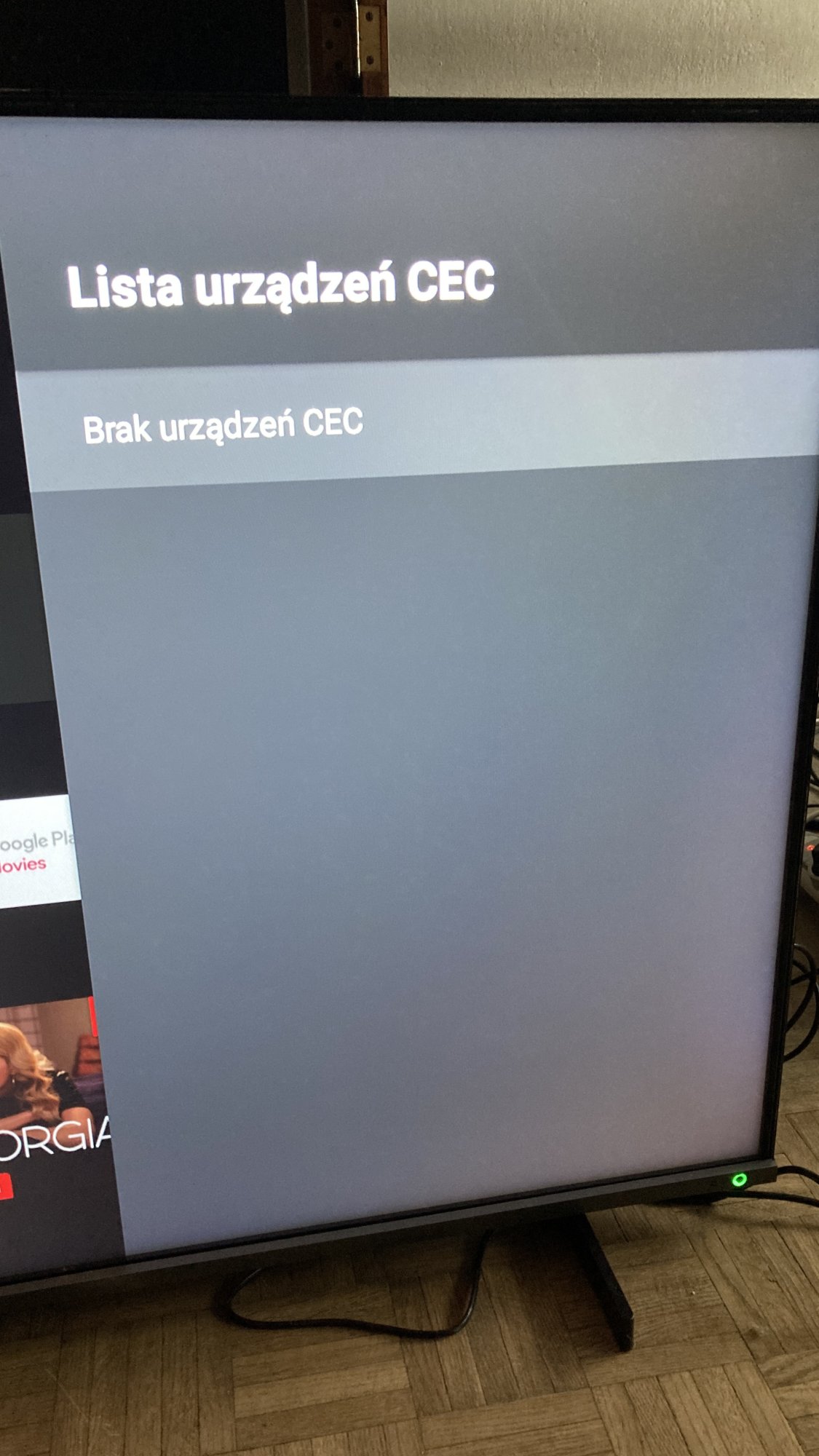

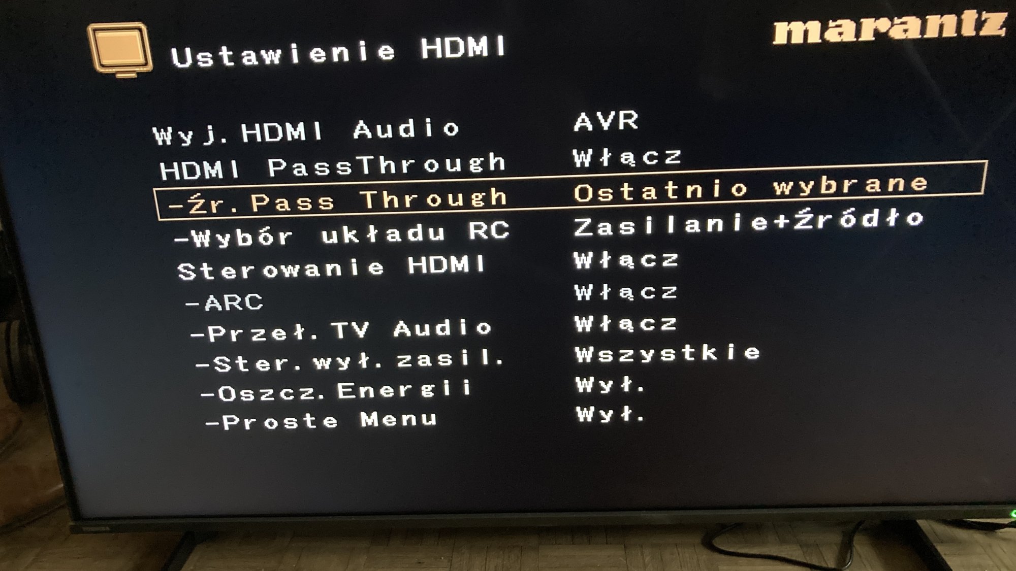

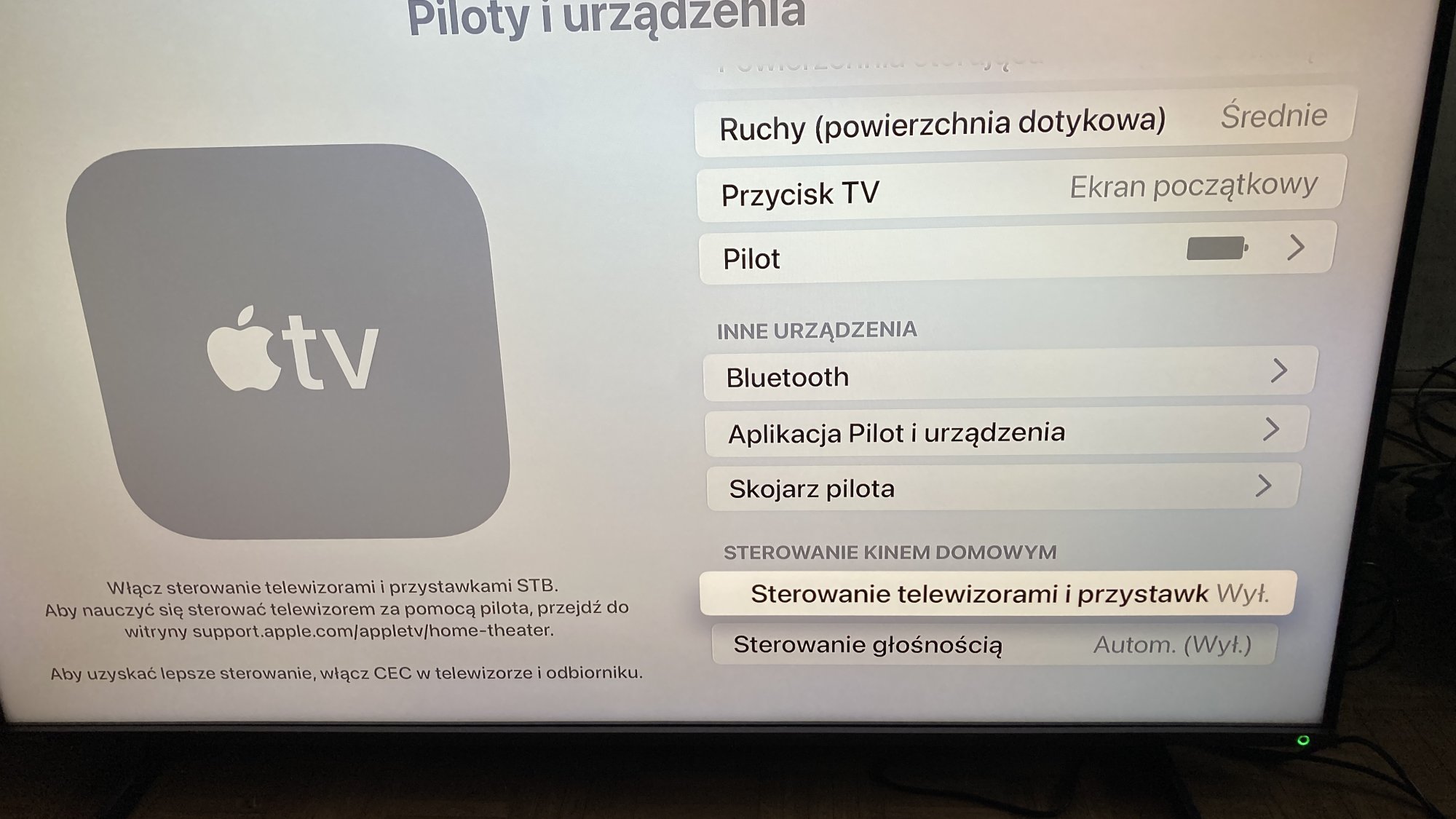

I have Marantz NR1510 AVR, to its input I have connected PS4 Pro, APPLE TV 4K (new pilot), output is Toshiba TV (adroid tv 11 based, 55QA5D63DG). To my surprise CEC (HDMI control and eArc) is not working. All Cables are certified ULTRA HIGH SPEED, HDMI 2.1.
When I connect ATV4K to TV directly I can turn on CEC on my Apple TV. When I plug my ATV directly to AVR (marantz) The CEC option in ATV is turnus off and greyed out.
All devices have CEC turned on.
I have tried to reset do factory settings my AVR and ATV4K. Nothing changed.
What is wrong?
Help!
I can use all devices, i have sound and video, however i can not use CEC for steering devices with one remote.

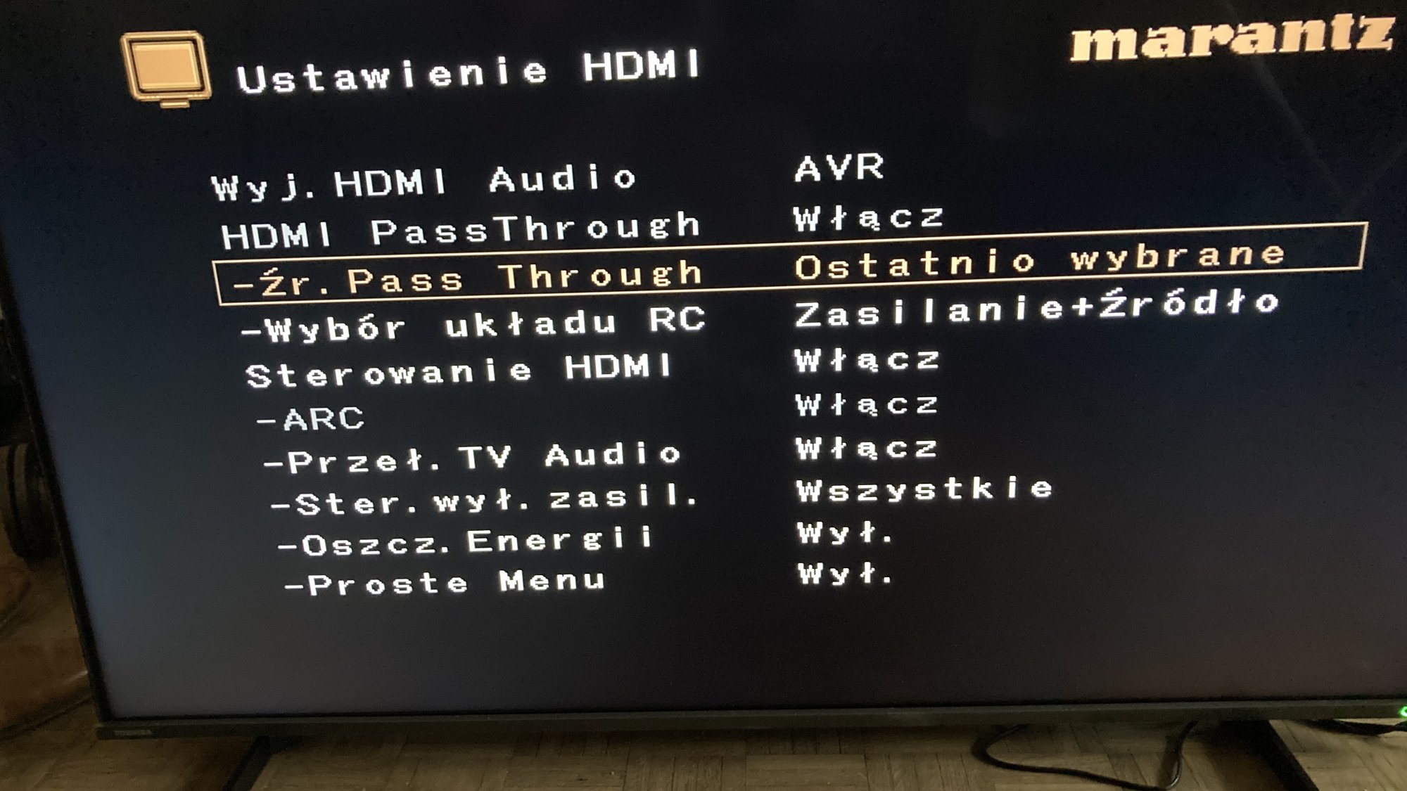

Hello,
I've got the same issue and plus very low output volume and it started just a few days ago (having worked just fine for 2 years) post Apple tvOS 16.3 update a few days ago. There's articles around 'Massive ARC Problems after tvOS 16.3', I haven't found the proper fix but found a workaround. I have a Denon and looking at the screenshots you provided they used the same software across all their brands.
On your receiver go to General > Information and Input Signal might show 'unknown'.
I've done all the tech support 101 stuff I’m an engineer thus can confidently say if the eARC / ARC signal contains no protocol your receiver/ TV won’t know what to do with the signal. (Switch to 16bit audio on the Apple TV to use an old protocol and your volume might increase but that’s not a fix it's what made me follow this).
On your receiver go to Video > HDMI Setup turn off HDMI Control I get my output volume back but lost my HDMI control.

Suddenly, when CEC is turned on, all devices, I get no sound through Marantz. Turning CEC off on all devices brings sound back. WTF?

I have borrowed first gen ATV4K, and it did not work either. However i plugged this one to front HDMI (AUX) and is working. TV still does not recognize CEC or ARC devices…
Even PS4 starts up the AVR, and turns off the AVR. TV does not work with AVR. Still No CEC devices found.
