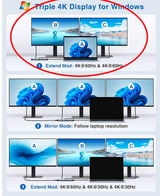

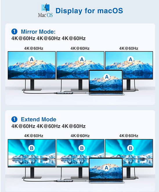

Just wanted to share in the hope no one else has to waste so much time. It turns out it's one display per port on the mac. Not like with windows where you can use a hub and connect multiple display to the hub. If you do this with a mac you will just end up with an extended display that is mirrored on the two external monitors. See image below. Some hub manufactures actually say this but, it's an Apple issue as far as can figure out. Not hub supports 2x extended display on mac.
Belkin said they know M3 doesn't work but M2 did?
Apple not a clue.

Welcome to the confusing world of display support on Macs!
The ports on Macs actually support two displays (depending on resolution), but you need a Thunderbolt dock to do that...not a USB-C hub. However, you can get two displays on a USB-C dock/hub if it supports DisplayLink. One of the displays would be a "virtual"/software-driven display, which can present some issues like artifacts in moving content, but it is generally fine for office type work.
Another thing different between Macs and Windows is that Macs don't support MST, which is the most common cause for a dock working fine with a PC but not a Mac (as in your example above).
If you're wanting to run two displays with a single cable, look for a Thunderbolt dock or a USB-C dock that uses DisplayLink (or one that specifically states it will work with Apple Silicon).
