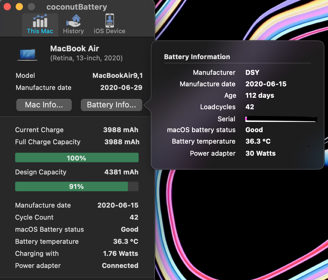

It's almost 4 months into my mba and Coconut battery indicates battery capacity at 91%, Is that normal.
But system information says it's at 100% wtf is goin on?
Do you have optimize battery charging enabled in system preferences? If so, that is why.

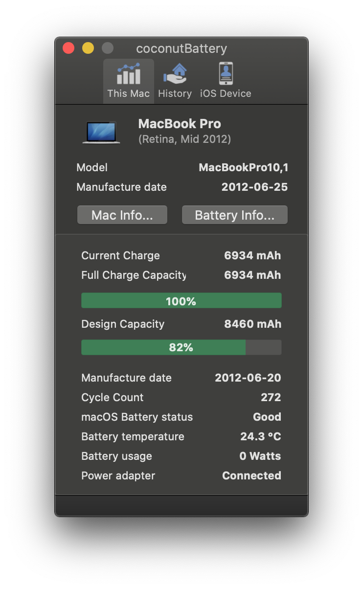

Threads like this make me wish I had kept coconutBattery installed so that I could see my history. I do not bother with following all the care guidelines that have been posted on these forums for many years. Sometimes my MacBooks live on the charger for months. Sometimes they get left behind in a cupboard for months or even a year.
This is the current battery state for my 2012 MBP
I am trying to remember what happened to the battery health in the first years for all of the MacBooks I had. I am pretty sure that initially they dropped to around 90% quite quickly, but I am not entirely sure how quickly. In my view the numbers mentioned above are somewhat concerning, considering the age of the machines. I reckon wait till around they are 10 months old and check then and if they are lower than 90%, then I would definitely be on the call to Apple support.

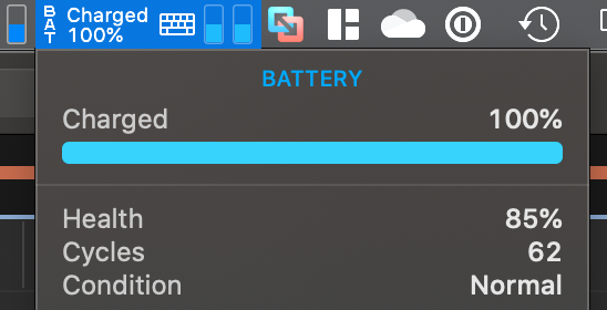

All my Macs have been >95% for the first couple of years prior to this. I'm now on 88% with 62 charges.
Same sort of usage patterns...

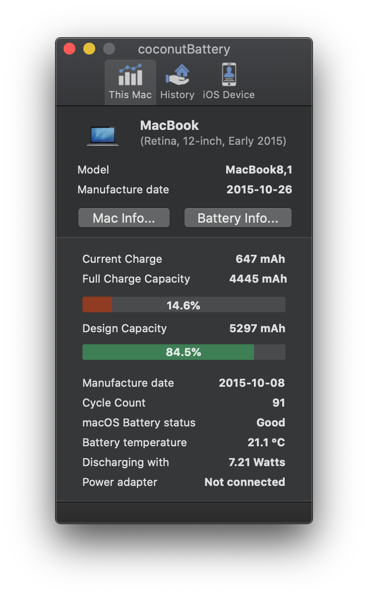

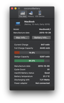

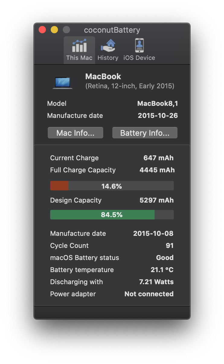

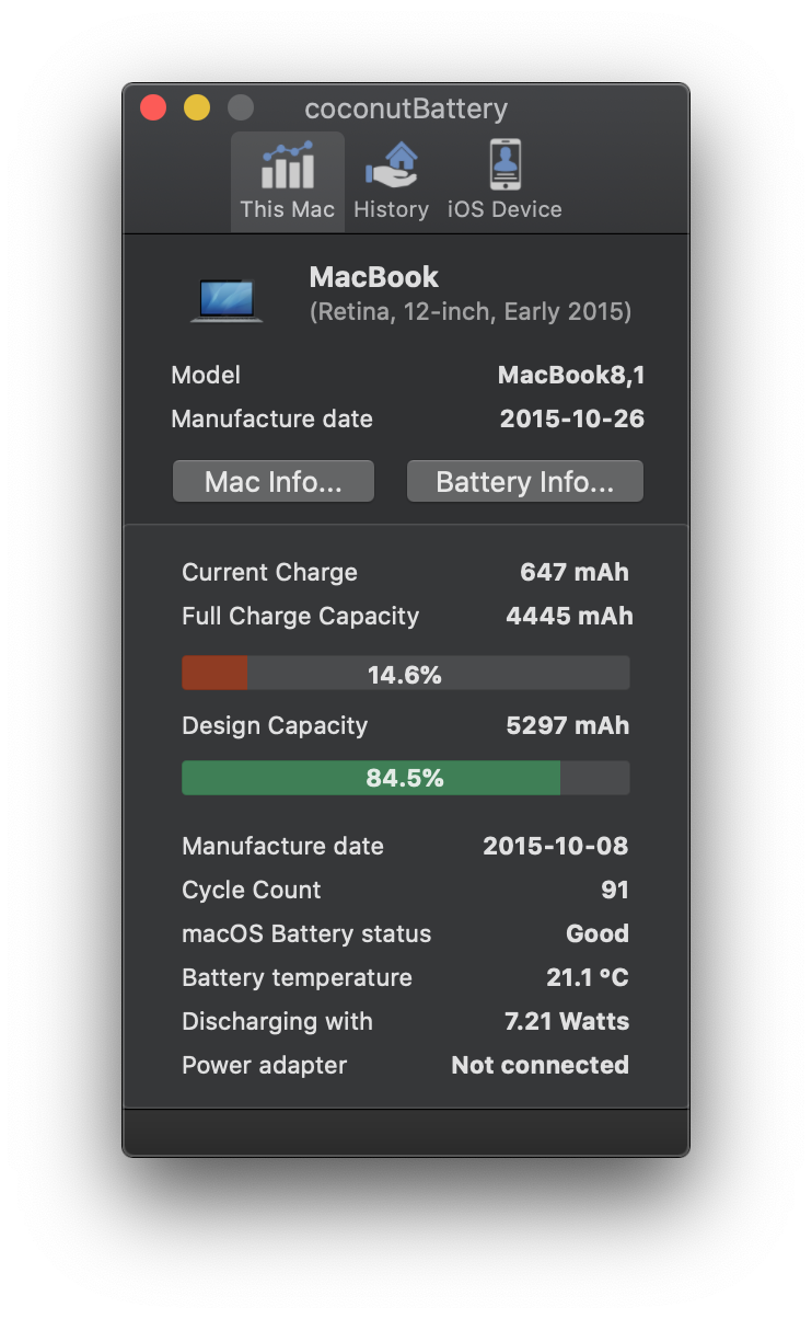

That does look abnormal. In comparison this is my 5 year old Macbook (not Air) at 84.5%

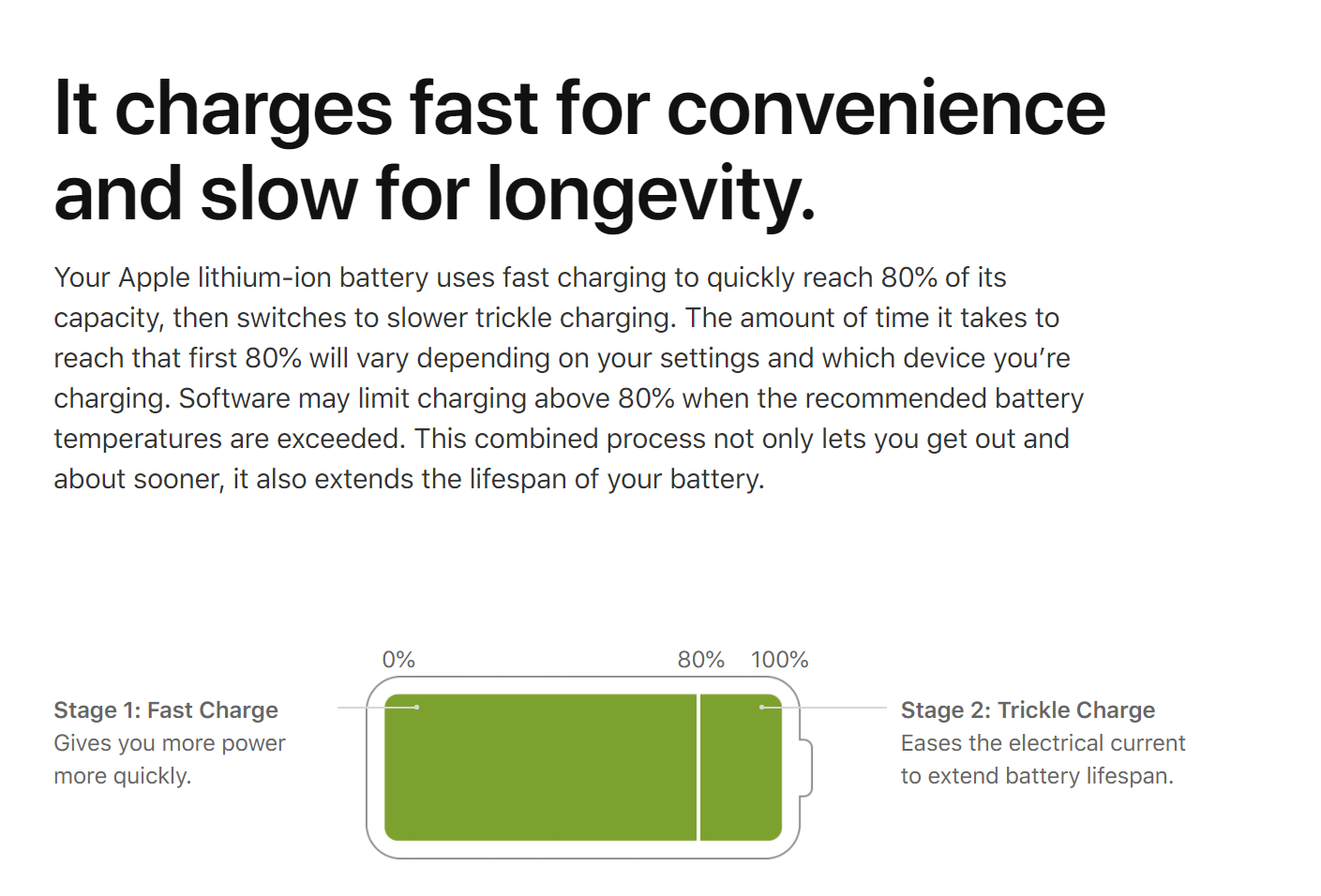

Oh, I see what you mean. No, I don't believe it does, but you could check it yourself. Get coconutBattery (it's free) or go into about this mac and then system report. In the power section you will see your total capacity in mAh. Take note of that number and then switch off battery health management. Probably best to restart. Then go back to check the total capacity again. I suspect that it does not modify this number and instead it does indeed only charge around 80% quickly, then slowly or not at all, depending on what it learns about your use. For example my iPhone now knows that it must finish charging by 6:30 AM every day.
This is mentioned here
Yeah, I've read the docs, but apple haven't been forthcoming about what it does to that number. I might try turning it off for a while and reboot, etc.

No need for coconut battery, iStat does it, as does the system report, its a simple case of current max capacity vs. design capacity figures.

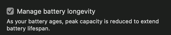

Guys, just think about what Battery Health Management does or read what the text in this menu says:
The battery is being cared of by not charging to its maximum. Sure, it charges to 100%, but 100% in this case means less per cent of your max capacity. In the long term this is more gentle for the batteries.

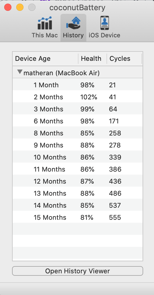

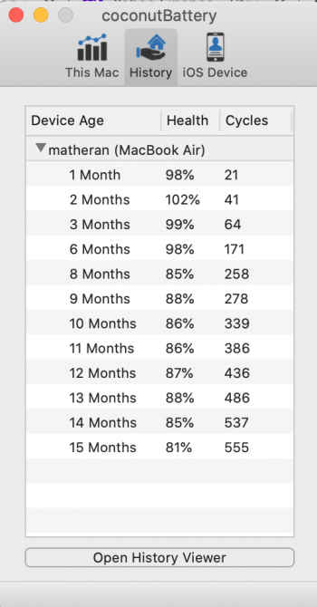

It can remain steady for long periods, e.g. mine is showing 85%-88% between 258 and 537 cycles!
I am planning to get the new MBA as soon as I get some time off work. Battery life on this one now gets me about 5-6 hours, less if on conf calls.
