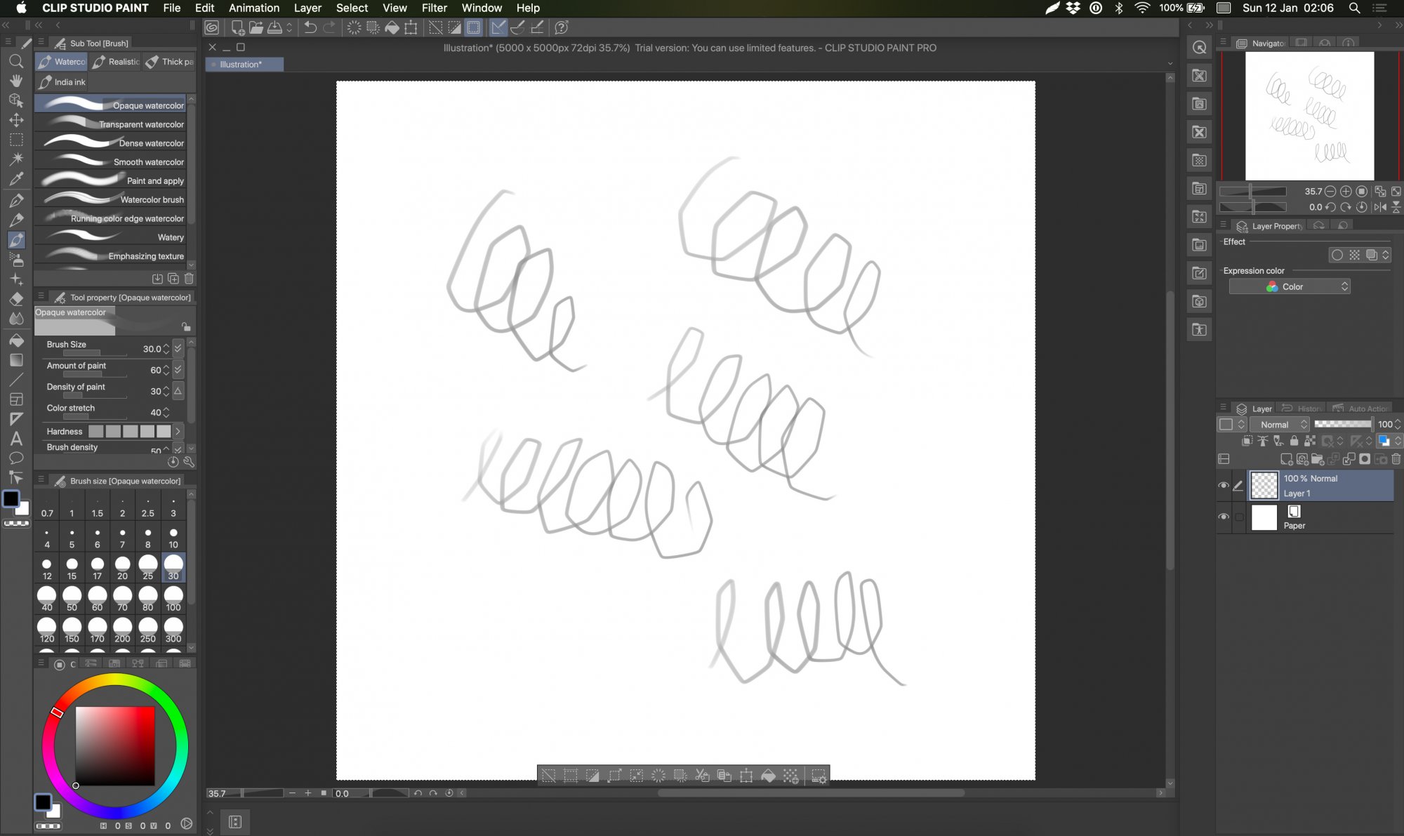

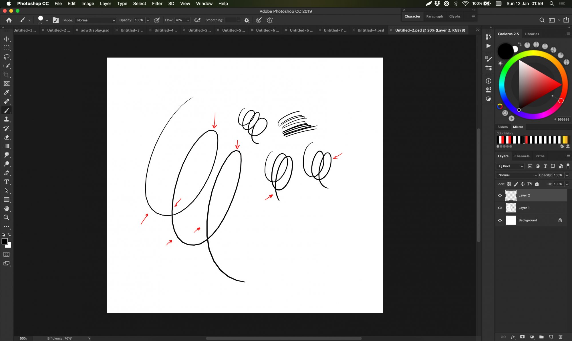

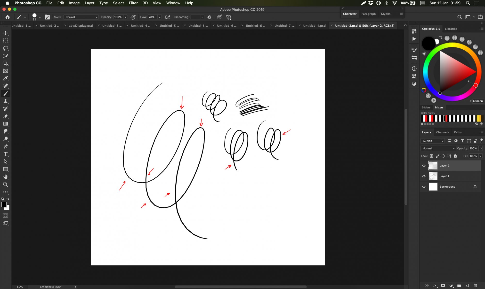

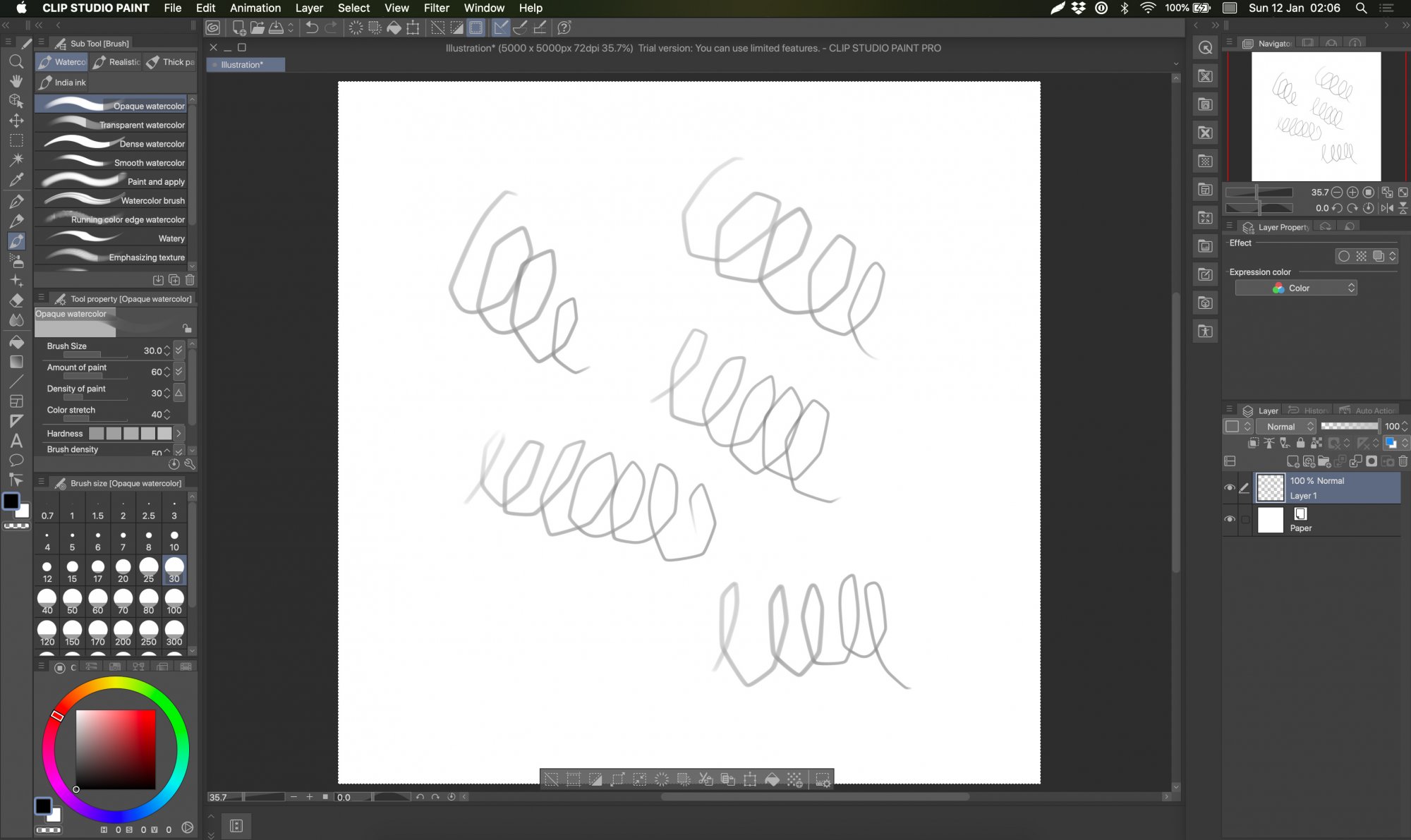

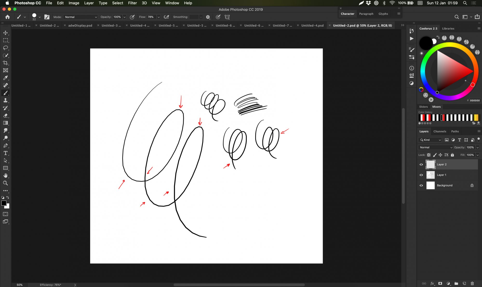

To my surprise, when I launched my Cintiq Pro 16 (external display tablet) with photoshop and immediately the cursor started kinda "skipping frames". I have some videos to show what is happening.

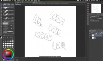

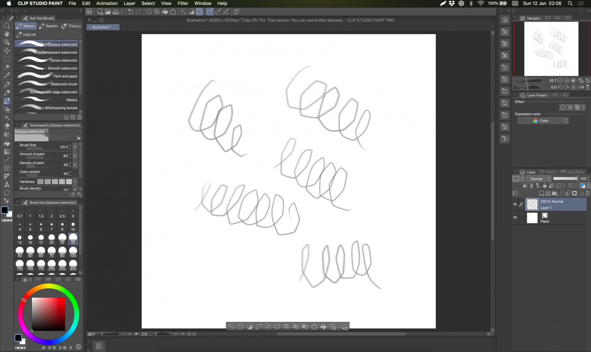

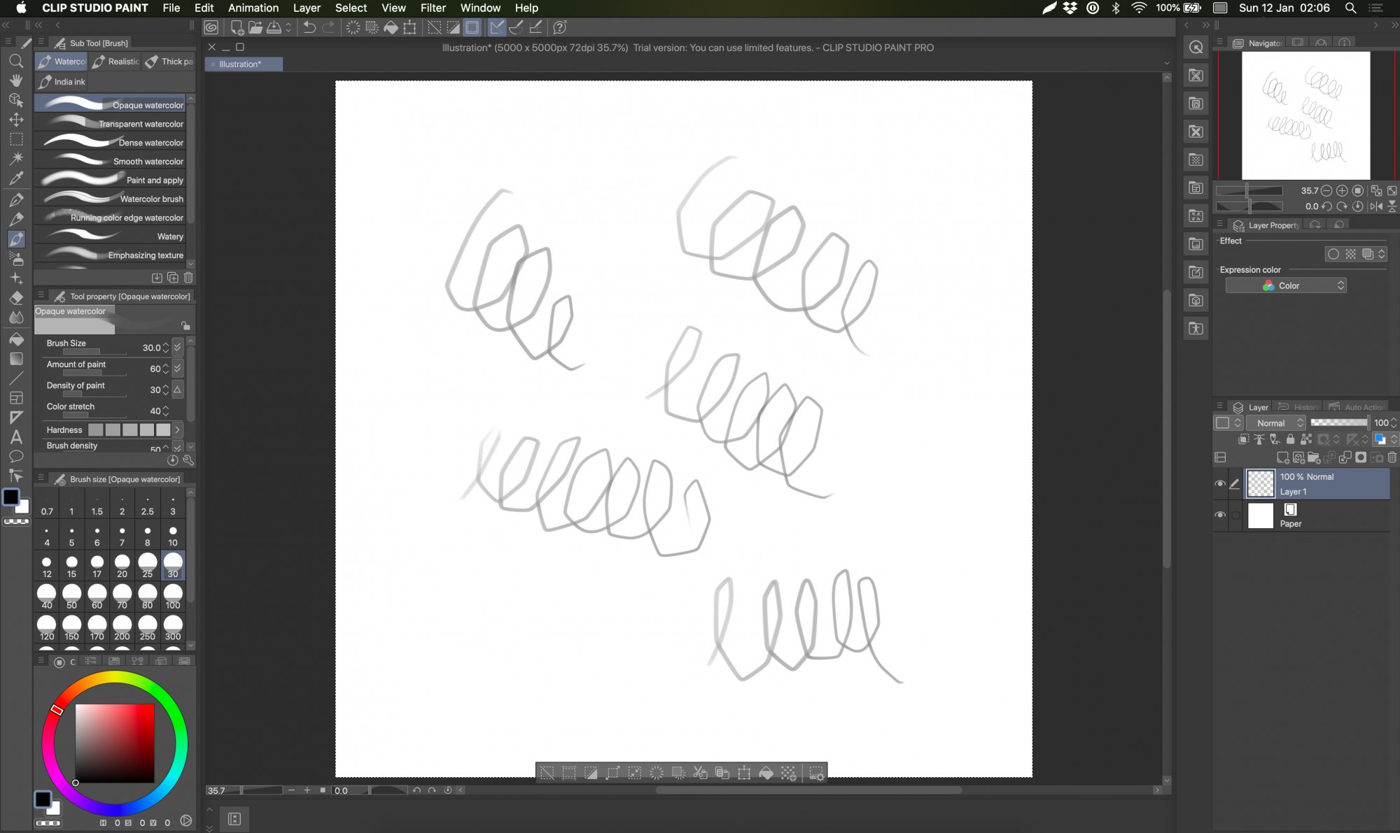

On clip studio paint the "skipping frame" was even more severe. The paint stroke would literally be all full of corners.
And the longer I use, the worst it gets.

added some screenshots of tests with photoshop and csp.

Alright, I ran some test. And it's def not wacom/adobe fault.
I launched an apple arcade game for about 15 min. Enough to hear the fans become jet engines. Then I closed it and the cursor was super jittery.Way more than with wacom/adobe apps test.
Could this be a hardware issue?
Also... Is there any other way to test this?
I'm gonna try to factory reset this. Hopefuly its just a sofware bug and it will be ok when I reinstall.
When I plugged my Cintiq in I noticed that I was running at 30fps. Really felt strange. I switched to another USB-C to Displayport adapter and the jitter went away. It's probably not a framerate issue but check the graphics setup in About my Mac just to be sure.
I checked, but this issue was happening with my old intuos as well... So its not a refresh rate/display issue.
And from my latest test, its not even directly related to my wacom.

Btw, I tested with a normal 2nd monitor (no 4k or cintiq) and the issue happened instantly. Out of photoshop or csp as well.
Attached some screen shots showing the jagged brush strokes.
