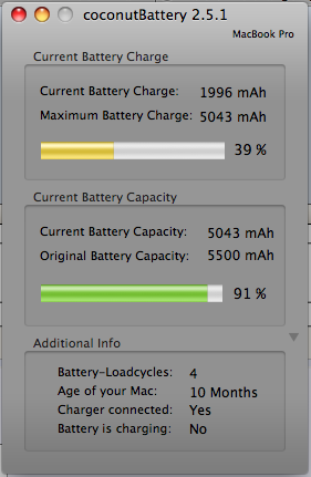

My System Profiler indicates 117 Cycle Count
Coconut Battery indicates 4 Cycle Count
Furthermore, my Battery Life is up to 91% now...this program would seem to be worthless on 10.5.1?!
edit: coconutBattery thinks I am plugged-in when I am no where near the power and visaversa?
