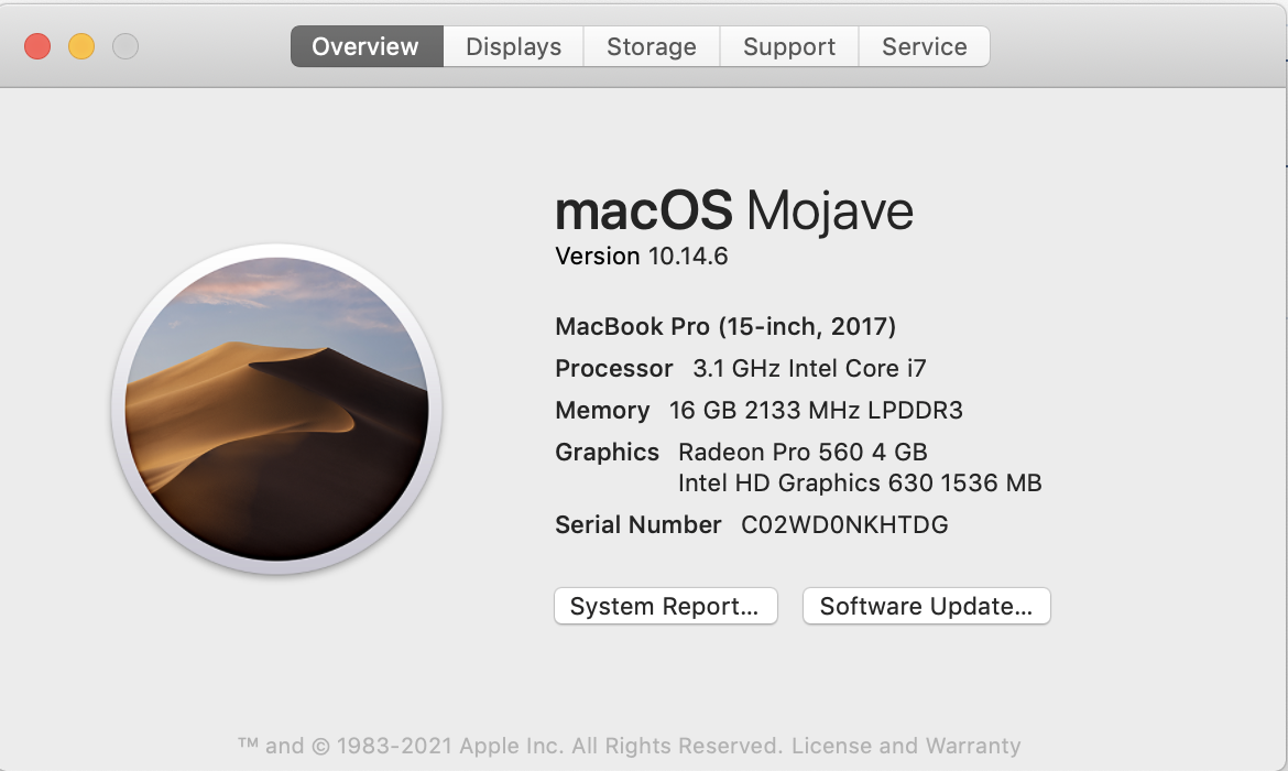

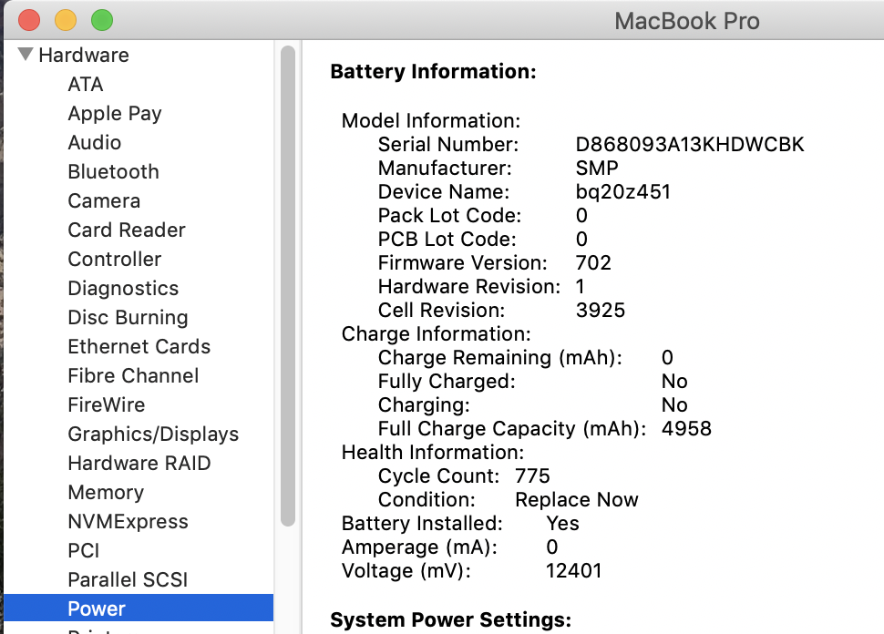

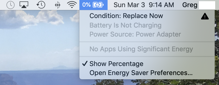

I have a 2017 i7 15" MBP that has typically worked fine, however now the battery apparently ran dry and now will not charge. This machine isn't used daily and sometimes sits for a week, maybe more, without getting turned on so I never detected that this problem was occurring until yesterday, it's working ok plugged in (I'm typing on it now) but the battery apparently refuses to charge. Pleading with the community for any advice on how I can force it to charge, thanks!
Reset the SMC. If that doesn't work, the battery has died and needs to be replaced.

Yes I've tried that with no success, since there's no confirmation that's actually ever done I'll try it a couple more times before I throw in the towel, thanks!

Batteries in general need to be cycled regularly to keep the volatile chemicals active. Have you checked About This Mac --> System Report --> Power to confirm how many cycles are on the battery? That model is rated for around 1000 cycles.
Good call, thanks for that info!
This one shows 775 cycles which certainly seems like a lot! This MBP was used; bought from Mac-of-all-Trades in 2021 exclusively for music gig use and was actually a replacement for one that had been stolen.
